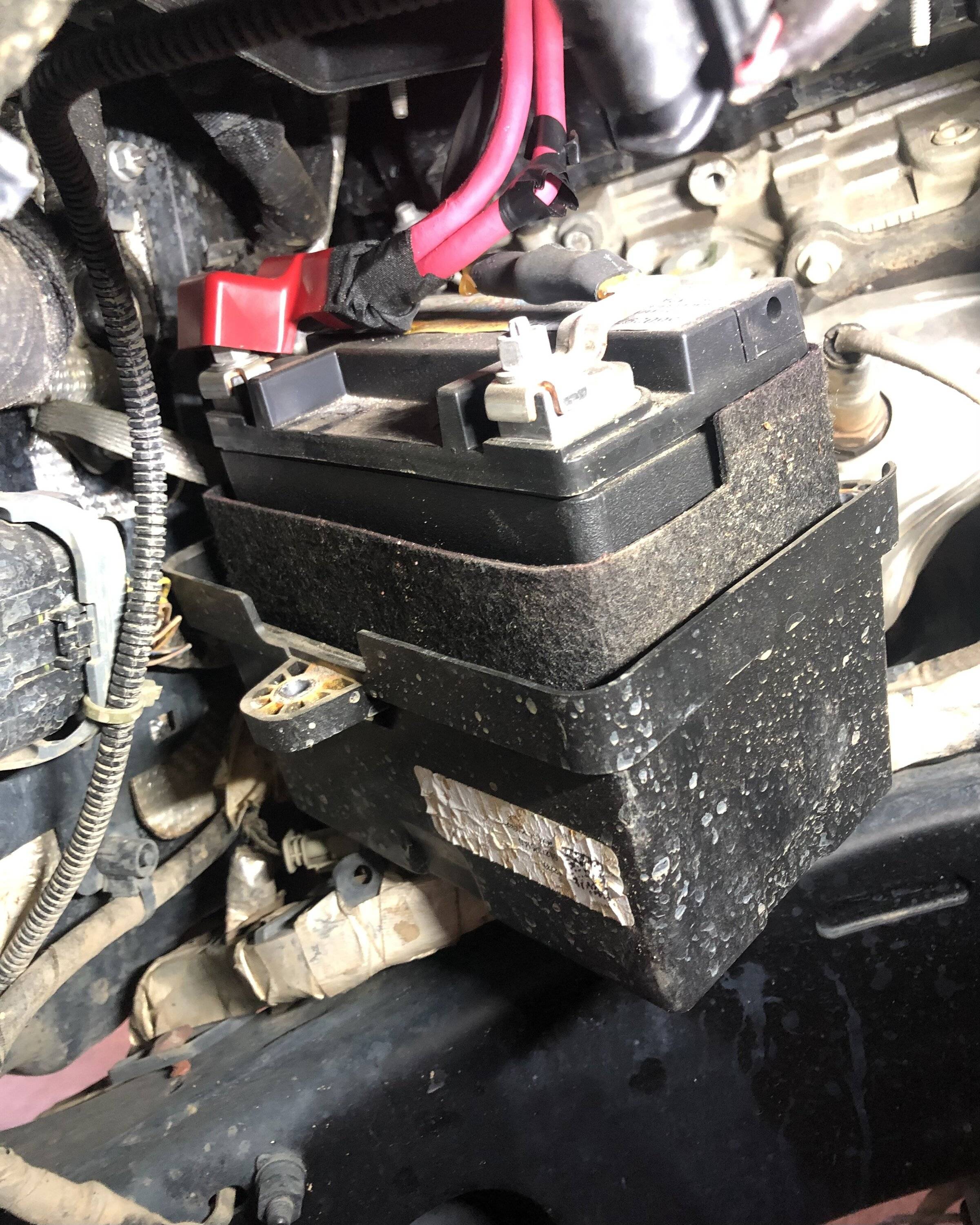

you don't have to remove the Aux, just do the "jumperless Aux battery bypass."
you pull fuse 42 and remove the Aux negative cable (tape away out of trouble). Your Aux is now out of the loop and will use the main battery only.
https://www.jlwranglerforums.com/forum/threads/jumperless-aux-battery-bypass.95945/
And your dealer is wrong to tell you you don't drive enough. Jeep just designed a dual battery system with inadequate system control and charging conditions. Driving a lot of miles, and often, probably prevents it because there's enough charging time to make up for their design inadequacy. But your driving is not the issue. Their design is the issue.
Yeah, I had a bunch of big ideas, leave it in and bypass it, or wire it so I could use it as a back up, or was thinking I’d run some different thinks off of it like when camping, yeah, so, none of that happened….I just yanked it out and am using 1 battery as God intended…… ?
I just disconnected the cable, the little thing is still hidden down in there somewhere. This has worked fine for over 2 years.
Yeah, the bypass works great, I just wanted it out of there, lol, I’m still trying to figure out what I could use the cubby for, lol…I have gutted fenders and aftermarket inners, so it only took me 2 minutes to get it out ……:)
would that aux battery box fit the ARB air tank? Not the compressor, just the aluminum air tank?
Roky
Roky
Oct 4, 2018
10,716
29,491
I’m not sure, I’ll have to measure how much room is in there…. Not sure how big the tank is you’re talking about…… iirc the cubby is not much bigger than the battery….
