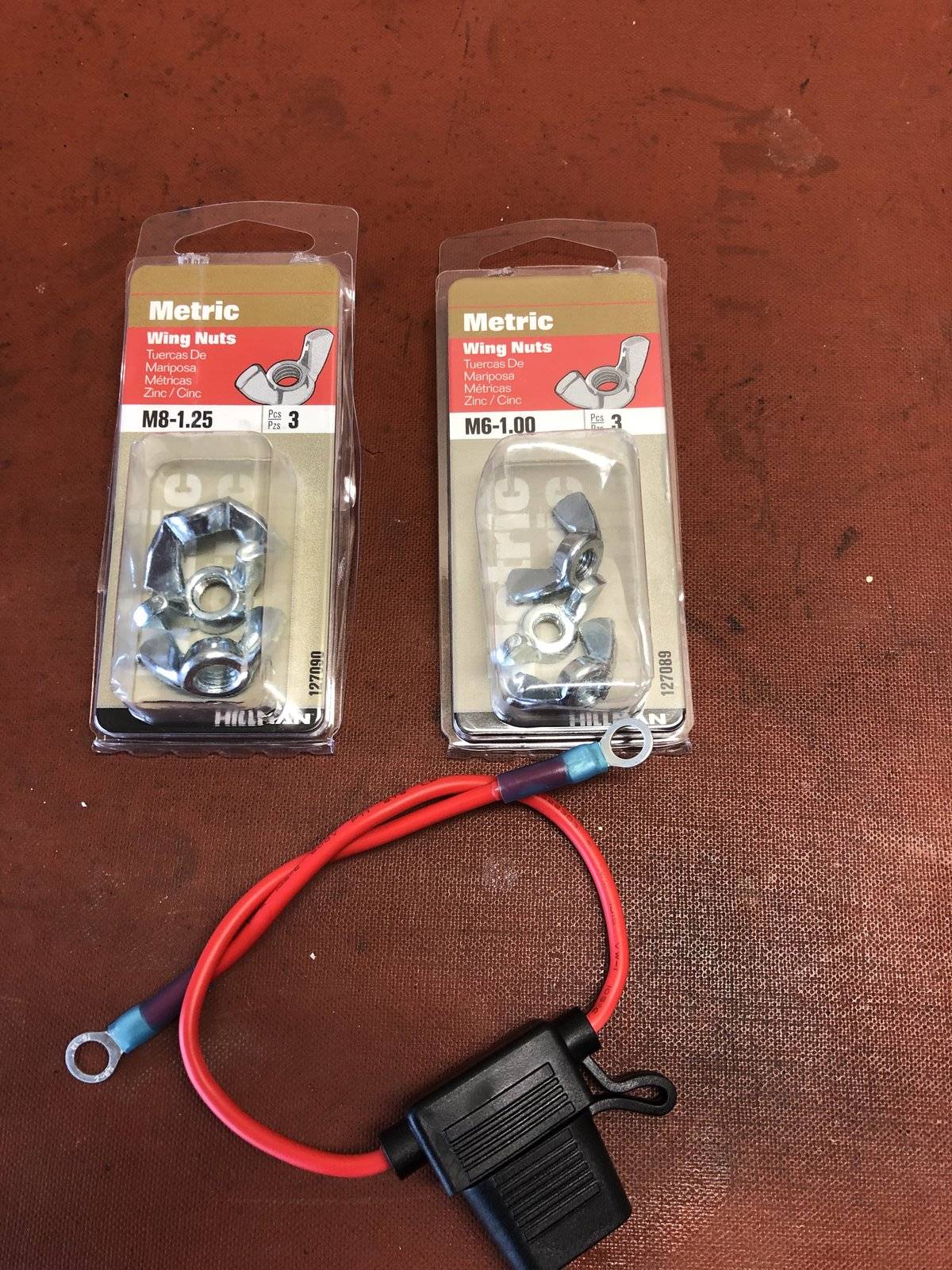

The jumper less bypass method, involving Fuse F42 and disconnecting the Auxiliary batteries negative was first spoken about in June of 2022.
If someone says they have been running with Aux bypassed before 6/22 then they were using a fused bypass jumper prior to 6/22.
If an owner was bypassing the Aux battery before June of 2022, they would have been using a fused bypass jumper and had disconnected the Auxiliary batteries, Neg.
I myself, have been running fused bypass jumper and a disconnected Auxiliary batteries, negative since early 2019. I have 60,000+ miles running with just the Aux.

You should be able to use either method.
Guys/gals here regardless of model year and or if they had the TSB done on their early in model year 2018 built JL have reported using both methods.
Try the jumper less method. No harm trying. You can't screw anything up, lets say.. If that does not do the deed just spend the $8-9 and go with the N1 - N2 fused (40 amp) bypass jumper.
Agreed, but I don't think that the TSB (i.e. TSB 18-092-19) is even relevant here. This software patch, at least as it relates to the functionality of dual AGM battery JLs, and built into all of them barring some of the early 2018s (which expressly need it dealer downloaded) deals (in part) with how the vehicle handles a dead *factory wired* Aux battery.
(*factory wired: neither the jumper of this thread installed, nor Fuse 42 pulled)
As I understand it, dual AGM battery JLs isolate the Aux battery for an instant at cold crank to test it. Otherwise, the batteries are always in parallel except for ESS events.
If at this point in the cold crank, if the Aux battery is dead, so too is your early model dual AGM battery JL. But with the TSB, subsequent user attempts to cold crank will be done by the vehicle solely off the main battery. If successful, the Aux battery is bypassed and the "ESS off" light is illuminated in the EVIC until the next cold crank (if any) where a factory wired and energized ESS battery is detected, or the vehicle thinks this the case with the jumper or Fuse 42 solution.
When the jumpering approach is taken the batteries are hard wired in parallel at all times. So the pre-crank test of the Aux battery really becomes a test of both batteries together.
And in the Fuse 42 pulled approach, the same prevention of isolation of the ESS battery effect happens, but for different reasons: namely because a relay that separates the batteries is disabled rather than in the jumper approached where the jumper's short circuit physically prevents such isolation.
Same effect, different means.
I'd also agree that there's little harm in trying either approach but think it a good idea to turn ESS off. With either the jumper of Fuse 42 pull, no longer will your main battery be isolated in ESS events to preserve its power for post ESS event engine cranking.
You'll probably be fine: many vehicles run one battery ESS systems. I'd just hate someone to get stranded in the left hand turn lane during a JL one battery ESS event, if you catch my drift.
All this said, I think, if your running TSB 18-092-19, that both the jumper and Fuse 42 approach are best if you hate EVIC notices. If not, pull the black cable from the Aux battery's negative terminal that leads to the main battery's negative and electric tape up its loose end. (Two factory cables tie into the main battery's negative terminal. Leave alone the one whose other end attaches to the body ground on the passenger's side front quarter panel.)
Try to crank. Fail. Try again. If your main battery has power the vehicle will turn ESS off for you--you never have to remember of buy tech to do it. All subsequent cold cranks will happen successfully on the first attempt, against only the main battery, as long as your main battery has juice. As mentioned prior, only reconnection of an energized ESS battery, on the next cold crank will revert back to factory behavior.
But you will have that EVIC notice that jumpering or Fuse 42 pulling will avoid, much as these latter two approaches will make turning ESS off up to you.
I think it's personal preference rather than an one way best situation.
