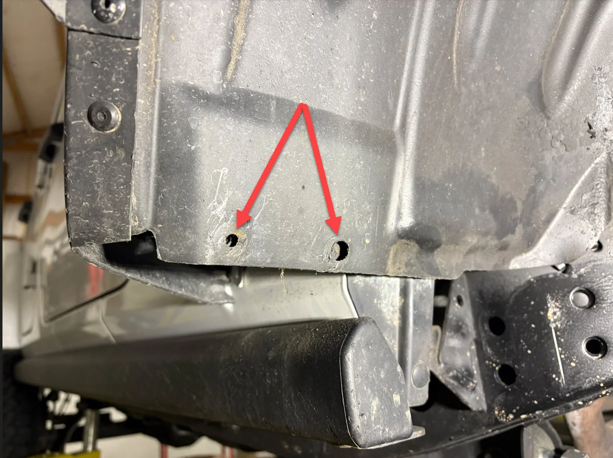

Deleted mine a couple of months ago by going up through the fender liner, definitely easier than coming from the top via the fuse box!
These were the only two "rivets" that I removed. On my '24 these were both simple "christmas tree" style push pins:

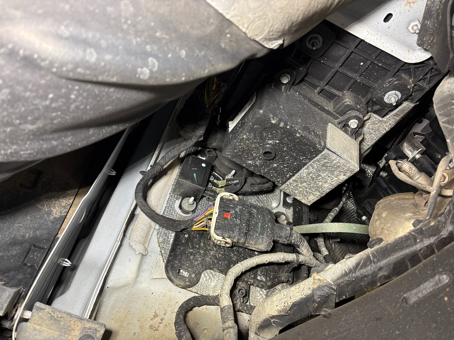

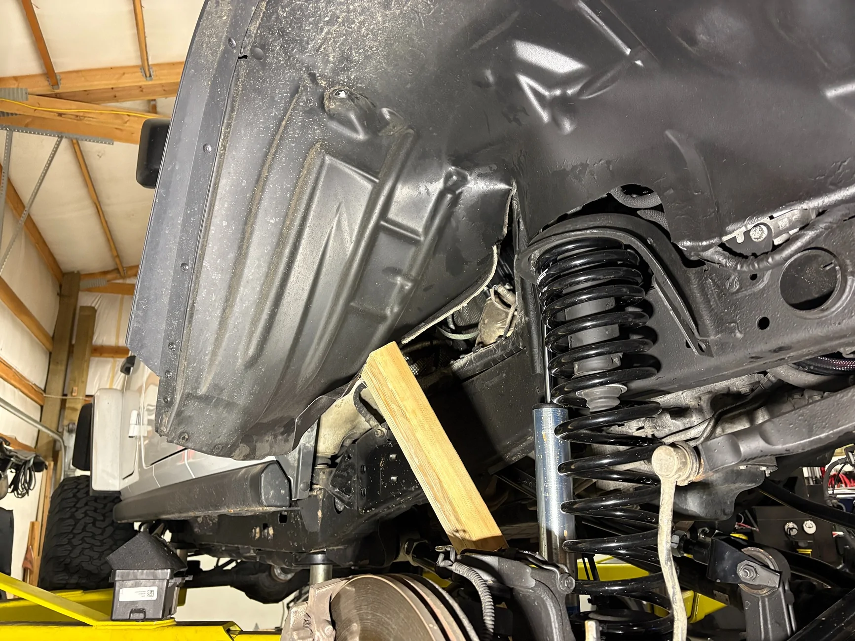

Once these were out I was able to pull the fender liner away from the body and prop it up with a 2x4 to gain access to the aux battery box:
Jeep Wrangler JL AUX battery delete/bypass - Which method is proper? IMG_2363
Jeep Wrangler JL AUX battery delete/bypass - Which method is proper? IMG_2357
Did you just reuse the old rivets, or did you install new ones?
