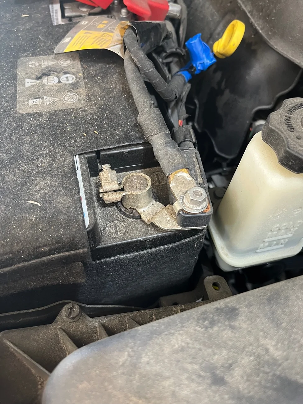

So... I just finished the battery bypass.
Removing F42... easy-peasy
Disconnecting the auxiliary battery negative terminal from the main.... easy right up to the point where I separated the terminal from other negative terminal and got sparks between the two. I knew not to let either negative cable get anywhere near the positive terminal on the battery, but I wasn't expecting an arc between the two negatives. That scared the shit out of me thinking I had somehow just fried the electrical system.
Got the auxiliary battery negative terminal end swaddled in electrical tape and zip tied to keep it from bouncing around., reinstalled the other cable on the 10mm post on the main battery and the Jeep started just fine.

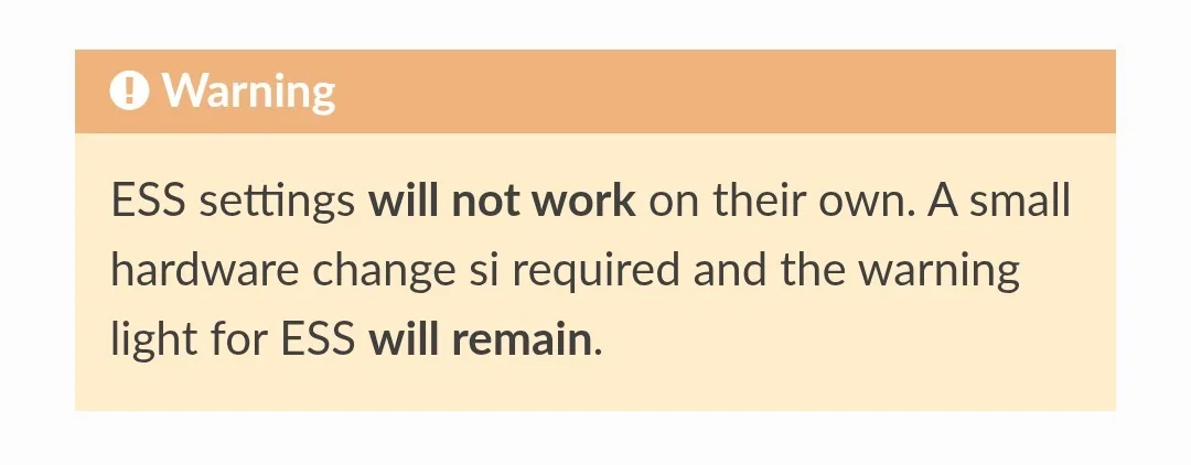

Did you remove one of the hood switches from it's bracket so it can stay in the open position, as instructed by the JScan docs? That's what actually disables ESS in the PCM and causes the @! dash light; JScan just prevents the BCM from tripping a bunch of warnings due to the open switch by setting its "hood sensor present" to inactive.
Jeep Wrangler JL AUX battery delete/bypass - Which method is proper? 1000006120
If you changed the ESS settings in JScan without the hardware change, ESS is disabled for some other reason (e.g. IBS SOC below 65%). [Or, possibly, Euro differences.]
I'm absolutely sure that 3 years ago, when I turned off the ESS, everything worked perfectly (including the charged battery). It probably depends on the differences between Europe and the US.
