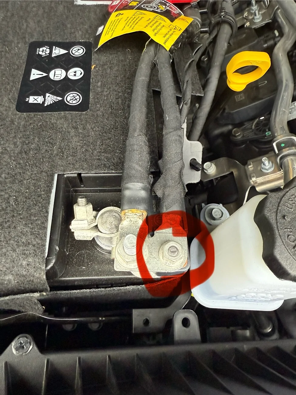

Am I correct that the negative cable from the aux battery is the only circled in red on the photo below?
I undid that one then used a tester to test continuity from the end at the Aux battery to make sure it was the right one. It was the right cable to disconnect for a 2019. Better safe than sorry.
From a ton of posts I read, it appears that the position of that cable could be on the either side, so my understanding is that it should always be the thinner of the two cables (the thicker is the main battery ground)...
