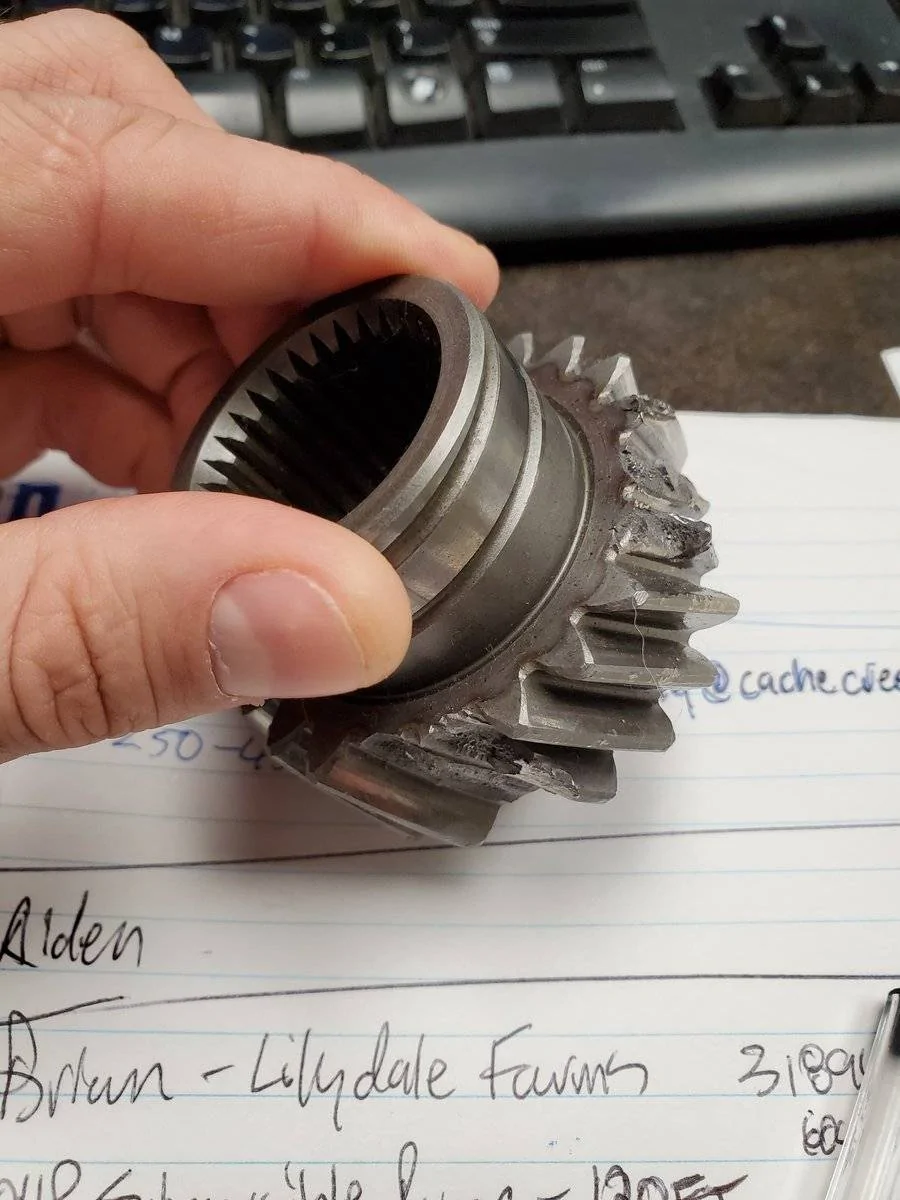

The TJ has factory rubicon lockers, it's a sport that had a 30/35 combo but I swapped 44s in years ago. So far I've been quite lucky with them but always keep the rear locked offroad to help encourage the lsd not to have an issue. The plan is to replace them with arb's or eaton's if/when they fail.
FYI- It's been my experience that the TJ Rubi rear locker is MORE susceptible to failure locked than unlocked. The helical gears are very small and, when locked, they don't move so all of the torque goes thru the VERY small contact area.
I'm not dismissing your observations but I've heard the opposite. The consensus on the tjforum is that the lsd is prone to failure. Here is a photo I stole from another forum.
