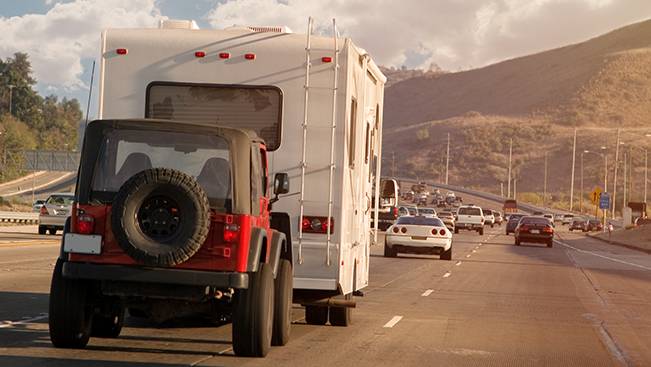

Can you explain to me what is meant by FLAT TOW

Flat tow.
Jeep Wrangler JL Atlas JL Transfer Case Flattow
Gearing down to 4.33:1 is awesome. Any lower and it starts to get unusuable unless you like going nowhere fast. The 8 speed with a 3.8:1 sounds fantastic for all around usability.

Regarding FLAT TOW, Thanks for the illustration
I understand they created a complete neutral to tow the jeep
I'm looking for a crawl mode like they did in JK
At first, they talked about a 1: 1, 3.8: 1, and 10: 1 transfer ratio.
