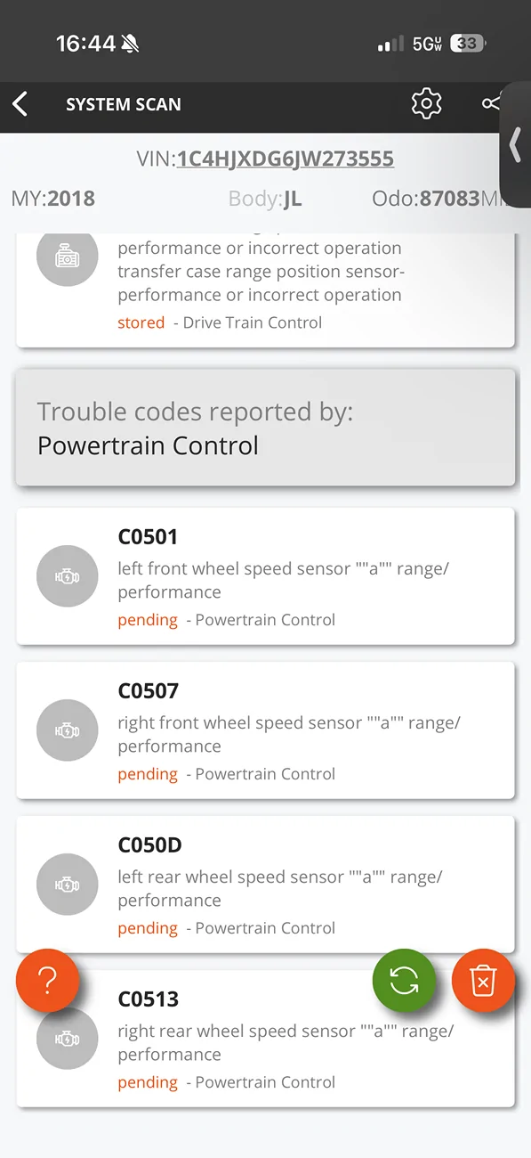

I appreciate that feedback and that’s really good to know. I am just using the accessory switch and wire connection like you’re describing. They are stock 392 axles and lockers but aftermarket switch and wire connectors.
You’re also right about the speed sensors. I ran my Jscan when I got out of work and found this (below). So I’m doing an oil change and tire rotation this weekend….plan is to pull each wheel speed sensor and clean it really well…see if that fixes it.
Oddly enough, I put the Jeep in 4low and let it sit for the day in that position while I was at work. Came out and put it back into 2wd and the light hasn’t popped back on.
