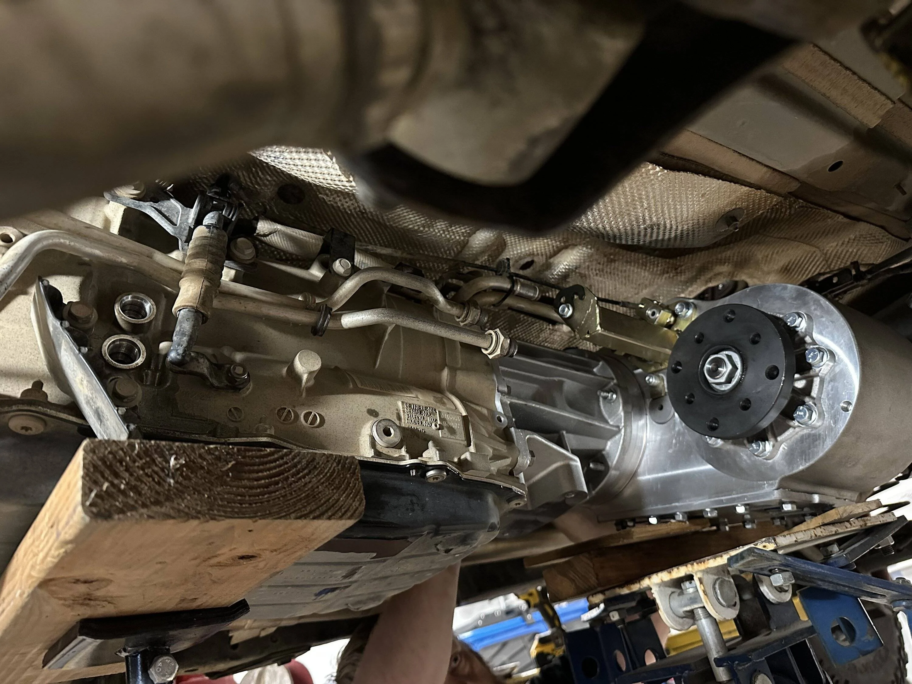

Advance sent a longer input shaft that my buddy swapped into the Atlas. Today we installed it and ran into a few more issues. The transmission heater on the diesel is completely in the way. It totally interferes with the shifters. And would likely also be too close to the front driveline. (Side note, the Atlas front output is 1” closer to the center of the transmission than the factory case). If you wanted to keep your transmission heat exchanger, you would have to modify the Atlas shifter bracket. And may have other issues, who knows.

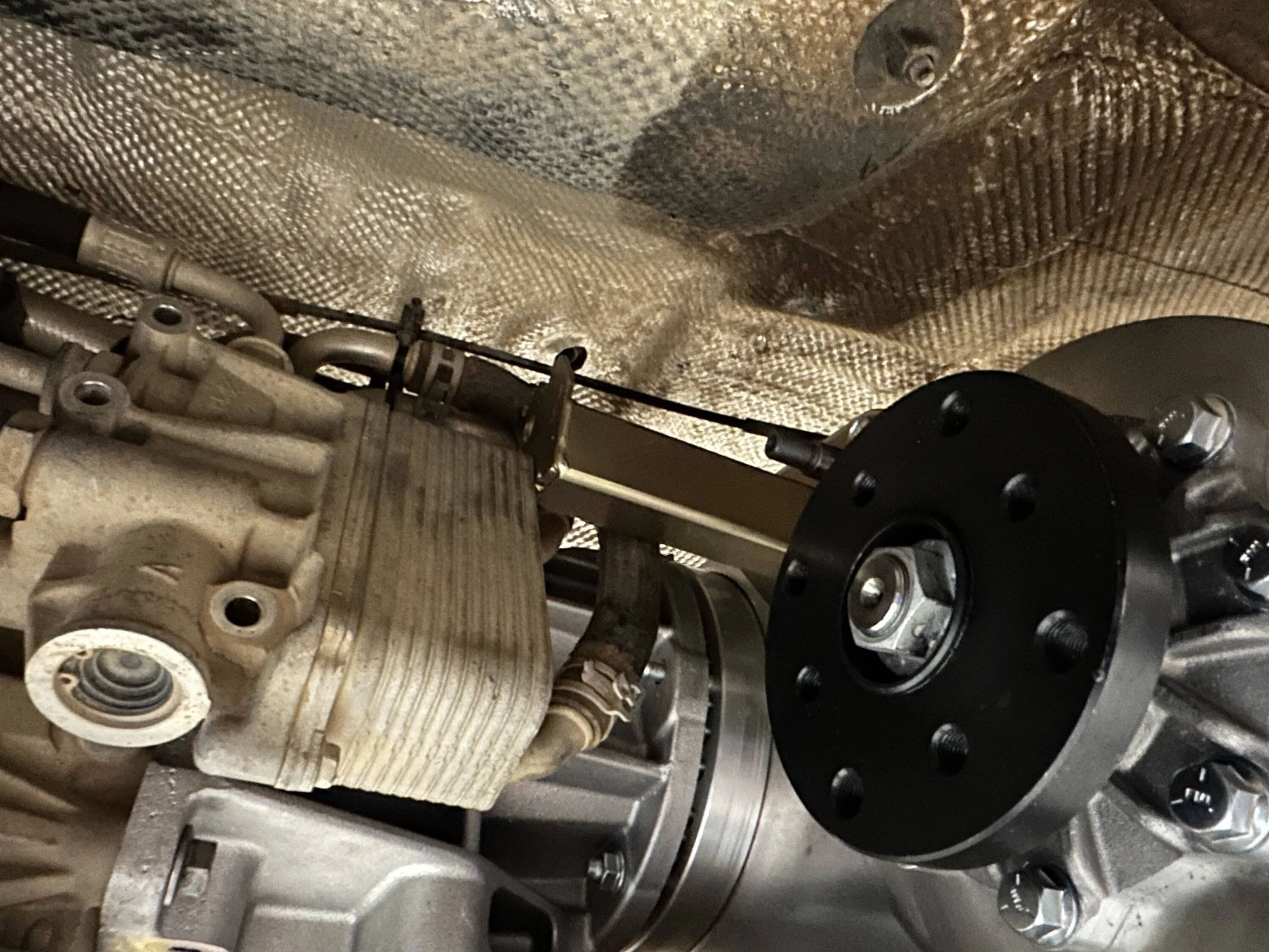

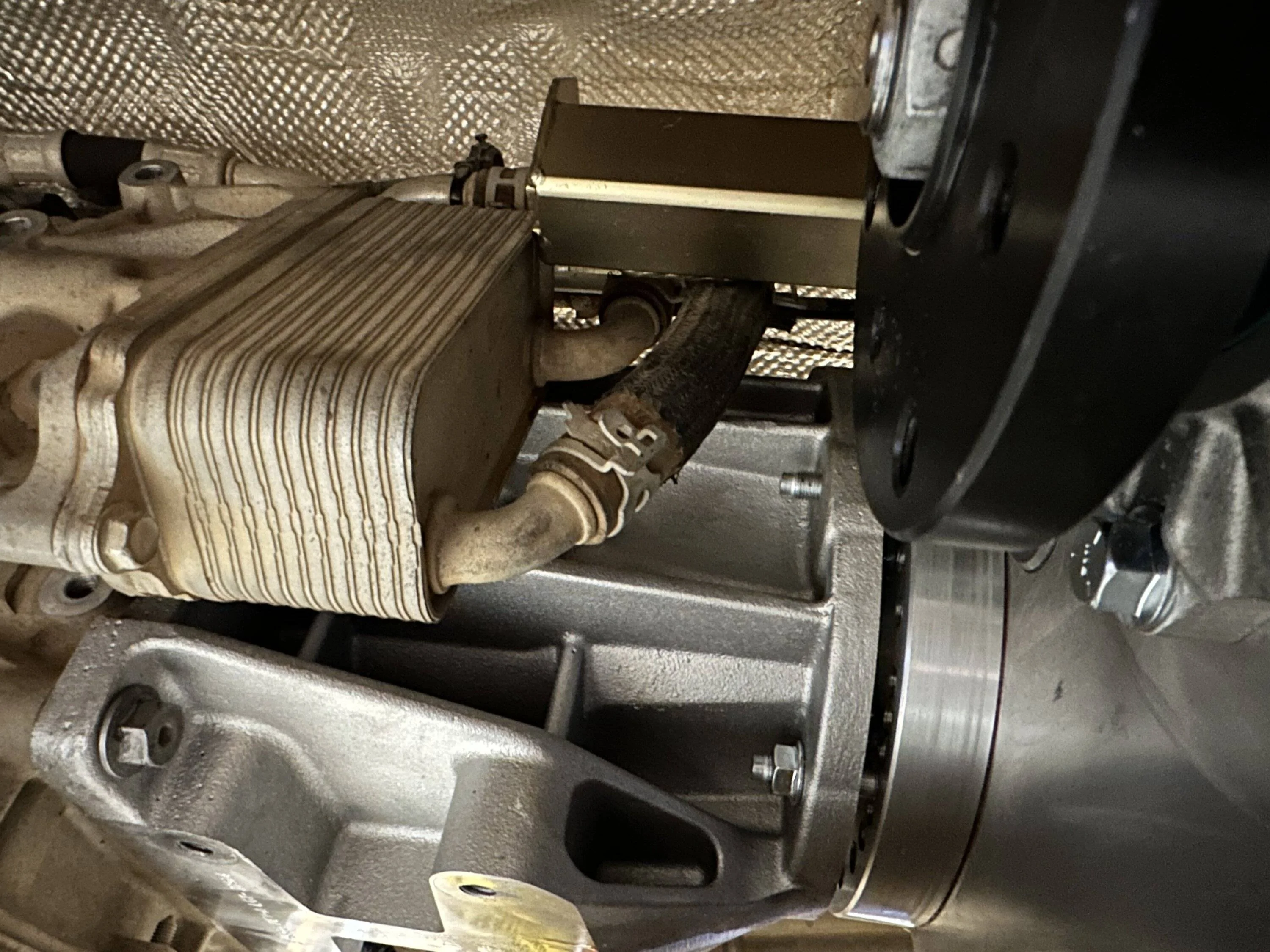

You can see the gap between the case an the adapter, while the bracket is slamming into the heat exchanger.

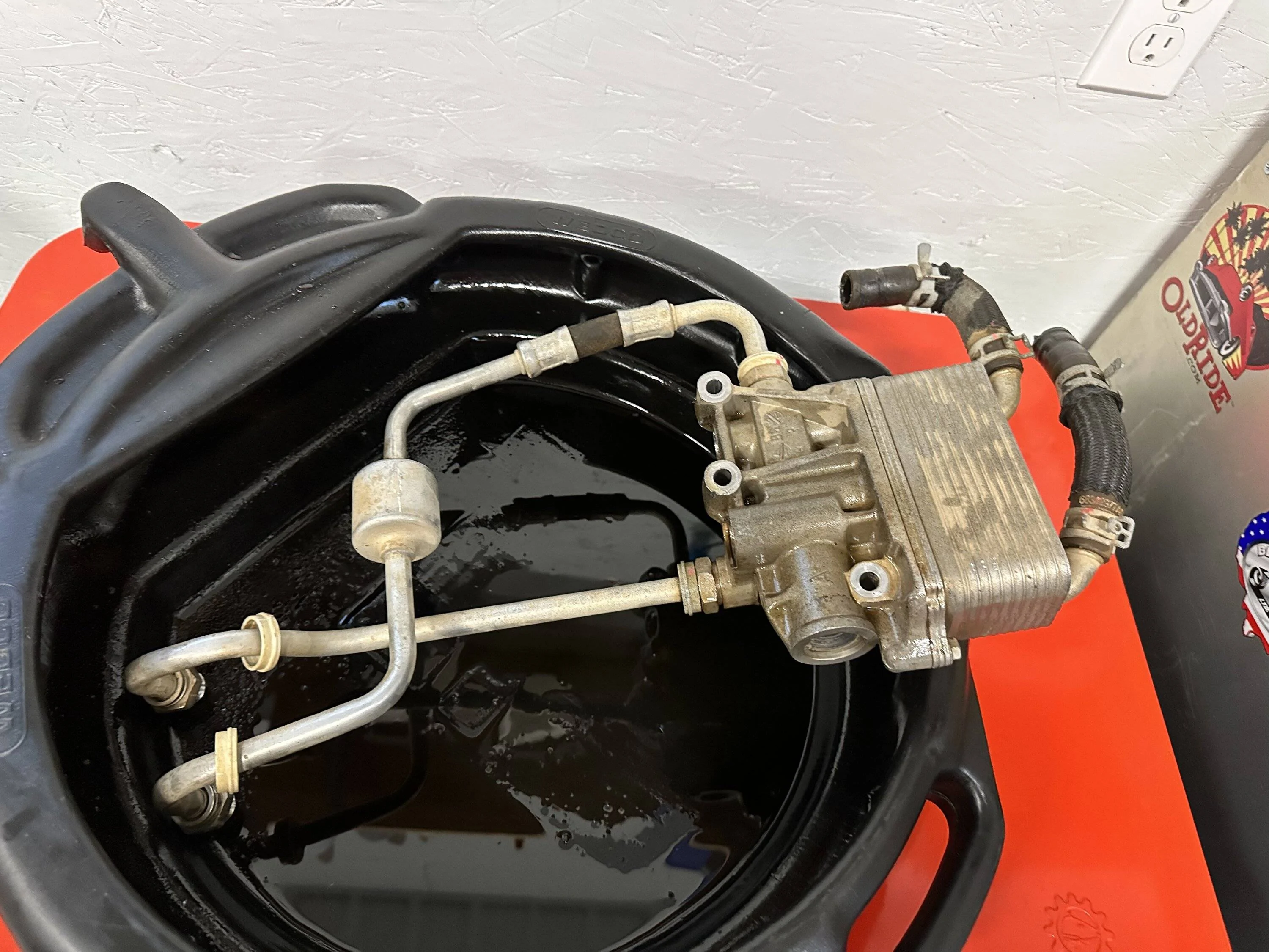

The heat exchanger removed-
We are completely removing the coolant lines (I’ve seen others tying the lines together back near the transmission). We pulled them completely out and he’s capping them at the tees in the main coolant lines up front by the radiator. Tomorrow we have a tubing master friend come over to help us modify the tranny cooler lines to fit into the transmission ports.

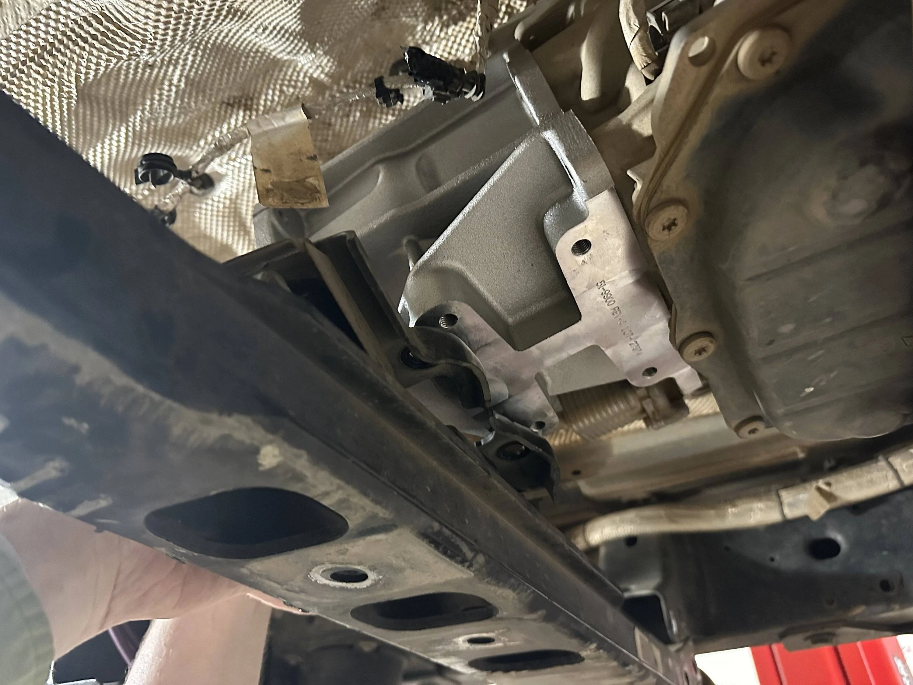

Every single step with the Atlas and fitment has been a total battle, here are two small examples of the constant frustration. The shifter cable hold down bracket that came with my friends would not work, no matter how hard we tried. So we dug into my parts and realized mine was slightly different, and it works perfectly. Just one more phone call to Advance (they are on speed dial now…)

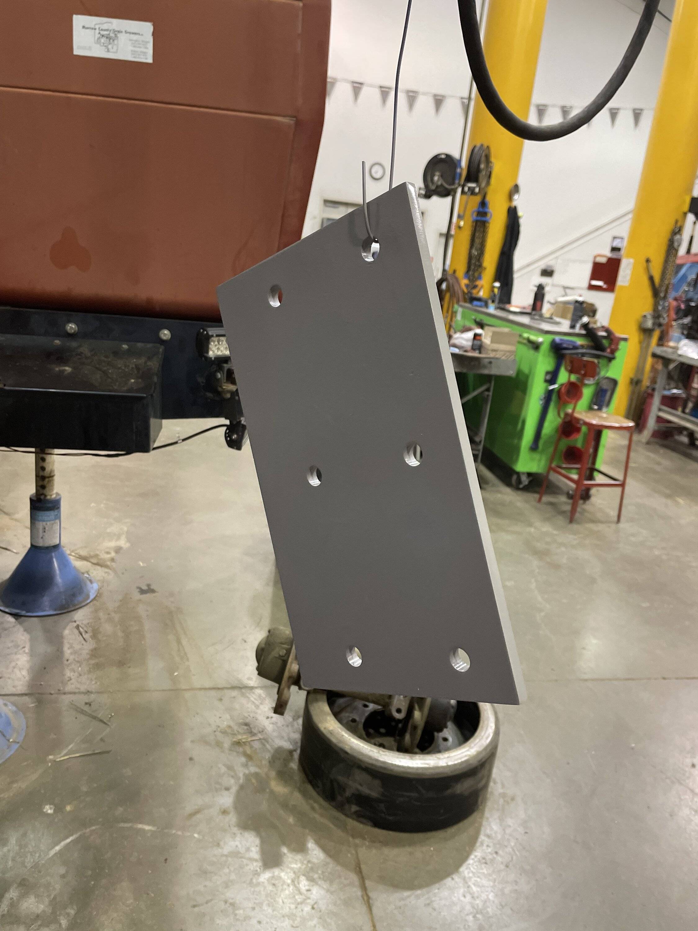

Almost forgot, the adapter also doesn’t bolt up correctly. It’s about 3.75” off. Advance’s “fix” was for us to fab a plate to make it work. My friend used 3/8” as you can see here to move the t-case rubber mount forward.
