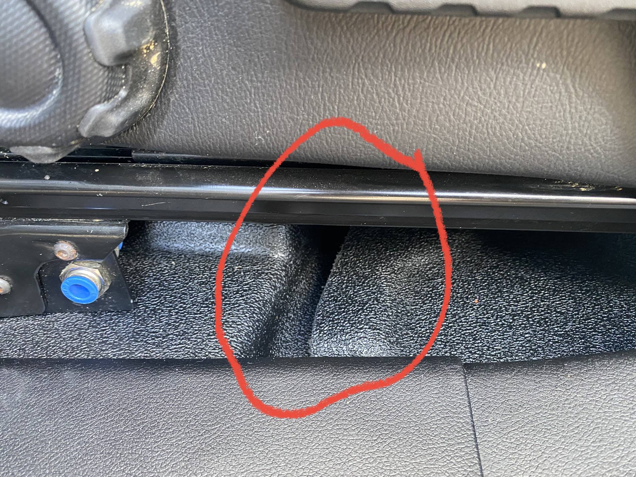

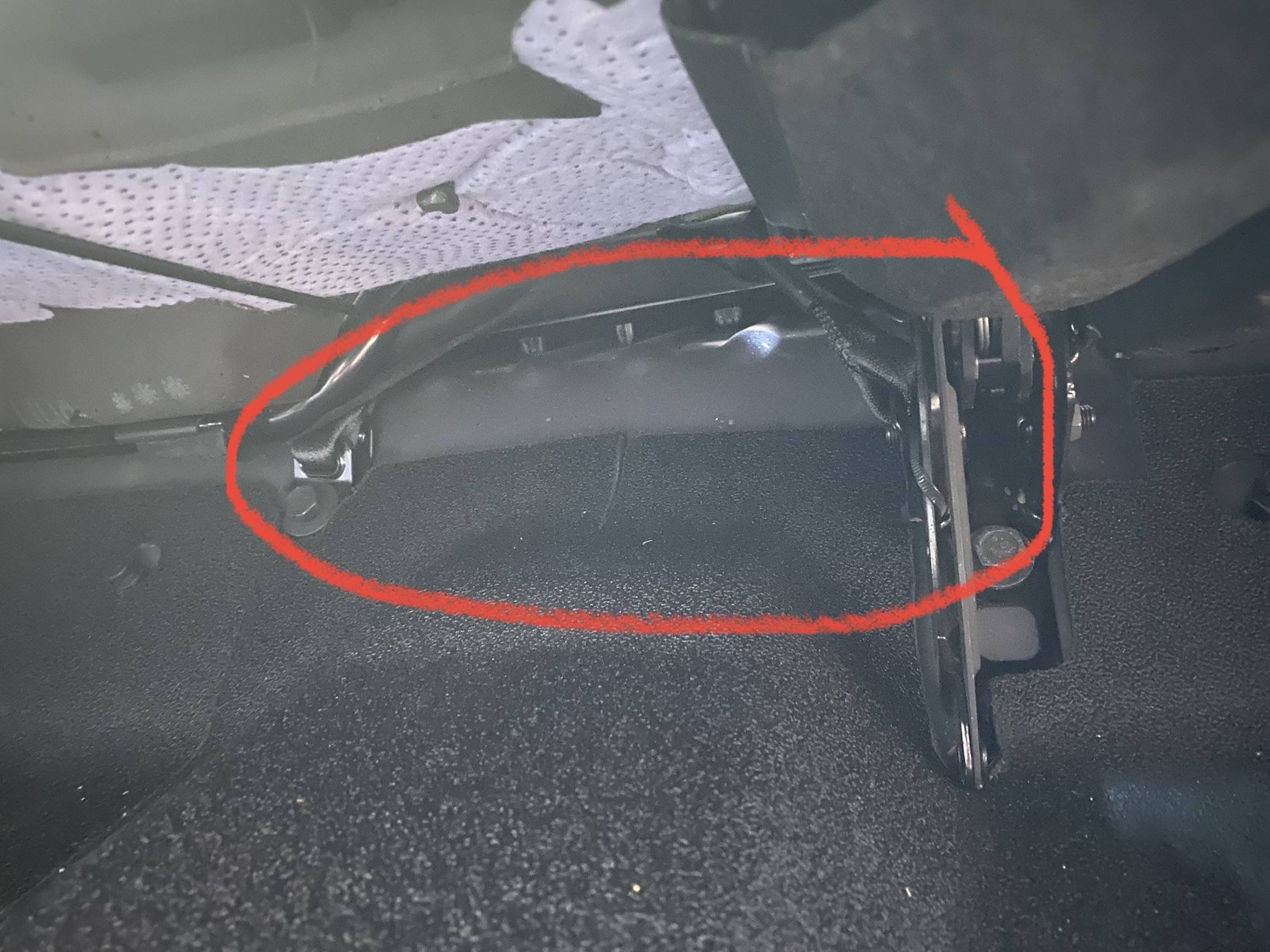

Installed the floors last weekend and I love them! Couple questions for those who’ve installed. Did I install the flooring under the front seat correctly? I put the edges of the back flooring over the front flooring around the air duct. There’s a little gap where it looks like stuff could get in if I had the doors off. Just want to make sure I did that right.
Also, I’ve seen in some videos they put the carpet coming down from the cargo area in the center over the Armorlite and snap it in place. I don’t have that carpet in mine. Did they get rid of that flap in the ‘21s?
If everything is installed correctly I guess I could put some rubber tape over the channel under the seat and over the back to keep it water tight.

That is a proper overlap, you can see the rear floor part has a raised section to match the overlap the front under it. There is a gap here to aid fit and installation. To eliminate this we would have had to make this a one piece floor but the variations in the sheet metal front to rear posed to much of a risk to get the plugs to align.
