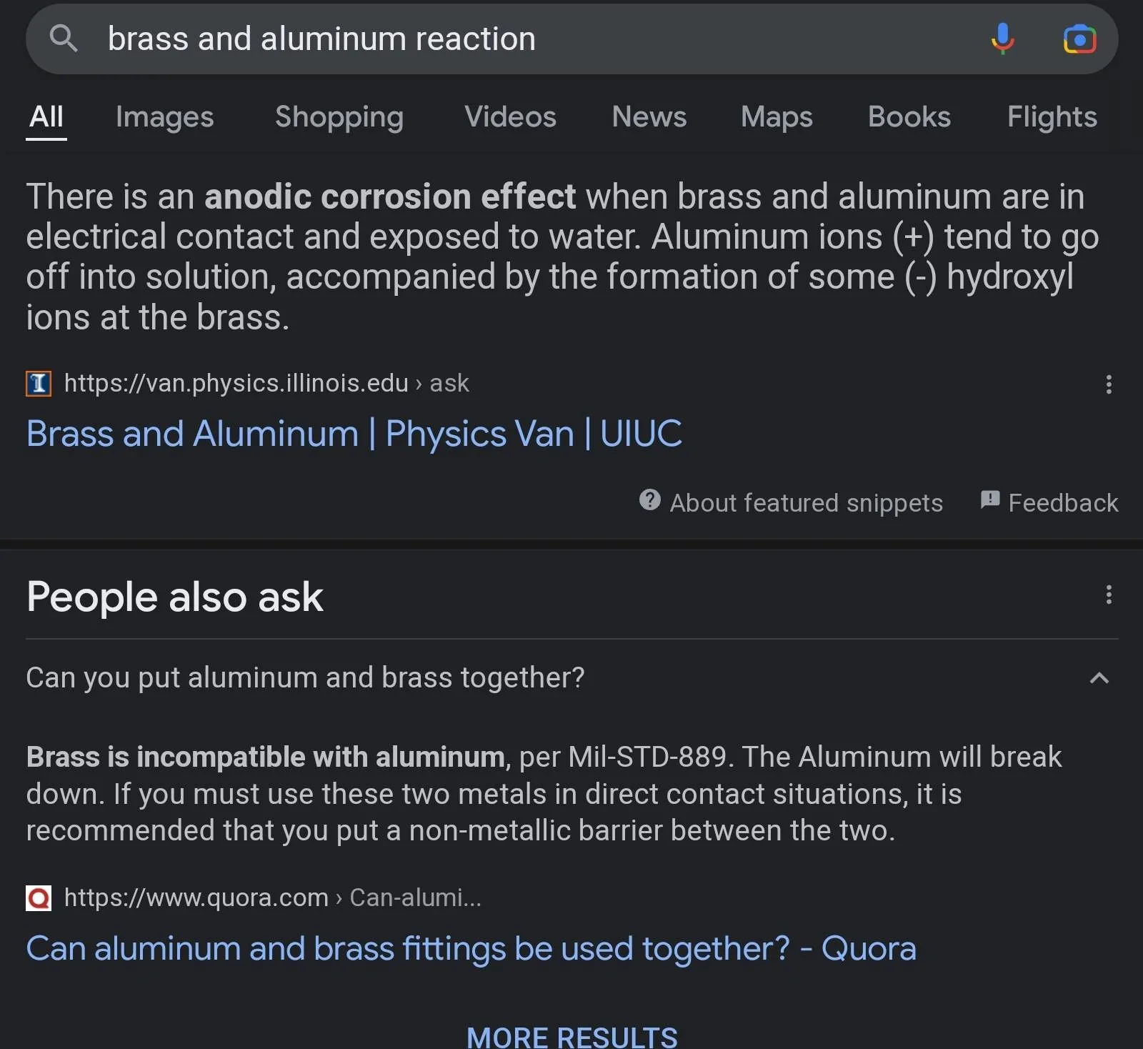

I used Delrin bushings and anti seize. No issues though 2 Canadian winters so far.
I wouldn't have used brass as I don't know how it reacts with aluminium.

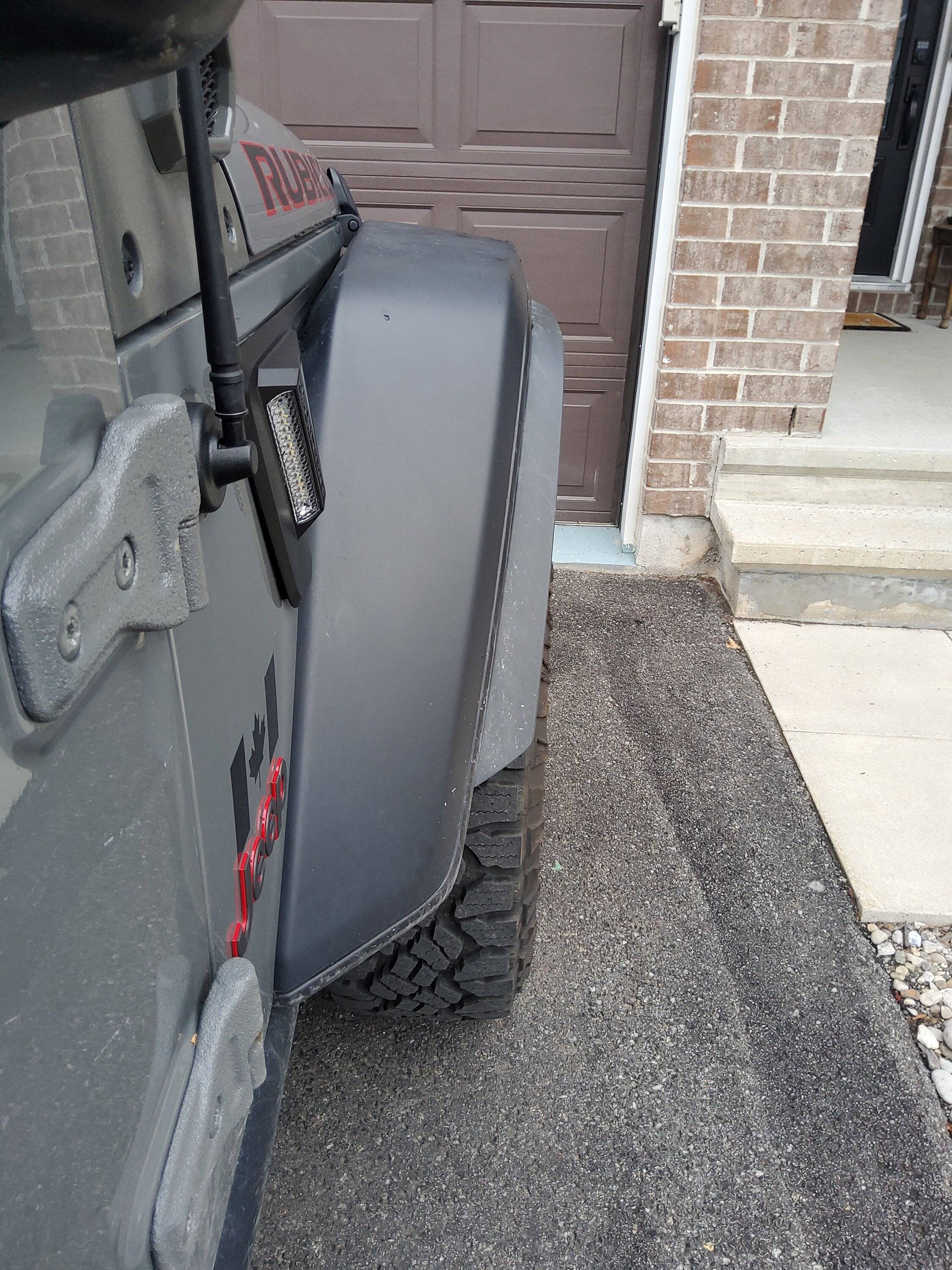

I took my hinges off ad had them Linex'd. Might be an option if you damage the paint. Easily colour matched as well. If the Linex guy can't or wants to charge too much extra to colour match. Just get them done in black and get the small can of Mopar spray paint in your vehicle colour. Couple coats and shes golden.
