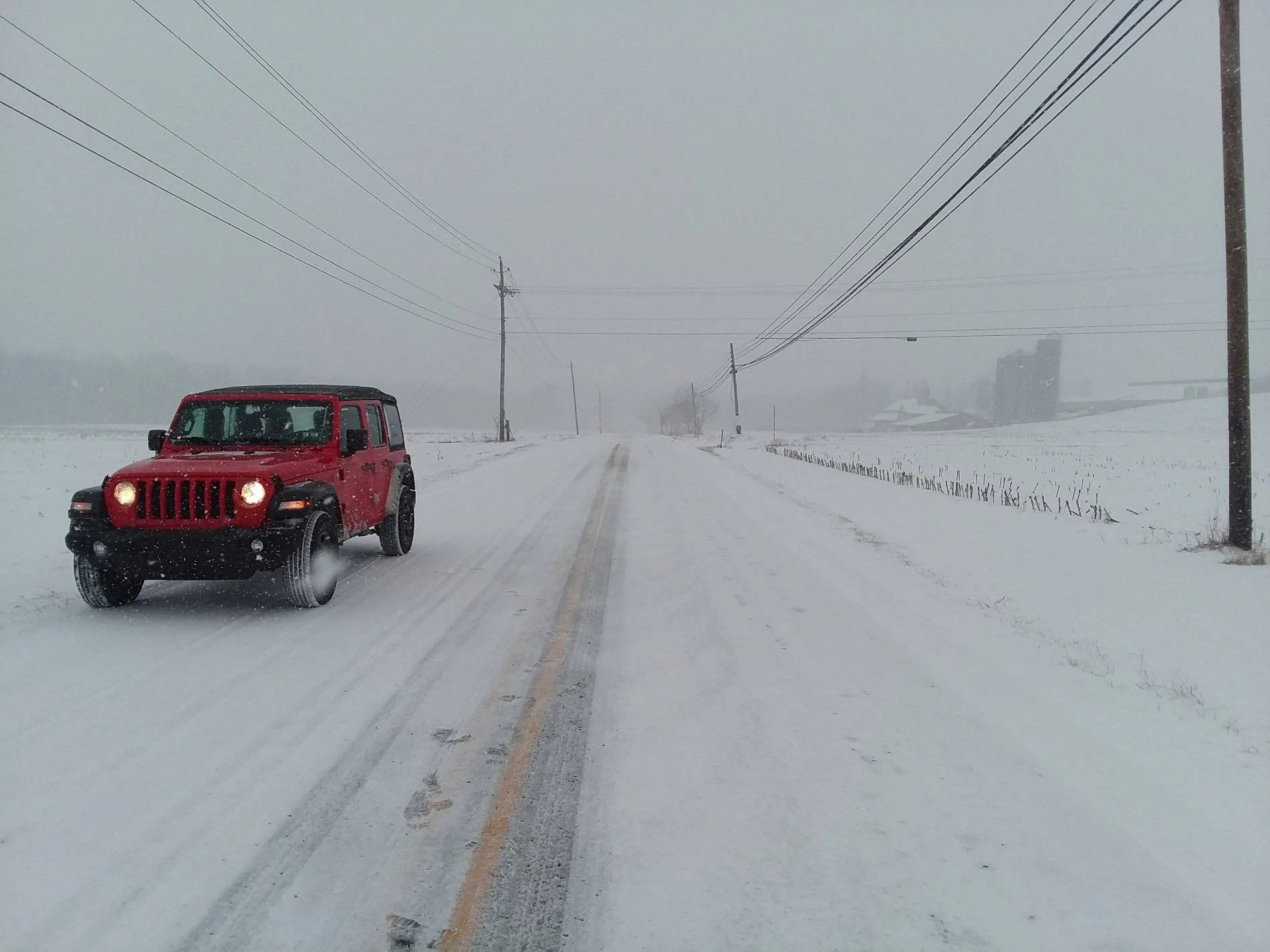

Wow, very surprised to hear you have a Wrangler and use another vehicle for winter driving.
The Honda Ridgeline that I used to own was better for driving in the snow than the Wrangler that replaced it. The Honda was heavier, with larger tires and thus a larger contact patch, and a complex electronic 4WD system that functioned flawlessly.
That's not to say that the Jeep is helpless in the snow -- it certainly isn't -- but if I still had the Ridgeline in the garage, I'd reach for its keys more often than not when snow accumulation made road conditions challenging.
As it stands, I use quality studded Generals on the Jeep when the white stuff falls, and it's all good.

a larger tire contact patch is not better in snow, Narrow tires are considered to be better in snow because of ground pressure. The small contact patch means ground pressure is high, which means there's a greater chance the tire will break through the snow and end up on the road surface.
