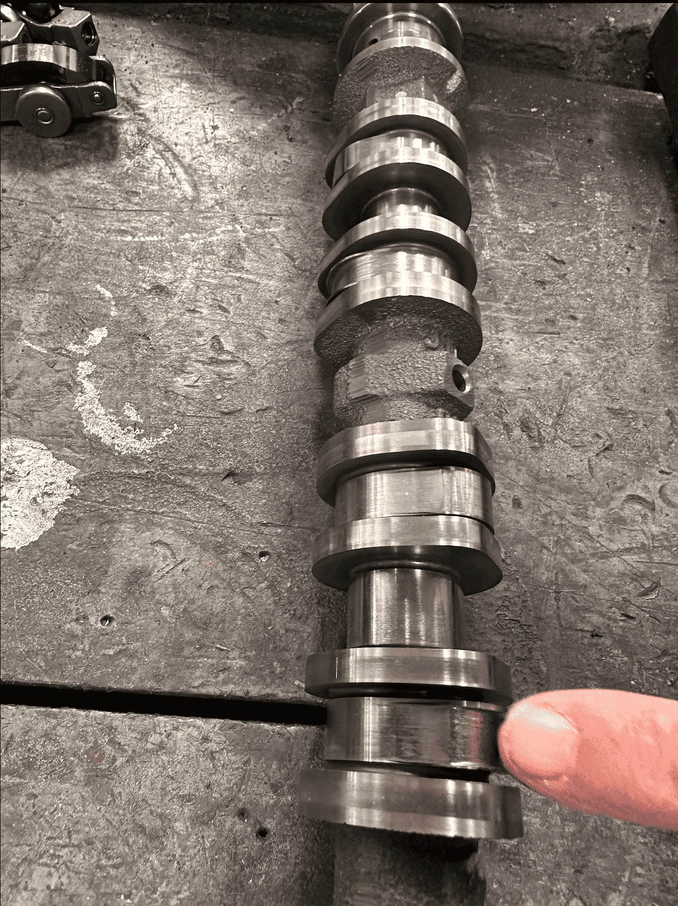

This picture was taken today, from my 2019 JLU engine.... Too bad for a well cared engine (oil changes regularly at the dealership).
Sadly for me, the engine here in Chile is covered only for 50.000km and not miles...
Used to love the jeep... now I am not sure any more.
Best,
R.

That engine could have been easily saved when it started making noise.
