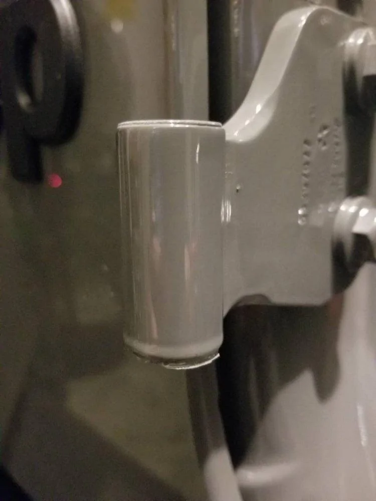

I was hoping they did. When looking at mine, they look different (JK vs. JL). Looks like jeep put two halves in. My JK only had the lip at the top...this one looks like if I chip the top ring off, I won't be able to punch it out from the bottom. Did you notice anything like this? I put a pic of mine so you see what I am talking about.
There is a small retainer clip at the bottom. Just like your pic. My guess to have the bottom bolt screw against. I just pulled them. I dont put bolts back in
Once the bottom retainer clip is out. You can bang them up and out

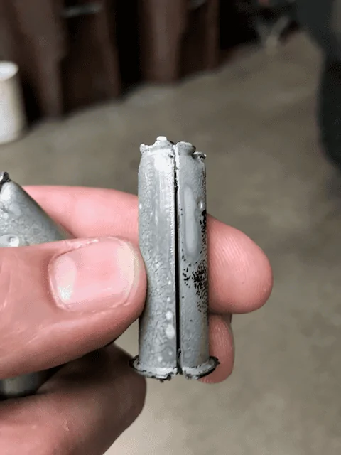

I just replaced mine with the TMR delrins yesterday. Just some observations for others that may want to do this.
I found that there was no bottom clip on mine, but the bushings are one piece. I could not get them out easily because of the lip on both ends.
So, I used a hammer and a punch to bend in the lip on the top, and then used the handy removal tool to bang them down and out the bottom. Pic below, but you can see it's a single piece and had to destroy them to get them out.
But I'm satisfied and as previously mentioned the TMR JK bushings fit the JL perfectly.

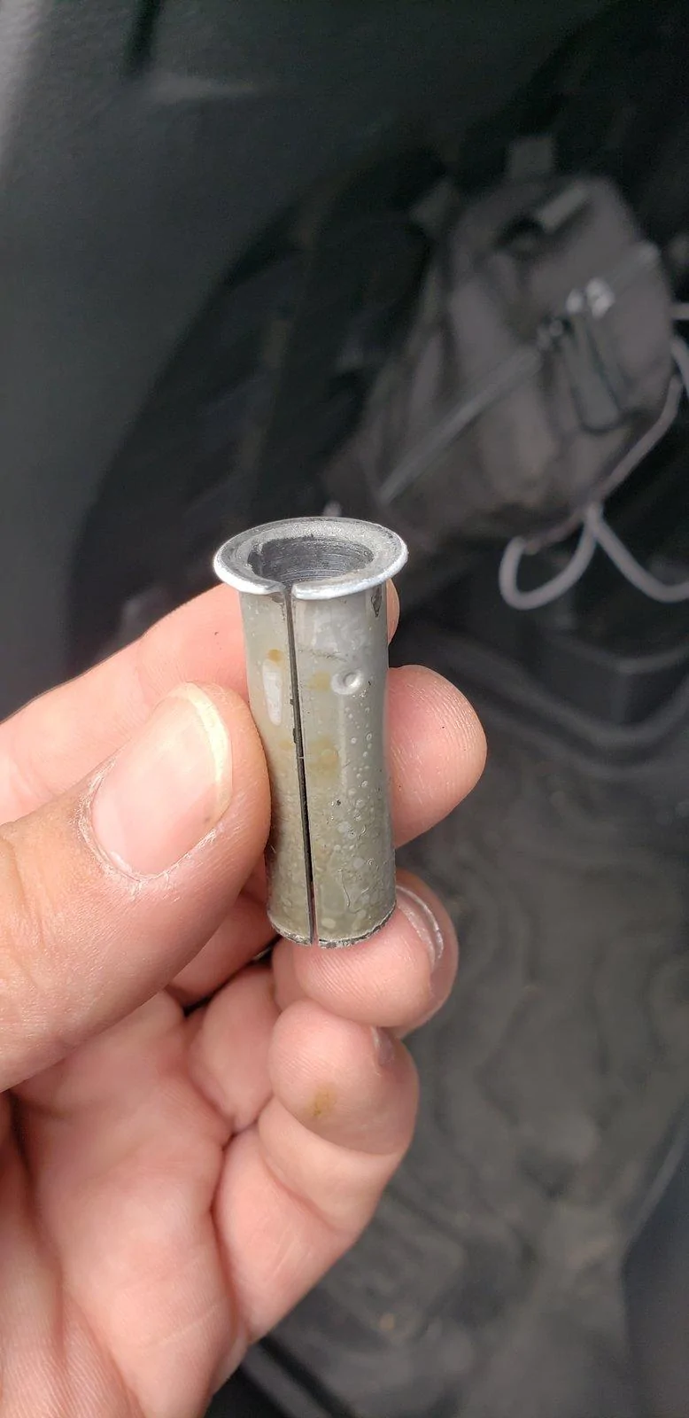

Weird mine has a retainer on the bottom that is a seperate part. Went up smoothly.
Yes you can reinstall bottom screw after. But I just leave them out
