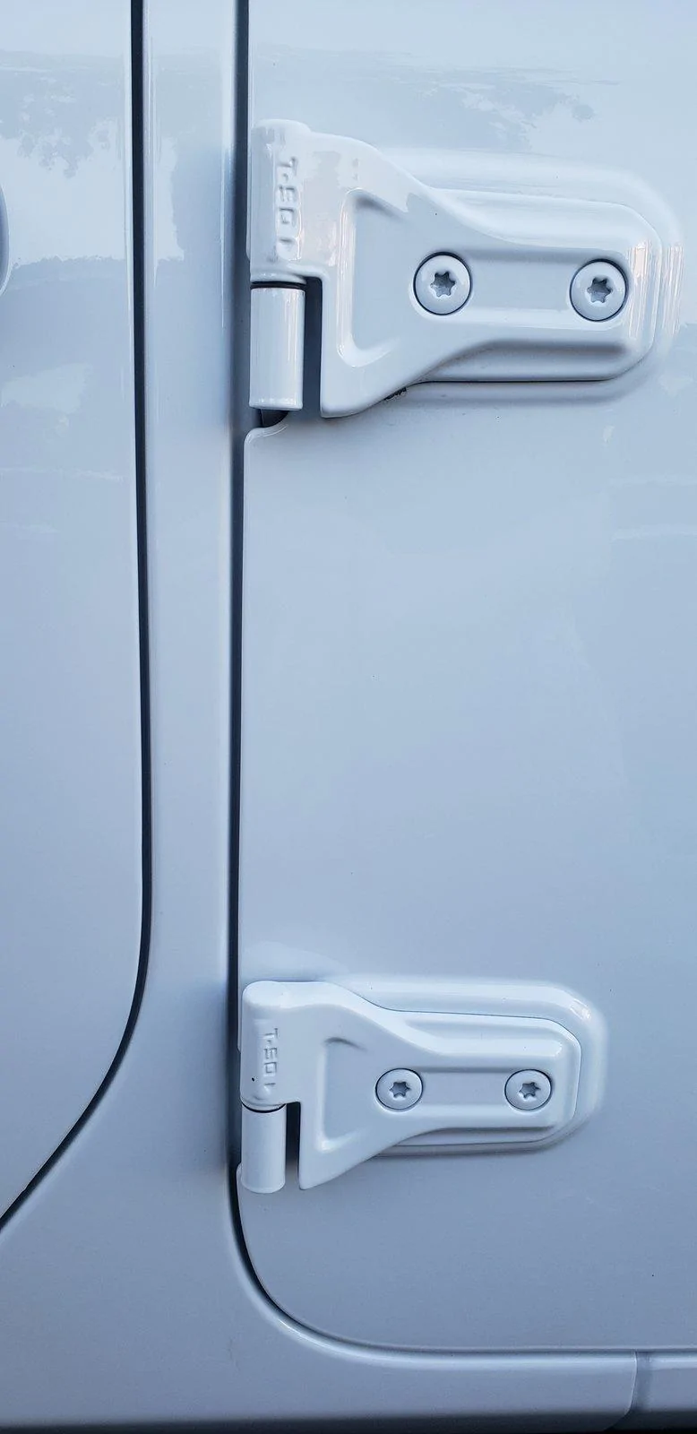

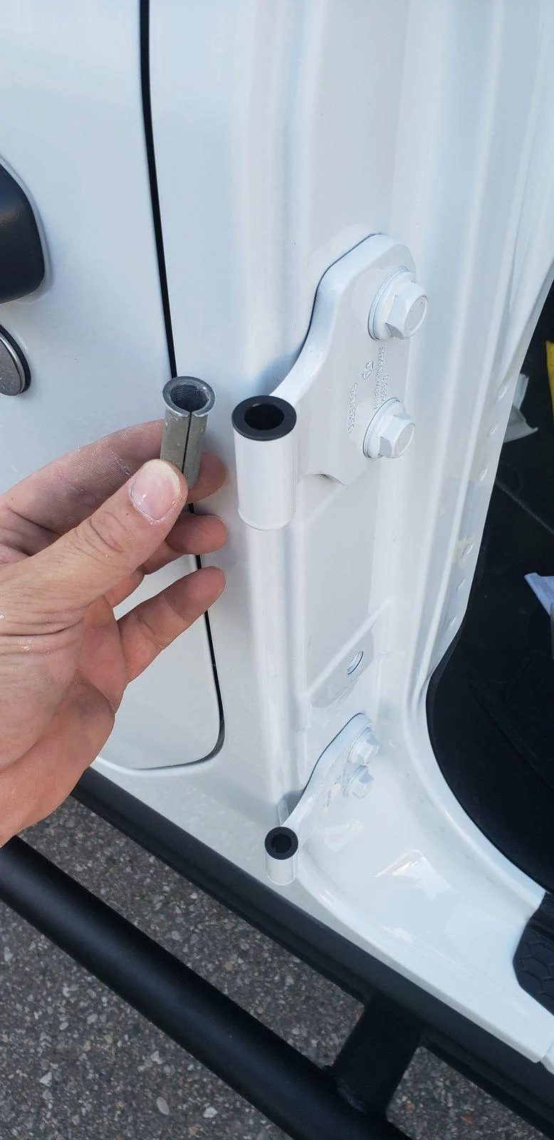

Just took the doors off my JLUR for the first time and I was hoping FCA upgraded the door hinge bushings from the JK. They appears to be the same as the JK. These bushings only lasted a couple years before they corroded and made it impossible to remove the doors after a couple of MI winters. I will most likely be switching them out for some Delrin replacements, unless someone else has a better solution. Loving the JLUR, top down, doors off and bumper stubbied.
