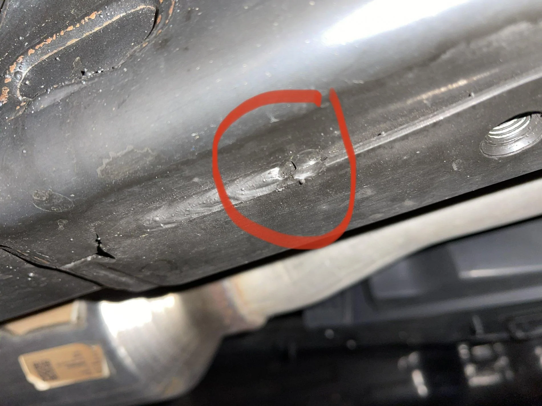

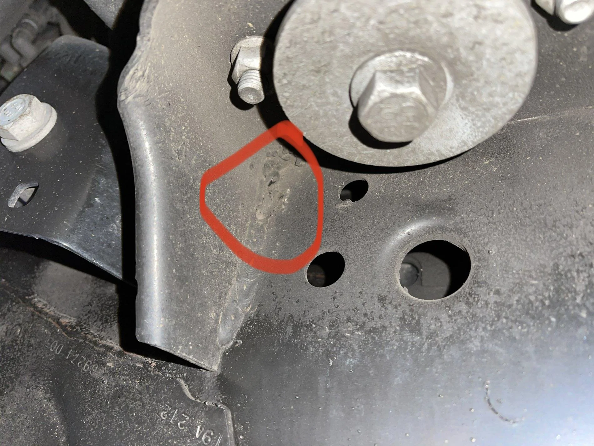

I have a 2020 Sahara that is a year old. I’m not an expert on welds but I don’t think these holes should be in them?
Jeep Wrangler JL any issues with 2018 models? C362E92E-829C-4CEB-8D24-22AFC5EDB695
Jeep Wrangler JL any issues with 2018 models? D12F8919-C113-4B17-BEC6-0154B95F3743
Wow Evan, those are some sloppy welds. I’m surprised being the welds are done by robots.
Sadly, “sloppy JL welds” is a thing on Google.
The robot welding JL frames is a flunky; it has been welding sloppily since day one.
Apparently, it wants be a cake decorator... :LOL:
FCA’s frame welding class
