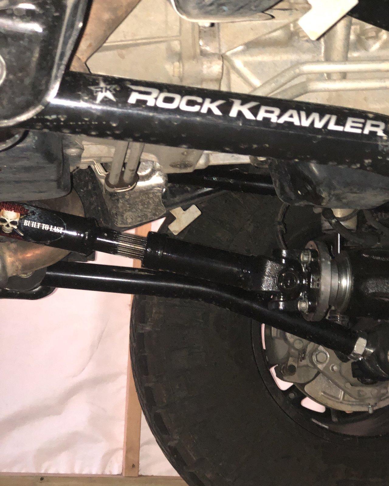

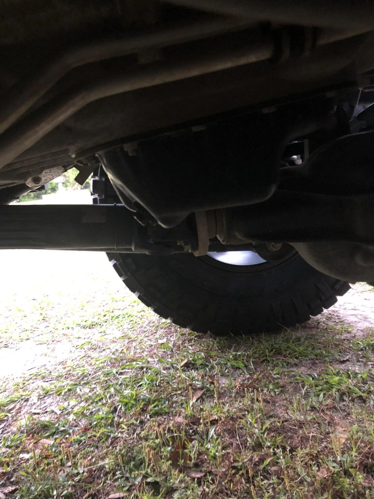

Yeah that would be sweet if it worked, have you tried it? I’m running 6.5 degrees castor on mine and it handles sweet, tracks straight, and no wandering. I don’t have to bad of angle on pinion but I don’t think I’d go much more than that. I think it’ll put more stress on ujoints at the wheels when in 4wd. Here’s pic of my driveshaft angle at 6.5 castor. I’ve recently upgraded my front driveshaft to Adams 1350 in anticipation of going with more lift in the future.

Yeah that would be sweet if it worked, have you tried it? I’m running 6.5 degrees castor on mine and it handles sweet, tracks straight, and no wandering. I don’t have to bad of angle on pinion but I don’t think I’d go much more than that. I think it’ll put more stress on ujoints at the wheels when in 4wd. Here’s pic of my driveshaft angle at 6.5 castor. I’ve recently upgraded my front axle to Adams 1350 in anticipation of going with more lift in the future.
Man id swear that was more than 6.5 degrees lol

Lol...( sarcasm?) . no I was there and saw the read out, besides I had to loosen and tighten that stupid jam nut three times at 250 ft lbs :facepalm: before we got it right. Wasn’t shooting for a specific number we just adjusted and drove it until it drove sweet and that’s where we landed.
No i was serious lol. It just looks from the picture so far down lol. Oh i know those jam nuts are a pita haha. I have to do mine on the ground (no lift yay) Its no fun lol. Mine was at 6.5 at one point and it didnt look that far thats why i asked lol.

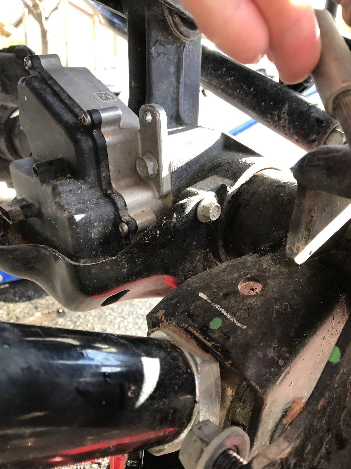

I didn’t have to do any cutting or notching, I have the X factor high clearance ones, but with my ocd, I totally get it matching the wheels for sure. Lol.
I had the xfactor ones as well. I couldnt get full droop. My jam nuts would hit the control arm brackets and stop. They are nice control arms dont get me wrong though, that was just my issue.
I gotcha, maybe because I’ve got Mopar springs and fox shocks I’m not drooping enough to notice lol, but I’ll definitely check it out, thanks for insight.

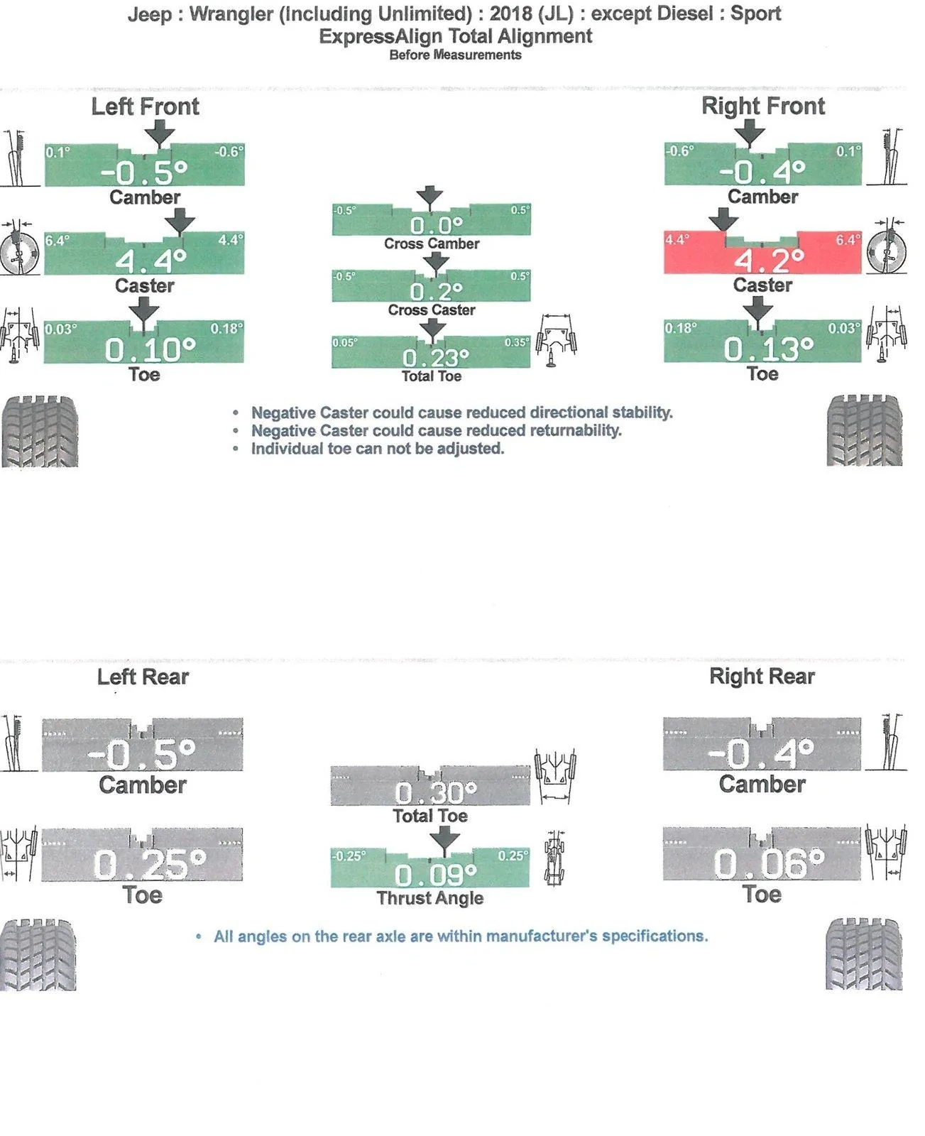

Could be several different things, was toe in spec? If you got 3”’of lift then you’ll want to change the fixed front lower control arms that came with the kit and get some adjustable ones. You need your castor set around 6 for it to drive the best. If you get new arms have them installed and do alignment. Check your tire pressure make sure is around 30 psi and it’s the same in all tires. Some of your factory specs aren’t good now that you’re lifted and on oversized tires.
Hey Roky,
I just got a copy of the alignment, let me know what you think. He said he wanted to get some sort of caster adjustment although I can't remember what he called it. Maybe it was control arms? He also mentioned he wanted the right front caster value to be around 5 or > if the left stayed at 4.4. So I guess we will see.

Here’s a better picture of pinion angle..... I think it’s a better picture... lol.
Haha much better! Looks like mine does now lol. Hows that adams drive shaft? Ive been looking into them but wasnt sure how it would handle the pinion not being directly inline
Works great, way better than stock one, smaller diameter but stronger, and it’s kind of a cardan joint at transfer case so it handles the angle real well.
