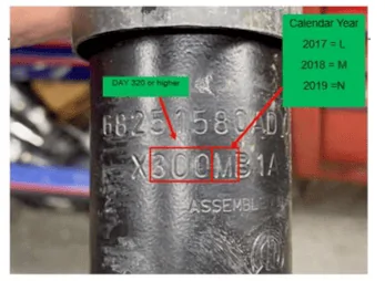

What's the date code on your OEM steering stabilizer? One of the symptoms is that it pulls to one side or the other. To test, just remove the OEM steering stabilizer and take it for a test drive. Removing the steering stabilizer is simpler than changing a tire. If the pulling goes away, it is the steering stabilizer. Bad date code info at https://www.jlwranglerforums.com/fo...-end-jan-31-2019-star-case-s1819000004.25550/

The first scheduled service per the owner's manual is 20K. Do you mean your first oil change? The stock OEM steering stabilizer is all black and 'Mopar' is etched into the casing, hard to read. Do you have the Fox steering stabilizer? As far as pulling to the right, as long as your PSI is the same on both front tires, you (or your dealer) could remove the steering stabilizer and take it for a test drive to see if it still pulls. If it doesn't pull, then it is the steering stabilizer.
