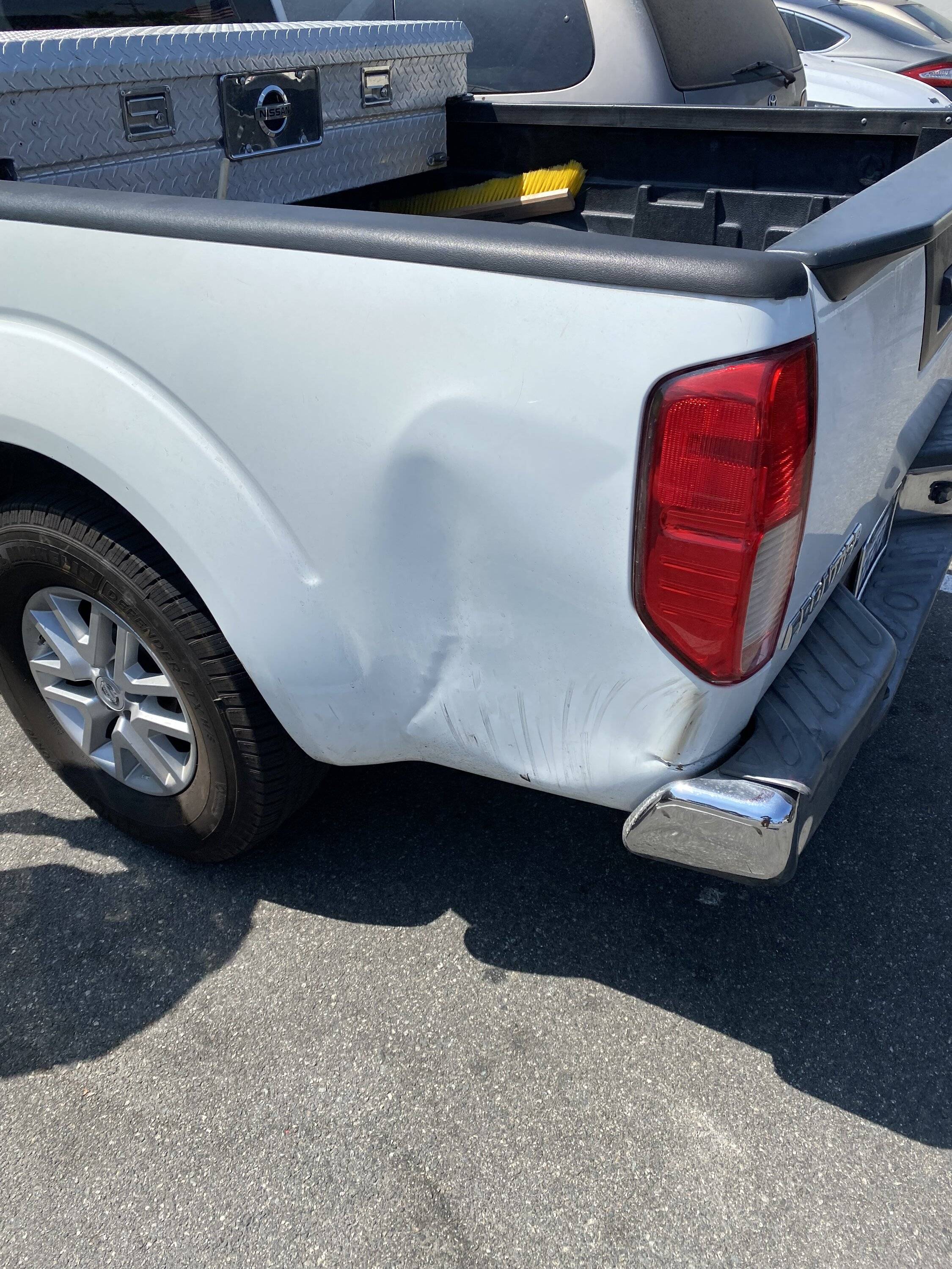

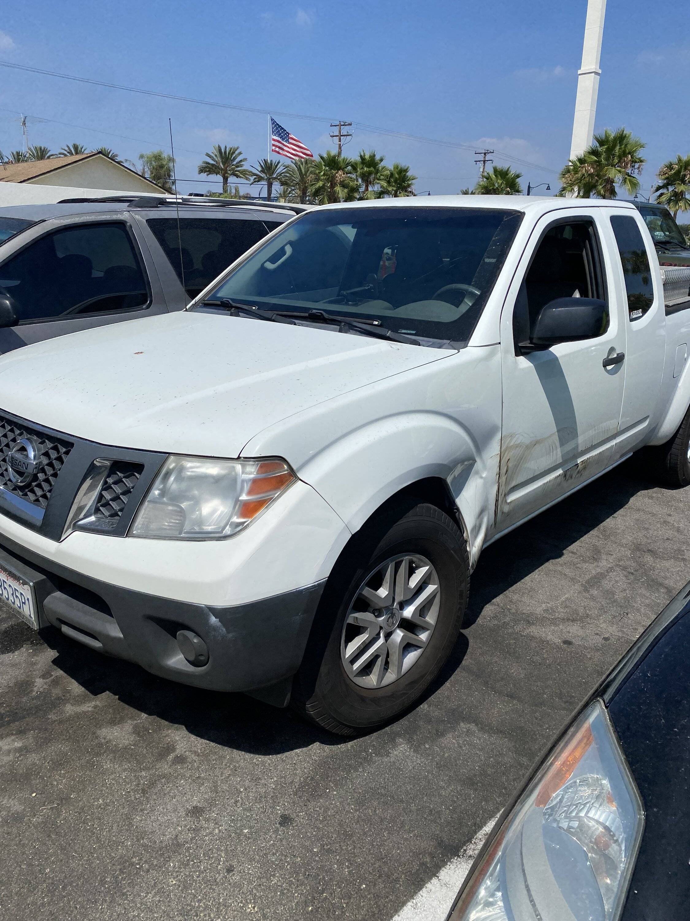

So I had a side swipe on the freeway today, and the driver on my right pushed me into the left lane into a big rig. The truck that pushed me was a Nissan frontier. He sustained some damage from my 37’s lol. But I seem to have come out scot free except my steering wheel is a couple degrees to the right now when driving straight. I figure I can make the adjustment to fix that, I want to avoid involving insurance but I want to be sure my axle wasn’t bent when I got sandwiched, before I decided to avoid the insurance hassle altogether. Is there any way I can check if it’s bent without having to go to a shop? I have a fair amount of tools but unsure how to check. The Jeep seems to be driving straight but it was hard to tell cause I didn’t get above 35 mph on the remainder of the drive home. I attached pic of the damage to the other guy. My Jeep only has a slight scuff on the front passenger rim
