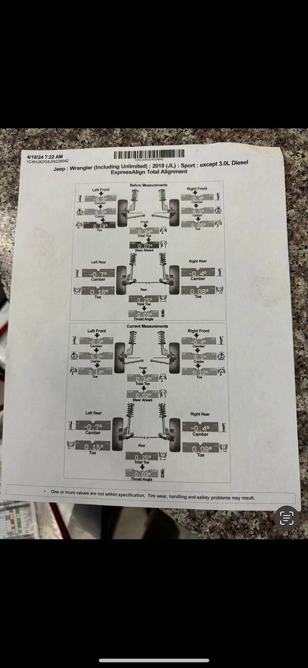

What’s everyone running for caster? I have a 3.5” MetalCloak lift on my JLU and the jeep just seems to wander and pull all over. Here’s my most recent alignment. It’s a 2018, has the updated iron steering box.

I would adjust your front lower control arms 1 full turn out from where you have them now.
I would also have someone turn your steering wheel back and forth while you watch the drag link and tie rod ends to see if there is any movement. They probably need replaced with stronger new ones (Metalcloak was my choice). If it is a 2018 and you haven't replaced the ball joints, then they need changed as well (Dynatrac was my choice).
I did all of that to mine, and caster is set at 5.9 degrees. It drives better than when it was brand new.

Your numbers look good. The optimum Caster number for a JL is 6°. A JK is 5°.

Ball joints is what I was going to update next, The draglink is new and the Tie rod has no play. I'll adjust the lower arms and see what happens. Thank you.

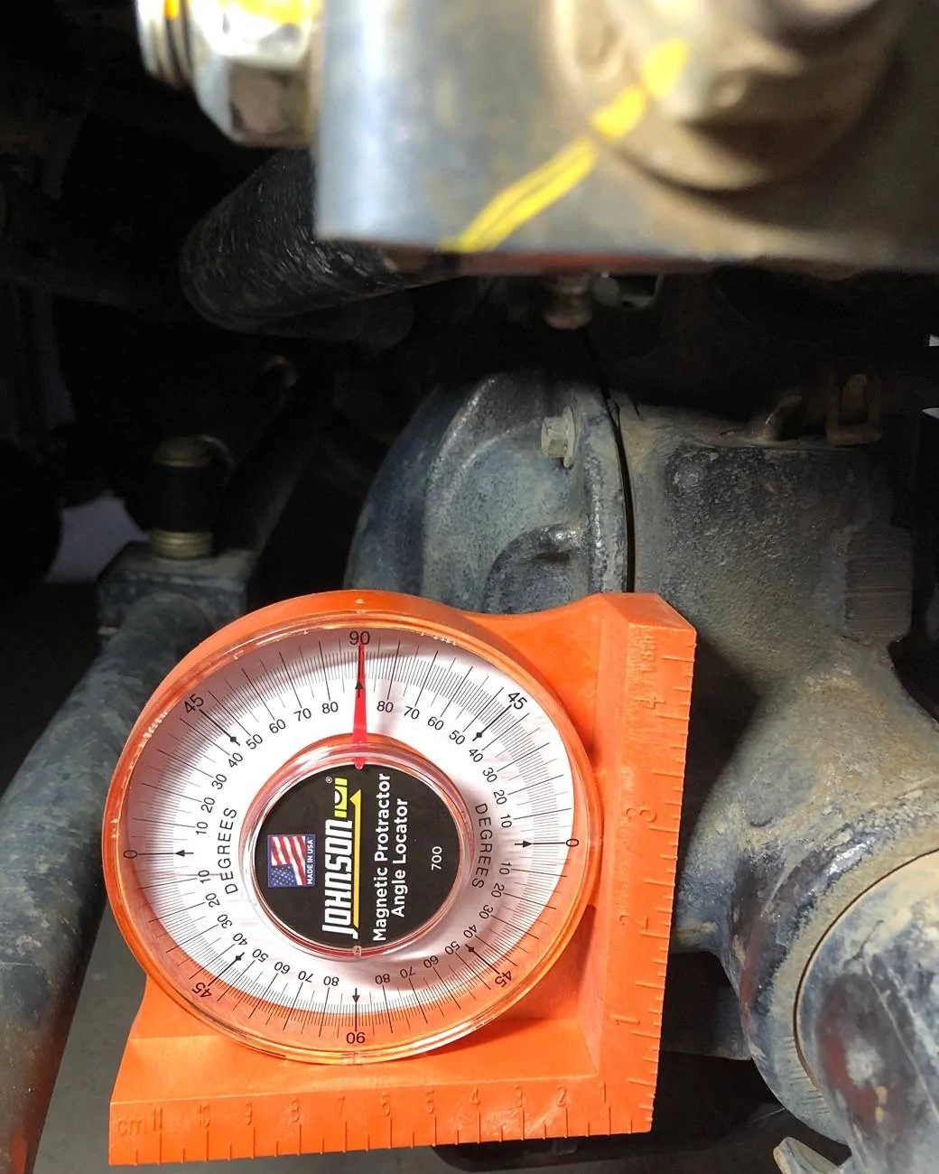

You likely got more than 3.5” lift so you need to get your caster to at least 6 but I would shoot for a little more…. I’d try this first, it’s free…put the Jeep on level ground then put a angle finder on the flat circle to see what it reads now…then adjust your lcas longer or ucas shorter… do one full turn then check it adjust as needed….. if you use an analog angle finder like in pic, then 90 degrees is 6 degrees caster…
