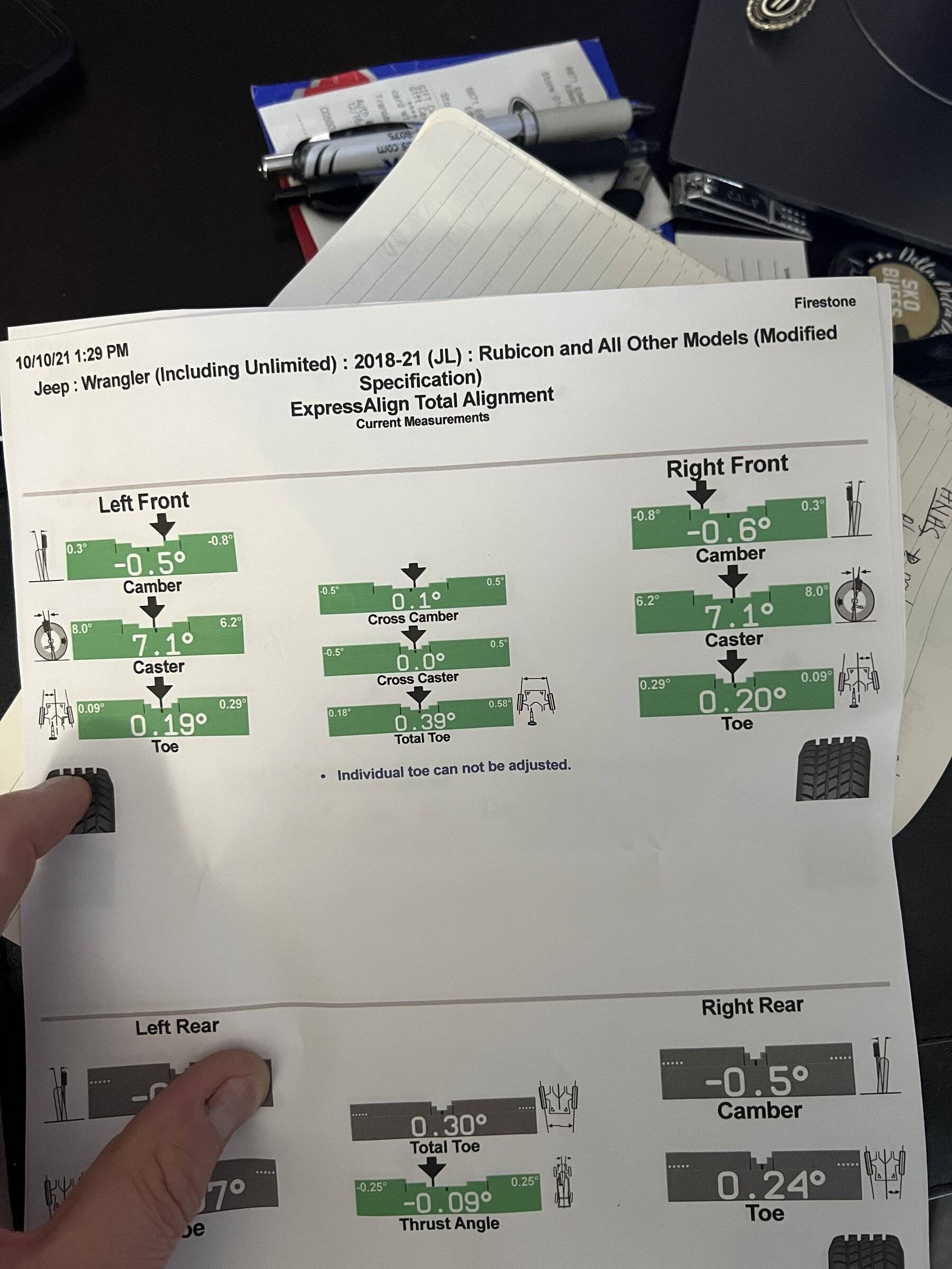

I am wanting to make sure. Seems like caster and toe might be a little to much. Thanks
Stock? Lifted? Tire size? That spec seems high. I thought stock was 4-6 or so. But I see the paper says modified…
edit: read your signature. 3.5” lift and 37s. I think 7 is good.

They are all within spec. I prefer caster on the higher side personally. Toe could come in a bit but it's certainly not problematicaly high.

If it drives good, leave it be……..
It does wander around a bit and takes more input than when I had 35s. I knew to expect that but just trying to make it a little better if possible

If you’re really at 3.5” lift then bring caster back to 6,2-6.5 and bring toe to 1/16” toe in and try it. The higher the lift the higher caster feels better , but if you’re at 3- 3.5” then to much caster will make it go where you put it, or not center itself as well and you’ll have to make more corrections….
