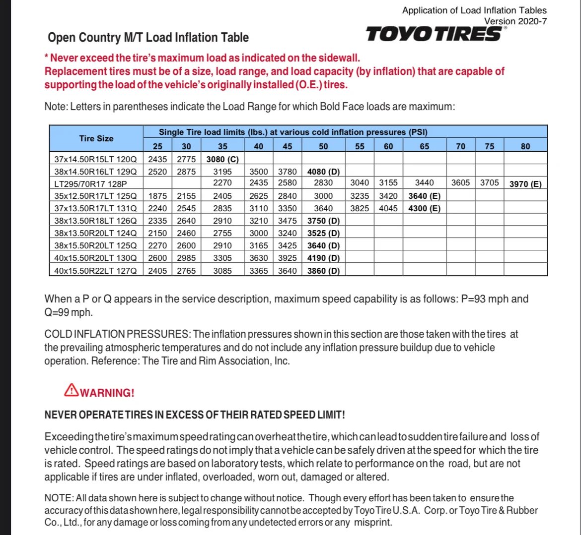

Consider that a 3500 Ram on the same tire at 50psi would have the same contact patch (tire bulge) as a 4,800lb Jeep at 25psi. That’s why we have tire inflation formulas that take vehicle weight into account.
https://www.toyotires.ca/sites/default/files/guide_application_of_load_inflation_tables_2020.pdf
Single tire weight on a 4800lbs Jeep is 1200lbs which the chart doesn’t go down that far (2240lbs) for 25psi.
It's interesting that they specify cold pressures. So 25 psi is more like 28 warmed up. That table provides only the load bearing limits. Appropriate pressures for a specific vehicle on a specific wheel width are other factors that deserve consideration. Compromises.

All the tire is concerned about is the pressure per vehicle weight. The heavier the vehicle the higher the pressure must be to maintain the same contact patch.
The inflation formulas use vehicle weight per tire, max tire inflation (as specified on tire) and maximum single tire load (as specified on tire). Vehicle type or wheel width doesn’t change the load rating. I agree Wheel width can change the contact per pressure. Another reason to do a chalk test.

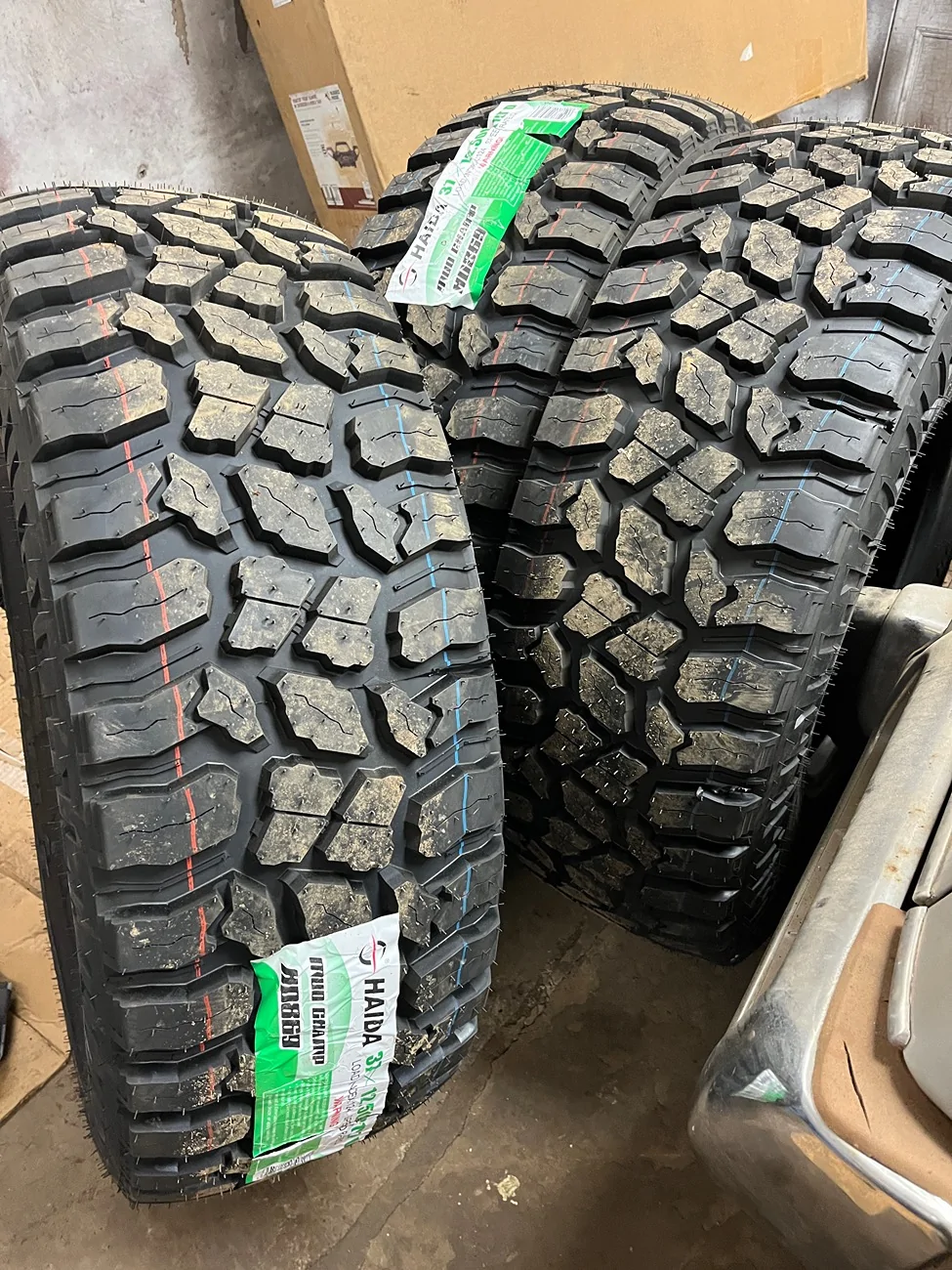

Not all tires are crowned. Haida tires are crowned as well as Patagonia, which is indicated on the tread by orange and blue inflation (contact patch) stripes on the tread. So the chalk test should be done to pattern to those stripes rather than full tread.
All my tires other than Haida 869 have been full contact patch tires, hence chalk test has been done to that.
My full tread chalk tests provide me a warm tire pressure of 27psi at most. I rotate every 5000klm and measure tread for wear every rotation.
If you were to follow tire inflation formulas that take into account vehicle weight and tire max weight capacity etc. you would see inflation numbers for 37s in the neighborhood of 22psi cold.
Following photo of Haida 869 with blue and orange contact stripes.
