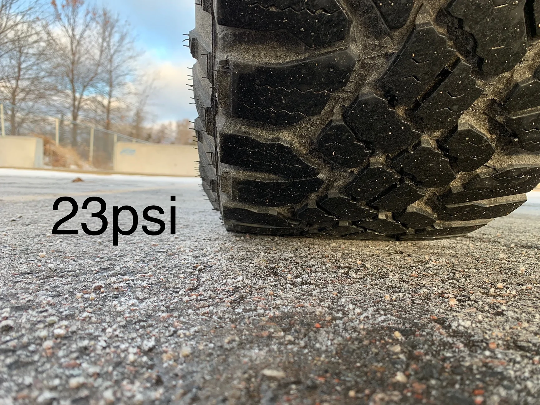

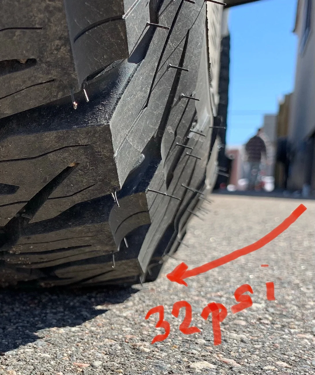

This is what you get with a OE 315/70R-17 at 32psi
Jeep Wrangler JL Air pressure with 37s? IMG_7645
Jeep Wrangler JL Air pressure with 37s? IMG_7557

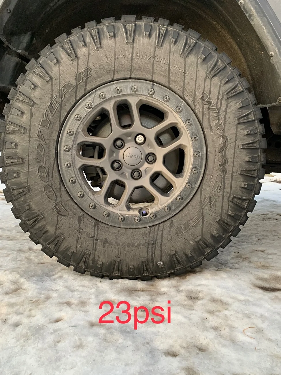

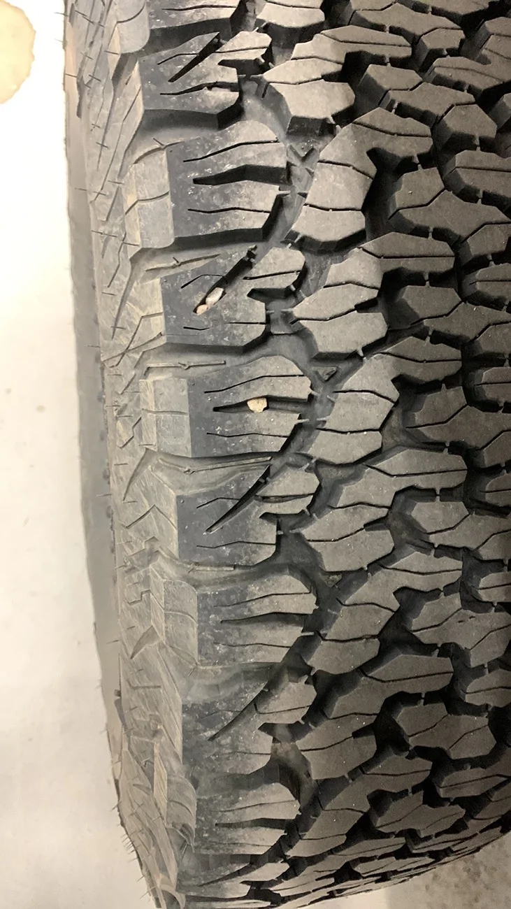

And this is the same size Duratrac at 23PSI
Jeep Wrangler JL Air pressure with 37s? IMG_8386
Jeep Wrangler JL Air pressure with 37s? IMG_8388
