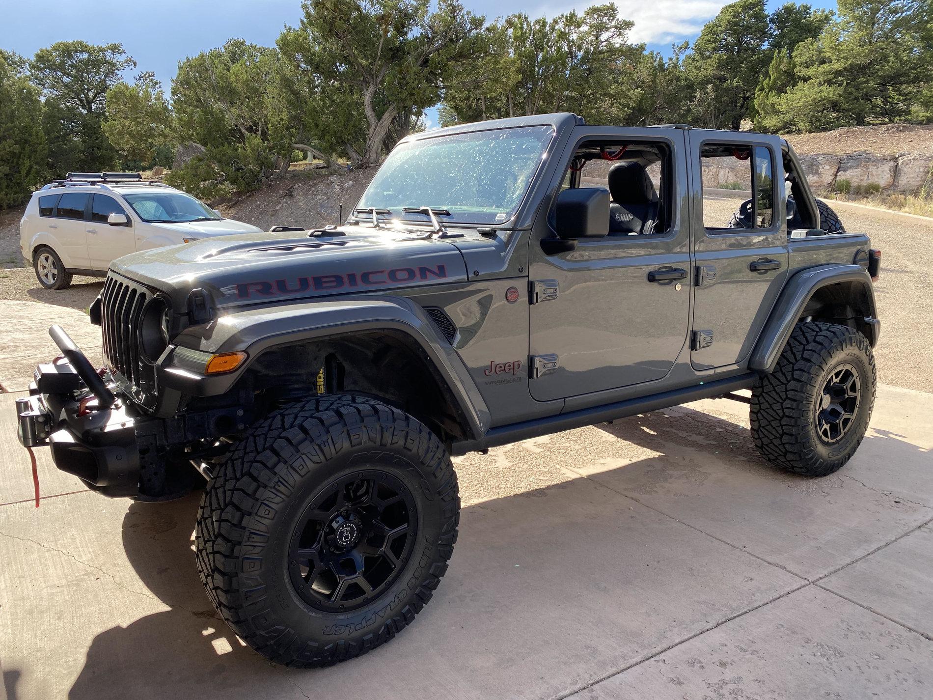

Hi All, I'm also between the AEV 2.5" lift vs the Dynatrac Endurosport 2" lift. I have added about 550 lbs of modifications already and I'm a bit concerned if the Dynatrac Endurosport 2" lift will sag or bottom out when I go off-roading. In the other hand, I like that the AEV 2.5" lift kit is designed to carry more weight but I'm concerned with some of the comments regarding 3 - 3.5" of actual lift and not 2.5". With my 35s (no future plans to upgrade to 37s) I have concerns that the gap may be too much.
Can anyone that has this lift installed for a few months please provide any updates? Did the springs set? Much appreciated.
I've only had mine installed about 6 weeks but no change on the height. I haven't loaded it down yet or done any wheeling so I can't speak to durability or handling off-road. With that said, I love the lift and so far would highly recommend it. The extra height above the 2.5" is kinda nice, but I guess that's all individual. If you look at my photo's (above), I'm running 33's. I think 35's would be perfect, and that's what I'm headed towards, especially when you start flexing. I don't think the 33's look all that bad, but it will look much better with the 35's. I think you'll be more than happy with this lift and 35's, but that's just my opinion. BTW, I was also between the AEV and Dynatrac and went with AEV because of the same concerns you were having.
