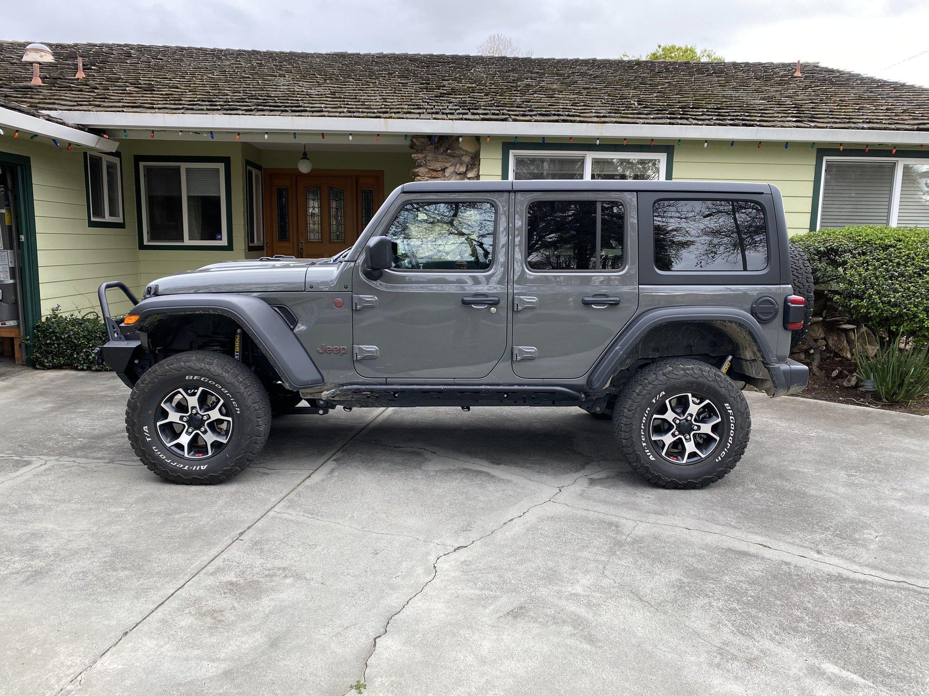

Yeah I am def on the light side right now and can feel it in the wind. Skids and bumpers still to come and will be interesting to see how much it drops. guessing 1/2"

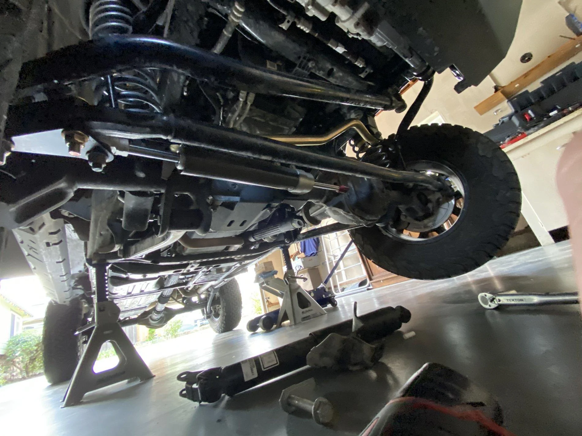

For curious minds I went with the following:
AEV 2.5" dualsport
Metalcloak front and rear adjustable track bars
Teraflex Falcon EF 2.2 Steering Stablizer
Here's some thoughts I have on everything
AEV lift
  • Fitment: 6/10
  • My axles were indeed off center after the lift. Front more so than the rear (the rear track bar tower definitely got it close, it was off by a negligible amount), the adjustable front track bar was definitely needed while the rear was purely a nice to have for my OCD and no normal person would have noticed.
  • The rear tower bracket was a PITA to get on and definitely needed some hammer "persuasion" to fit. Hard to tell if this was a fitment issue on Jeep's end of AEV's.
  • When you bend the front control arm brake line brackets per their instructions (for additional cable clearance) it induces a severe bend in the brake line. I opted to just remove both brackets entirely for A) more clearance at full droop and B) to eliminate the kink C) get rid of the potential trail snag entirely without cutting.
  • While there aren't any clearance issues with the driveshaft (especially after swapping the upper control arms left to right) I think I'm still going to get an aftermarket driveshaft for peace of mind and improved driveshaft geometry down there.
  • The ride is not nearly as harsh as others make it sound. I was previously running 34 PSI all around and running 30-32 all around now feels largely the same. But I also was previously in a JK with the AEV 2.5 and a TJ prior, so I'm not transitioning from something smoother.
  • Overall I remember the JK being a far smoother install.
  • Quality: 8/10
  • The nylon material for the bump stops/sway bar bracket extensions are still an odd choice and make torquing them to spec difficult without just eyeballing the material before it deforms too much.
  • While I have my gripes, I'm overall happy with the lift considering the price and ride quality.
Metalcloak Adjustable Track Bars
  • Fitment: 9/10
  • They're adjustable, they fit great. Front does require the expected grinding a the axle side mount.
  • Quality: 10/10
  • As always great quality from these folks, I don't love gold but I do love the zinc coating from a rust perspective; especially after trail rash happens. The quality and easy service on the Durotrak bushing has me leaning heavily toward Metalcloak over Synergy/Steersmarts for upgrading the tie-rod and drag link prior to 35s. Synergy and Steersmarts make awesome solutions but the price and particularly end link replacement prices are a bit steep for me. Plus I live in northern CA and can get replacement parts from Metalcloak rapidly within 1-2 days.
  • This forum has many strongly held opinions on steering stabilizers, some that are well informed and others that are less so. But a steering stabilizer has a few jobs, the biggest being to reduce negative feedback to the steering wheel, something I noticed an increase of post lift. I wasn't looking to correct steering, correct pull or fix death wobble (we hopefully all know for the most part a stabilizer is generally a mask for these areas); what I wanted to do was simply dampen the increased negative feedback caused by my new geometry.
  • Fitment and Install: 10/10
  • Install was less than 30 minutes. It probably took more time to get the frame on on jack stands than to actually install. No fit issues
  • Quality: 10/10
  • The Teraflex Falcon EF 2.2 is very well made and a simple yet effective bolt on solution. The different settings are very noticeable and I feel I'll find a lot of value for the "soft" setting on the trail. Otherwise the "medium" setting was an immediate game changer and an improvement over stock pre lift (I personally think the stock stabilizer is more than fine for a stock JL). A side effect to the through body equal force design (EF) is that it's always neutral force, unlike other aftermarket stabilizers that have been seen to cause pull with pressure in the valve being greater at one end than the other. While the stock steering linkage is likely inadequate for more rotational mass on the wheels/tires and a lift I did see an immediate improvement to steering wander and had to baby sit the steering wheel for micro adjustments far less on even the medium setting, while firm kept me firmly planted on the highway.
And as a final note on steering, while I currently don't see much if any flex of the sector shaft near the frame side track bar mount I am also going to install the Synergy sector shaft/track bar brace to prevent this before install 35s.

Hi Thinman.
How much actual lift did you get on that 2.5" MC lift on your Rubicon?
Which shocks did you get, and how is the ride quality compared to the stock Rubi? Is it firmer, softer, the same? I want a lift with a slightly softer ride than stock, more absorbent over bumps but not sloppy.
Did you do the tie rod and drag link, and are you happy with that?

I couldn't find my post on the effective ride height gained by the lift. I do recall it was right inline with what others have seen from their MC 2.5 though.
No data on the stock ride. I drove it straight to Metal Cloak for the lift. Absolutely do the TR and DL. Mine actually drove like crap at first, more likely due to poor alignment by the tech, but the TR & DL made a noticeable difference in stability either way.
