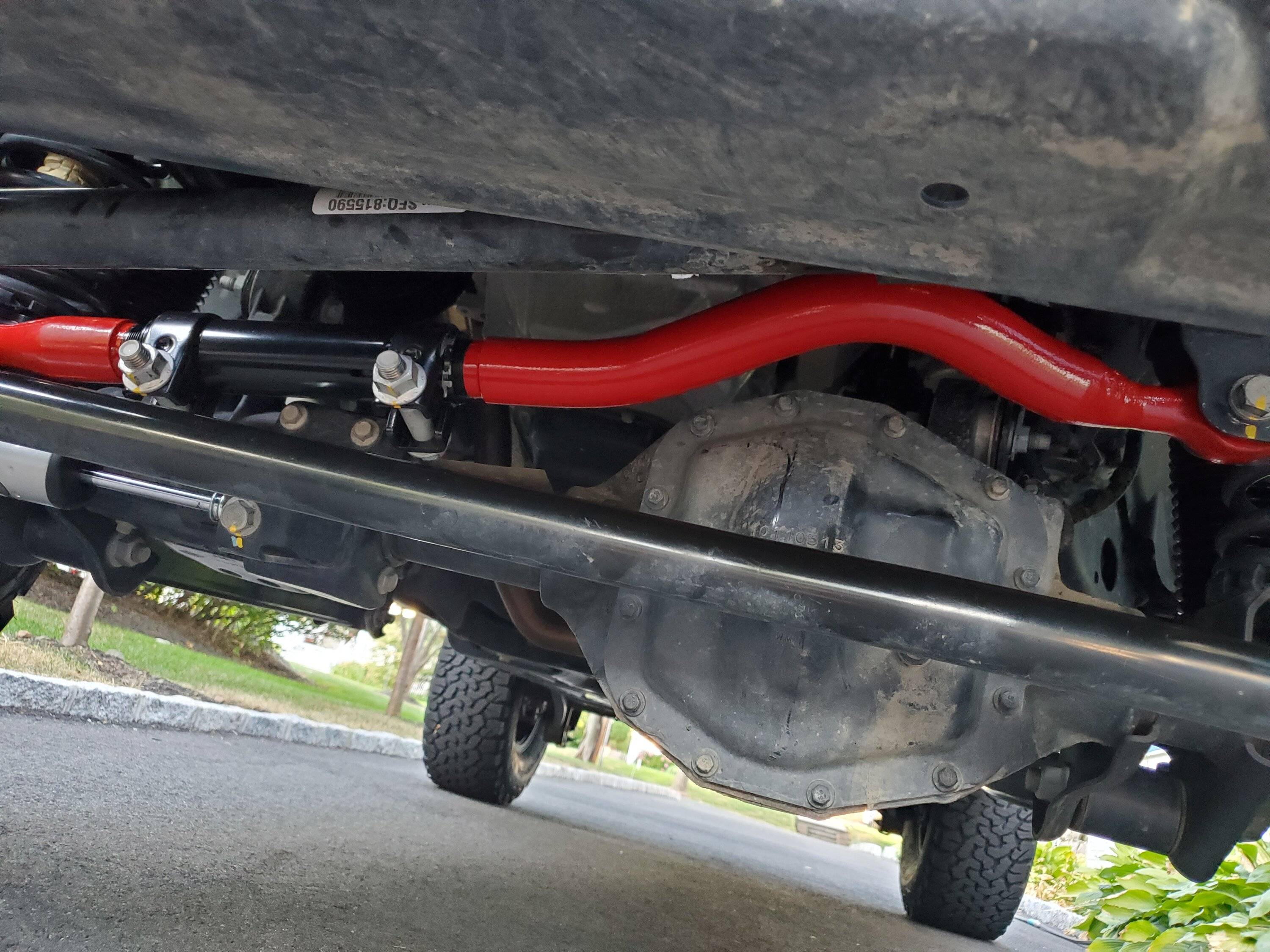

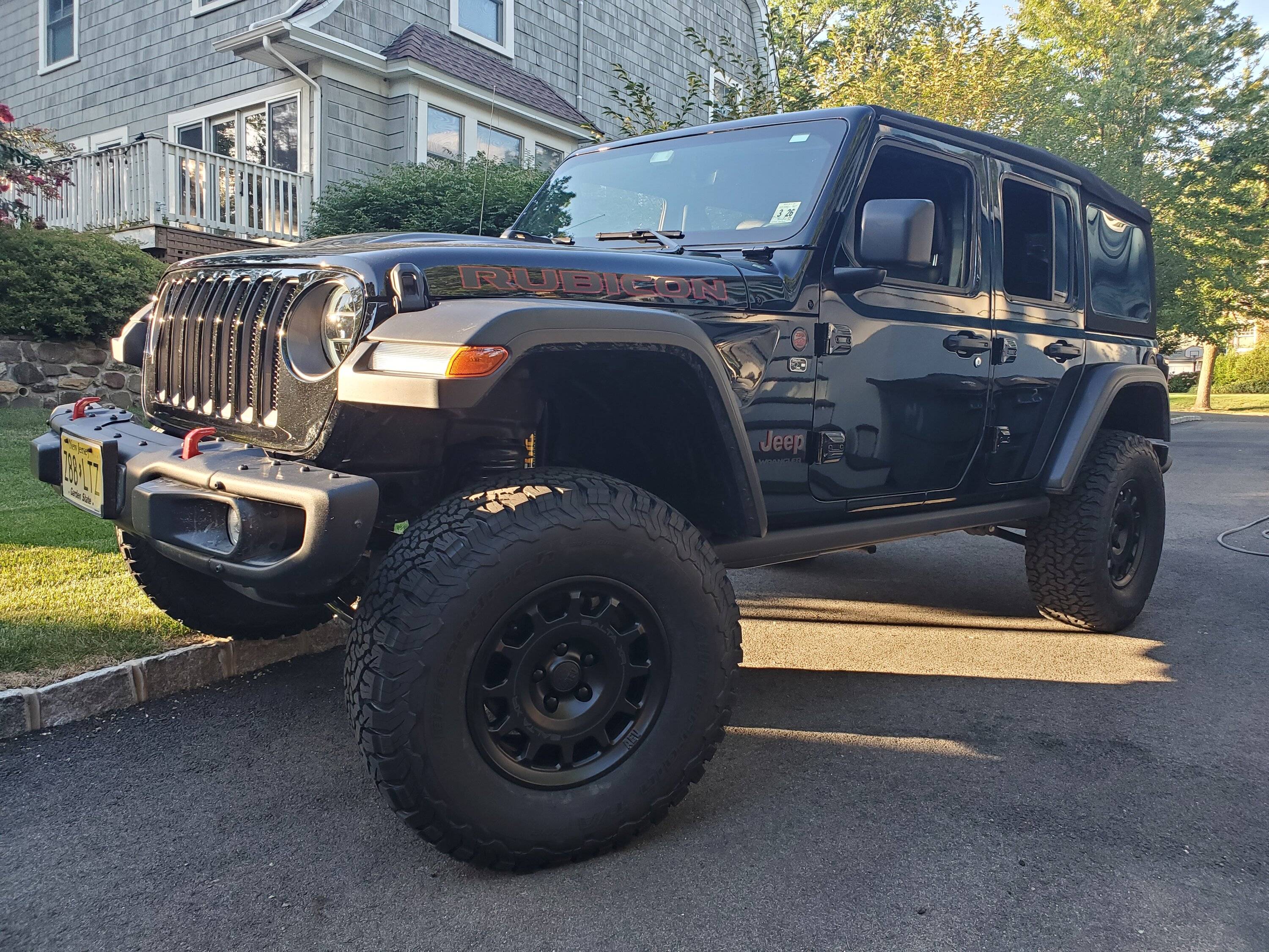

I cannot comment if your current wheel/tire setup will clear the rear endlink. But I can say that the AEV Dualsport lift will provide a lot of height. I just went and measured the height of my lift using the measuring points shown below and its 14.5". My jeep is light, with plastic side steps/rear bumper/ steel front bumper/soft top.

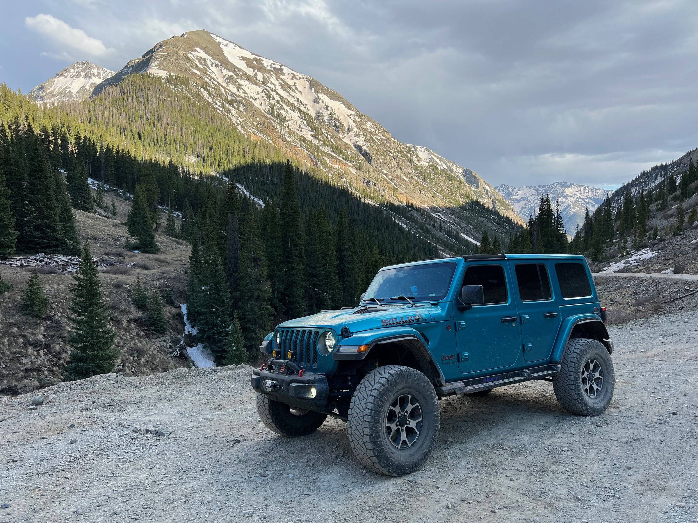

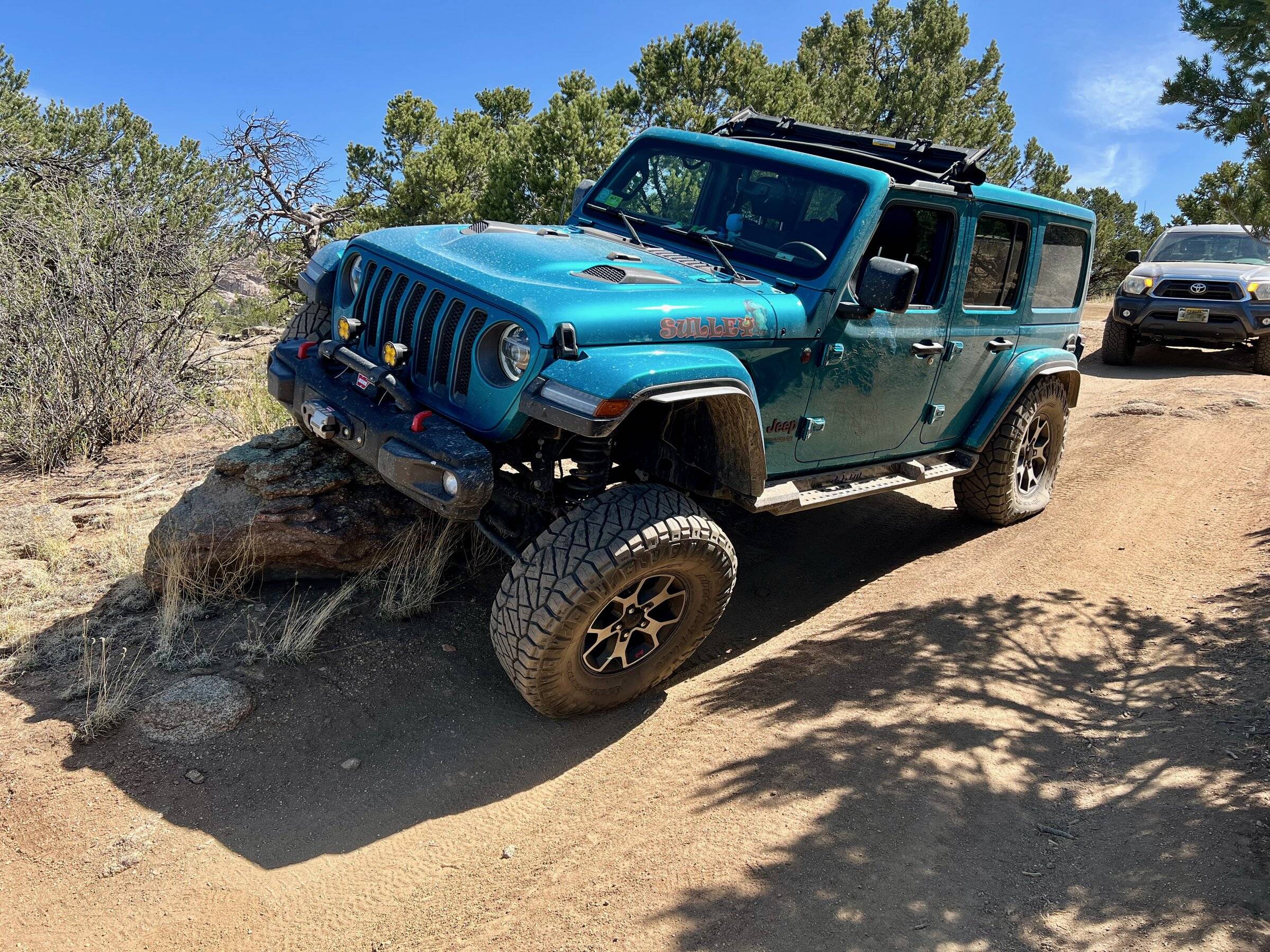

This is Sulley with the AEV 2.5 on Nitto 37's after 2 years of driving, he's pretty loaded for a 2 week camping trip in these photos. Have 1.75" spacers on the wheels and haven't had any rubbing issues. I think this lift drives great, he's my daily driver and I've taken him on long road trips with light and heavy loads. Have to say I love it!
Also he fits in my garage even with the Sunrider open and I have a standard 82.5" garage door.

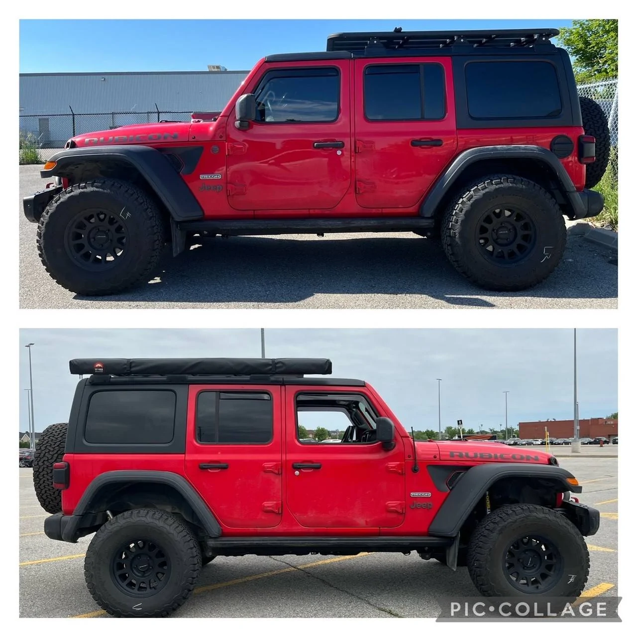

So I've put about 500km since I installed the AEV 2.5 RT, including this weekend fully loaded with a 160lbs RTT with at least another 350lb of gear/passenger. It sagged by about 1", which is way less than the OEM springs, so it definitely well-suited for carrying gear. It drove amazing...tracked straight, stable, absorbs bumps well and comfortable overall.

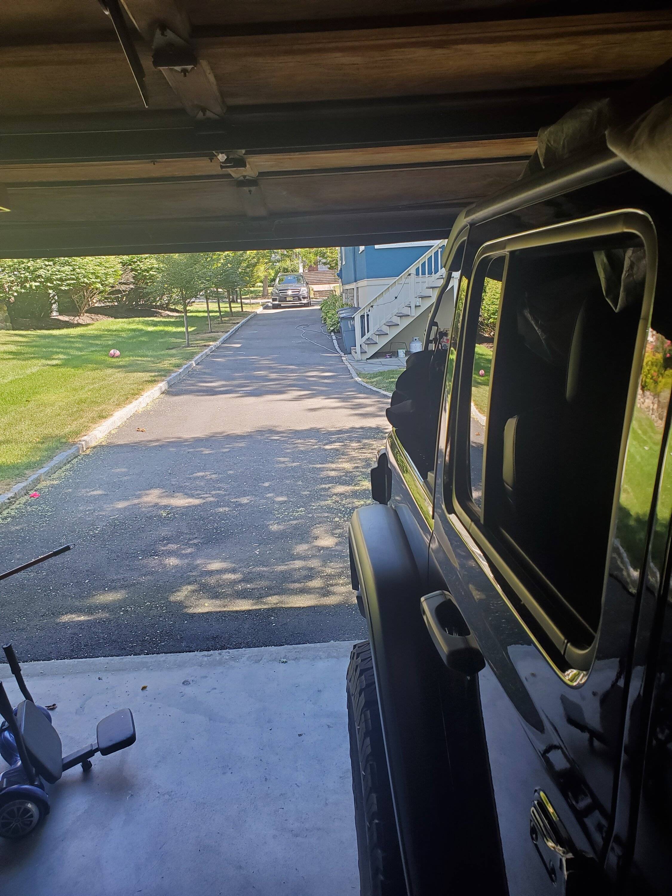

Pic inside my garage. Just fits

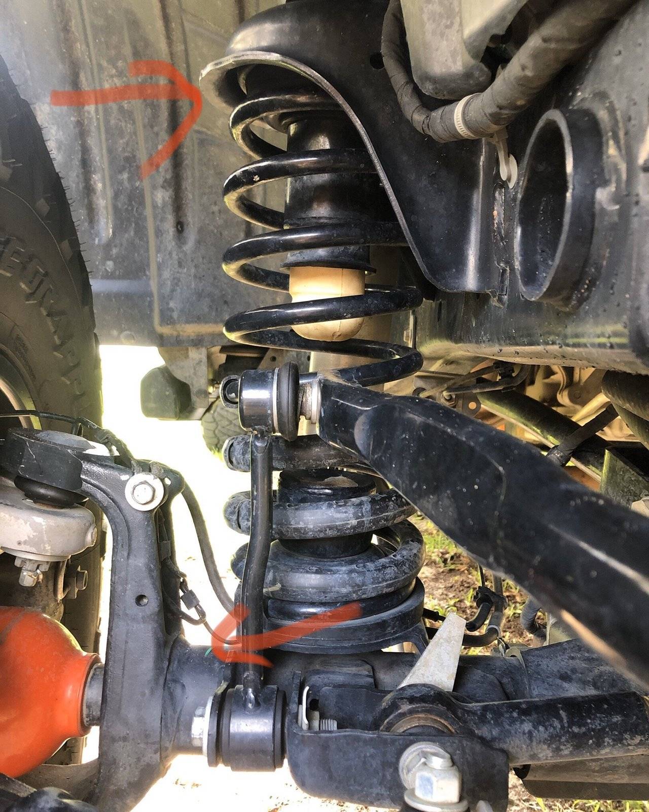

Did install Yeti HD trackball to correct front axle off center
Jeep Wrangler JL AEV 2.5" 20220812_190007
Here you can see how the geometry correction brackets really do keep the lower control arms close to parallel despite gaining about 3.5 inches

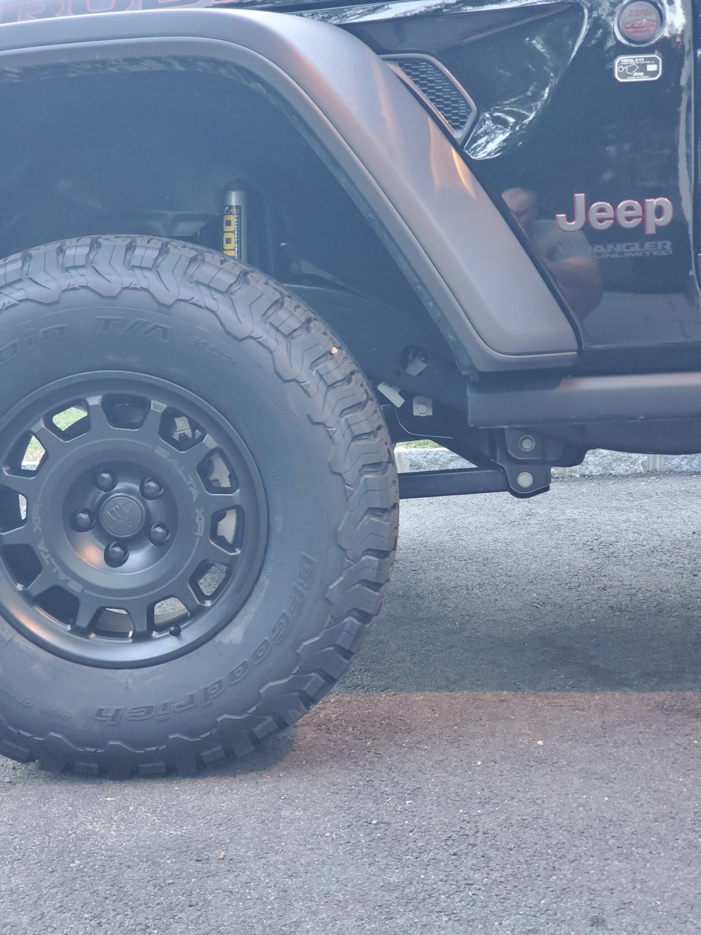

Will report back when I get the front bumper installed and winch in September in terms of ride and height. Should mention have rear bumper and tire carrier that added weight and think helped smooth out the ride
