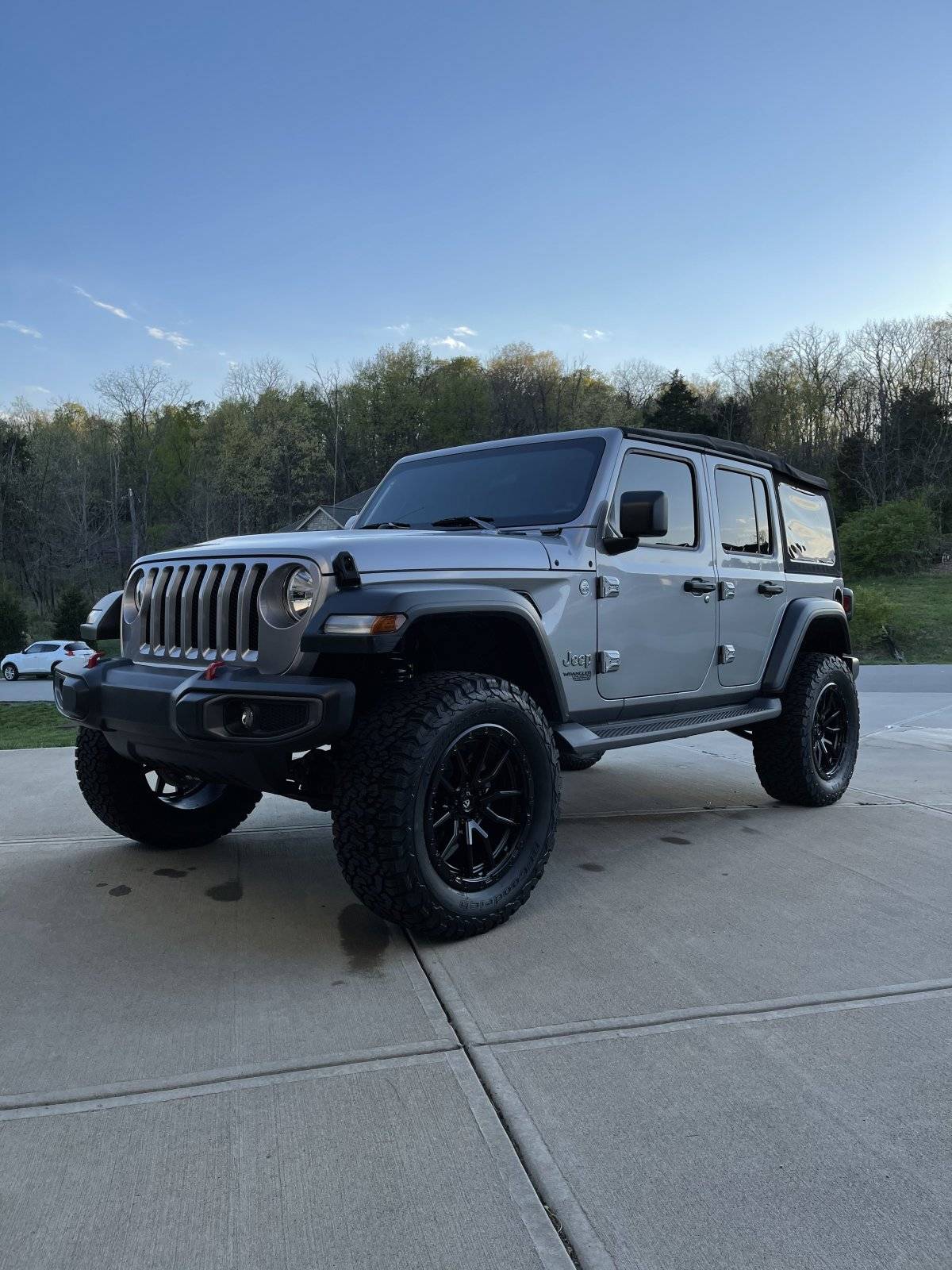

I Installed the AEV Dualsport 2.5 lift last weekend on my 2018 JLU Sport. Considering this is the first time installing a lift (previous cars were lowered with coil overs) installation was straight forward and I did not have any issues. I am really happy with the ride, handling, of the AEV lift. I do have a Clayton front track bar ordered to re-center the front axle.
Thanks to everyone who has participated in this thread, it really helped with my decision on which lift to purchase.
Wheels and tires are 20x9 +1 Fuel Rebel 5 and 35x12.5x20 BFG KO2 wheels.

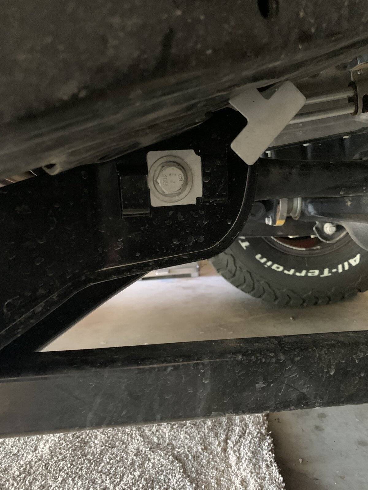

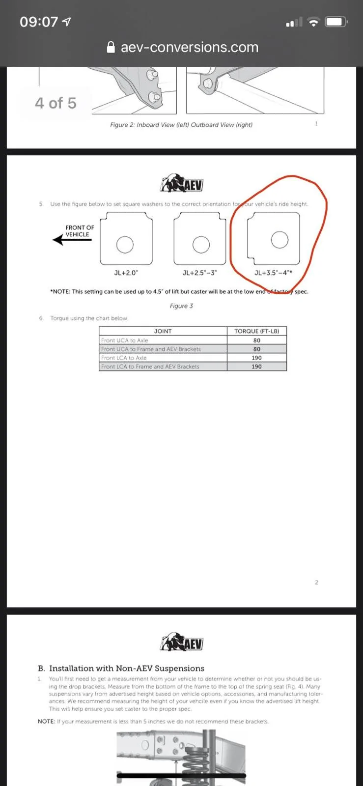

So after installing this lift, my caster is very low (4.1) per the alignment shop. I just want to make sure I have the caster plates in right. I set them for the highest lift. Which should give me the most caster right? I did order the mopar lift LCAs, so maybe that will help once I get them on.

Haven’t read much on this lift and trying to see what the orientation of washer does to the UCA. Does that position pull UCA more to rear of vehicle or push it more forward? If pushing forward will definitely give you less caster.
I believe it pulls it more rearward.

I have my washer set to the 2.5-3 inch lift. I won’t know if this is enough or not until my alignment scheduled late May.
My longer LCAs arrive tomorrow and I will get them on next week. Thanks for your reply. I will post back when I get them on and get an alignment !

Mopar lift LCAs brought caster to 5.5. Handles much better.
