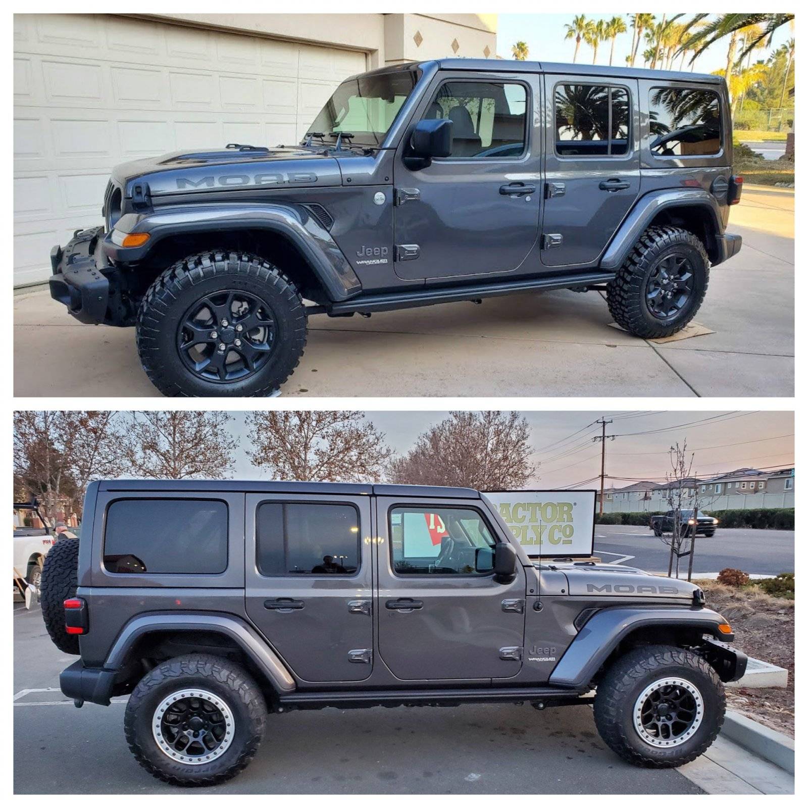

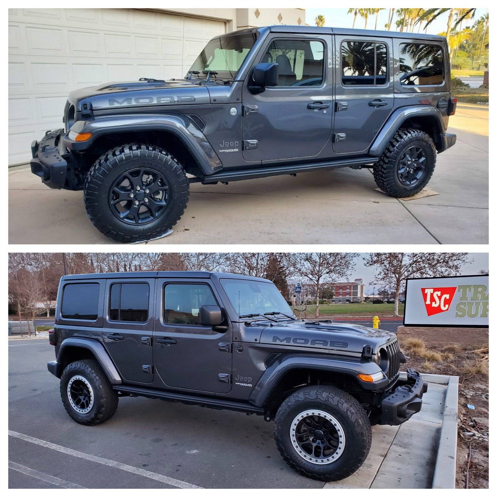

I went with the AEV 2” body lift and AEV geometry correction brackets. Since the MOAB comes with a rubicon suspension I wanted to leave the suspension but gain the lift. I am 100 percent happy with it. (Before/After Picts below).

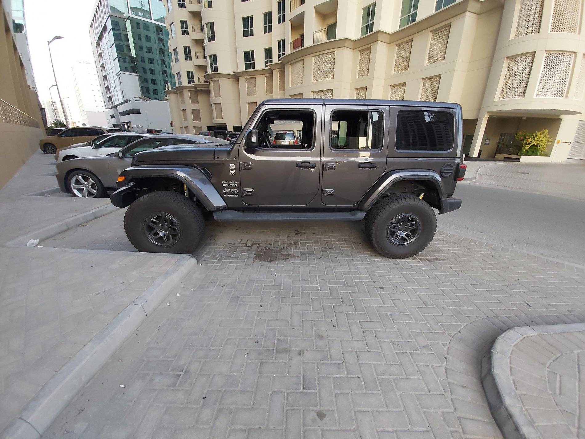

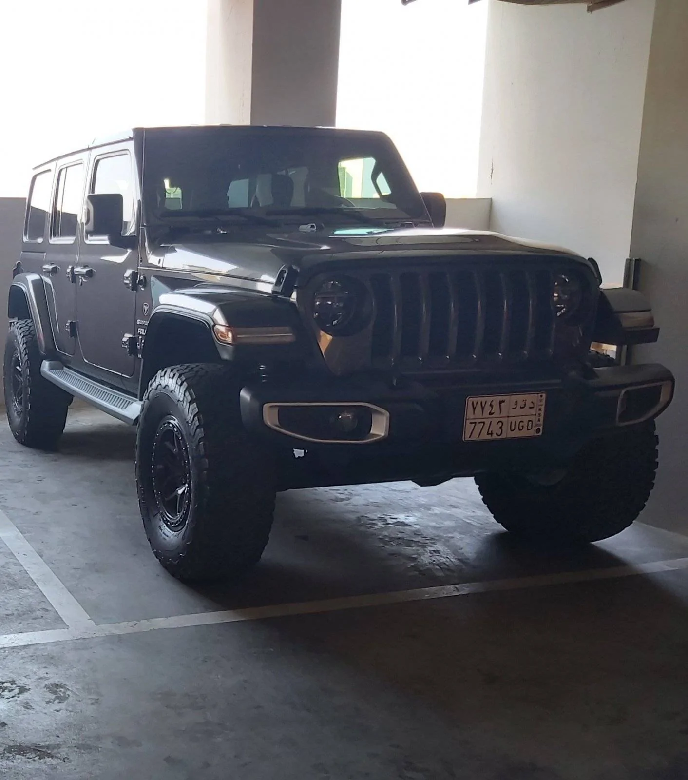

Well it is amazing the RT kit but you need proffessional installation so that your acle doesnot shift to the left ..285 will be small for the lift kit .

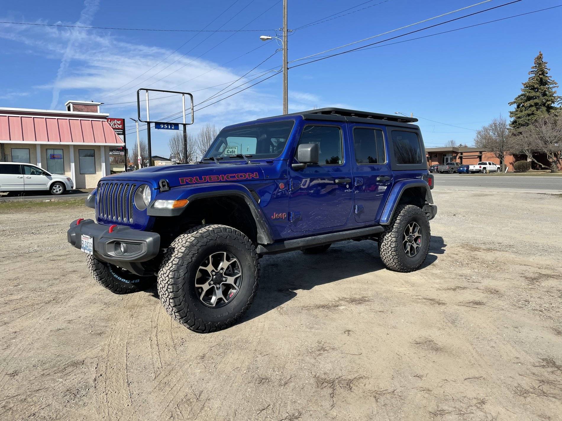

Had the 2.5 inch dualsport and JKS adjustable front track bar installed last week by a local 4x4 shop (yes the shame on me not doing it).
Shop was impressed by the quality of the components. Without added weight it certainly nets more along 3"-3.5" of actual lift versus the advertised 2.5". I'm running stock wheels (no spacers) with 35x12.5 KO2s. I have no issues with rubbing under articulation or at full lock.
Overall pretty happy with the lift so far.

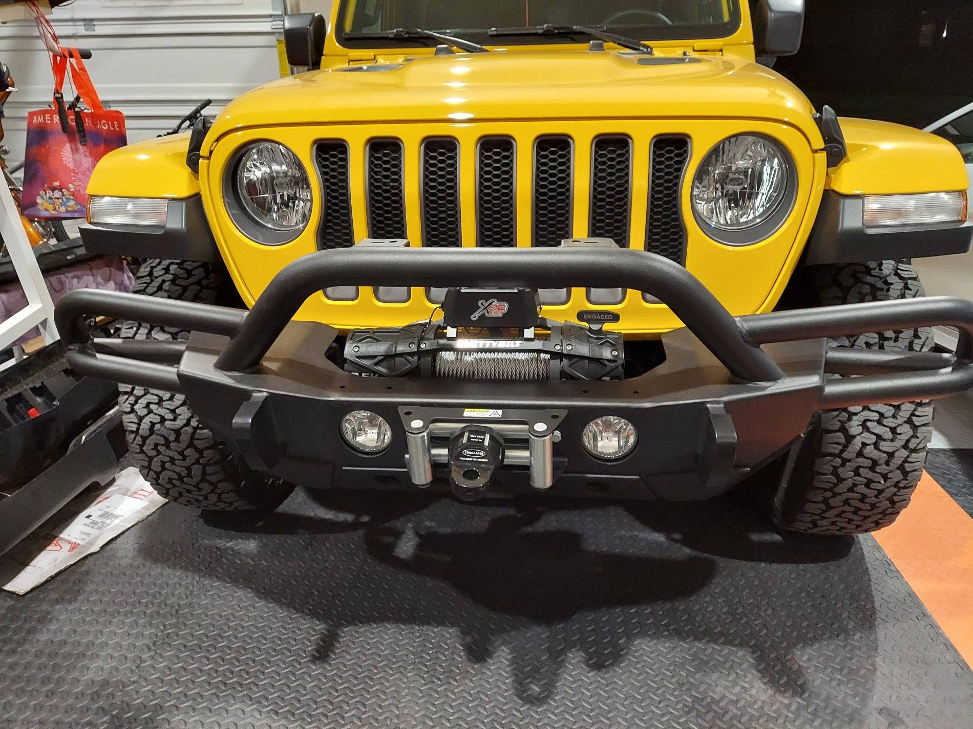

I have purchased the AEV 2.5 Dual Sport kit. We just bought this 21 JLUR and it is my 8th Jeep. I have owned a 84 CJ7 Renegade, 88 YJ Wrangler Sport, 89 YJ Wrangler Sahara, 92 YJ Wrangler Sport, (all bought new).
01 TJ Wrangler Sahara, 89 Wrangler TJ (project), 14 JK Wrangler Sport, 21 JKUR Wrangler.
I bought this 21 JKU in Feb and have installed the following:
SmittyBilt Rock Slider / Steps
SmittyBilt SRC Gen 2 Front and Rear Bumpers
SmittyBilt SRC Gen 3 9.5K Winch
Within a few days I will install the AEV lift, 17 x 9 Fuel Assaults, 35x12.50 Nitto Trail Grapplers and update the thread with some photos and remarks.
I enjoyed reading all the comments on the lift so far.

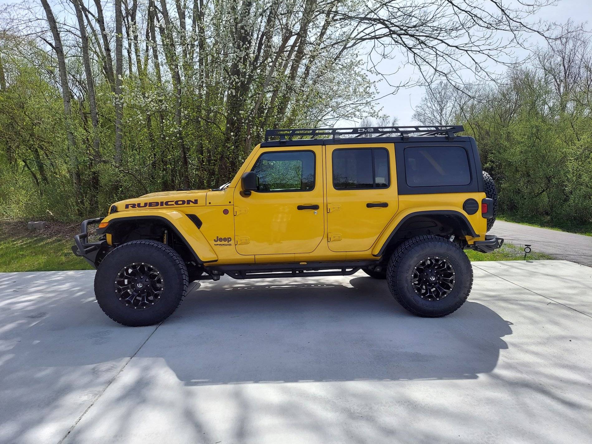

I installed the AEV 2.5 DS lift last week along with a DV8 Roof Rack. The install was easy and the ride is very firm, but I'm OK with that. Since the install I drove the JL from TN to NV with no problems. The gas mileage suffers a bit over 60 MPH. I may re-gear while I'm in California on a work trip.

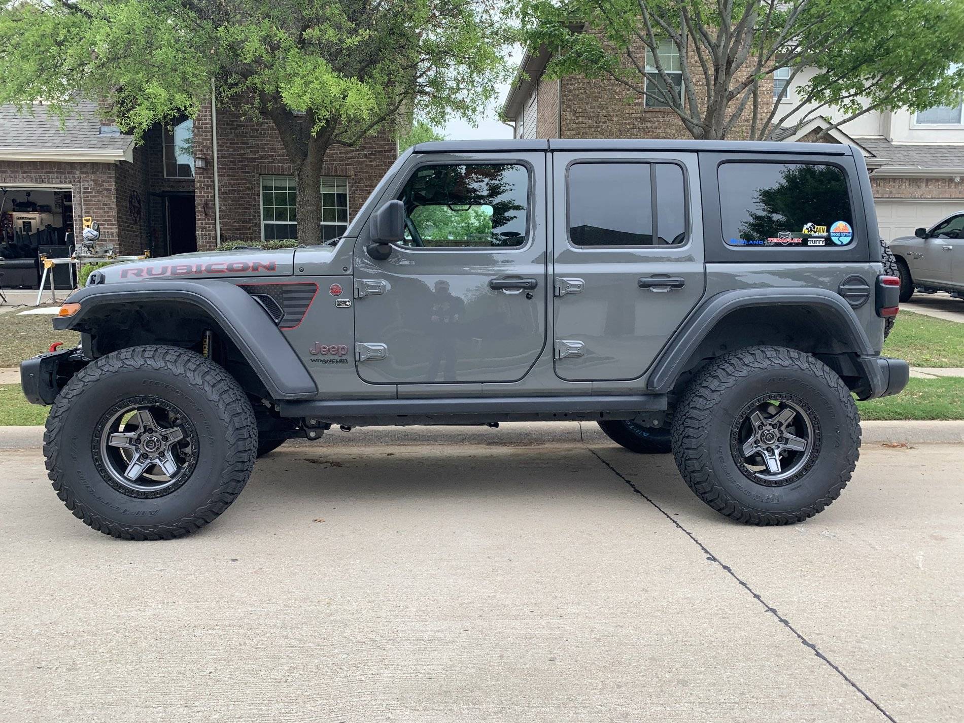

I installed the 2.5 AEV Dualsport lift last weekend. Fuel Kicker 5s with 37 KO2s. Definitley not a 5-6 hour job per instructions, but I did it myself. Ride: seems a little floaty, but that might just be a result of a lifted jeep. Soaks up bumps way better than the stock suspension. Overall I am happy with it!

Love the wheels. Ordered the same to go with 35” Ridge Grapplers.
