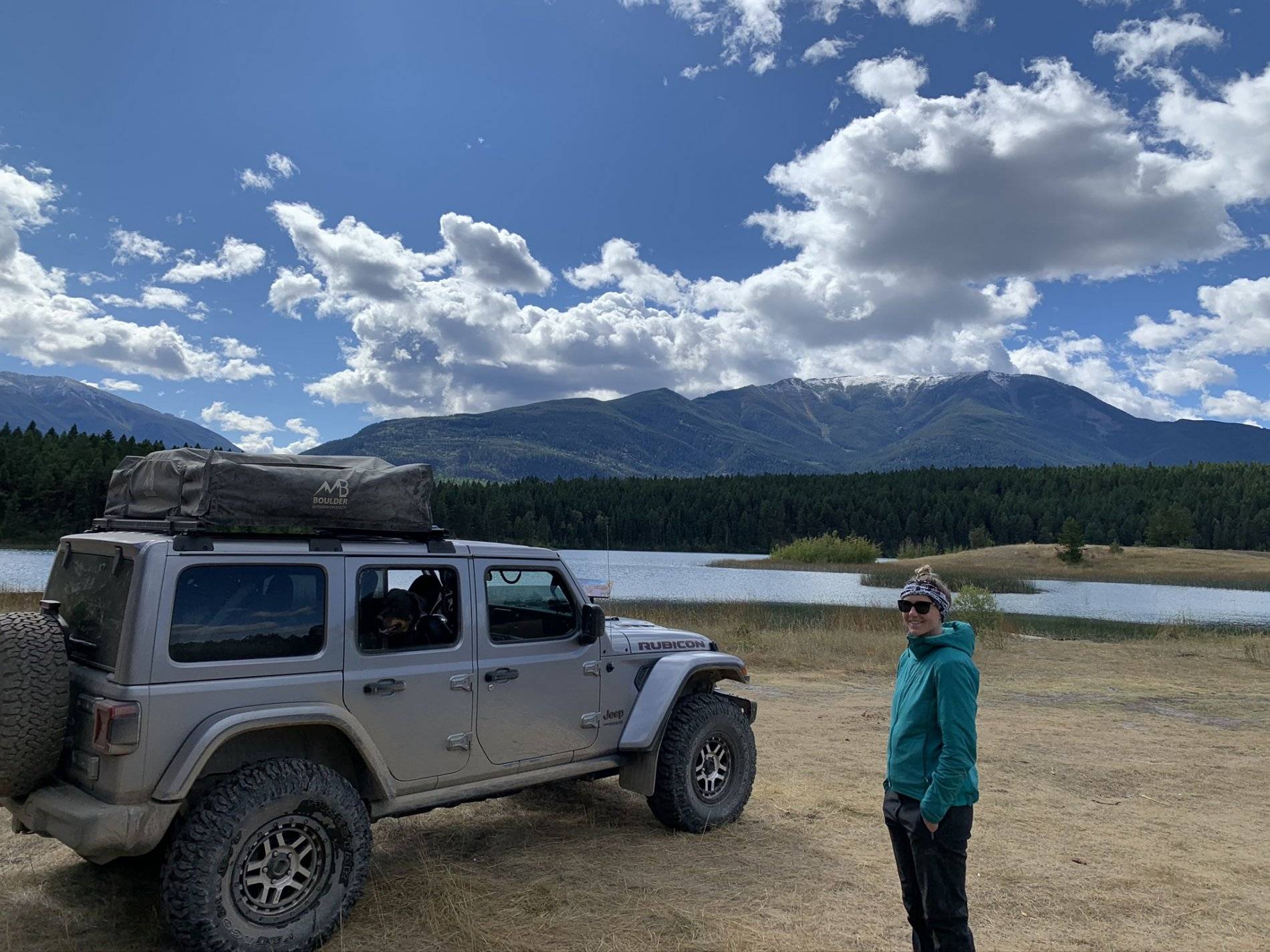

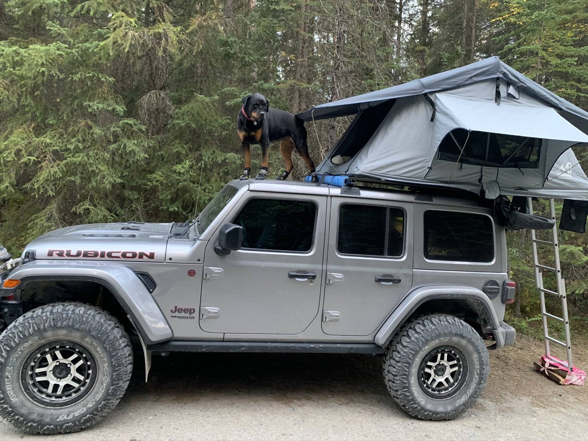

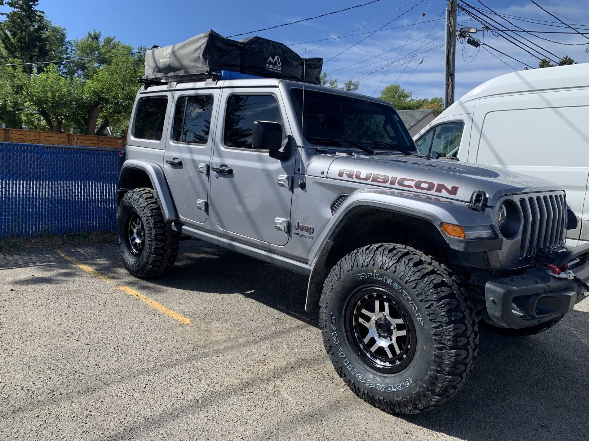

I have the AEV kit installed. One thing I will say is that the sway bar end links are nothing special. They're the cheapest looking thing in the kit and their bolts have rusted and look shoddy after less than a year.
Overall, very happy with the kit. I recently removed all the correction brackets and installed proper adjustable trackbars and control arms. The front correction brackets certainly create a low point on the underside of the jeep (would be easy to get stuck on a rock in a breakover situation).
I also got rid of the procal snap thing. It seemed gimmicky to me the way it worked. I bought a special app and ODB sensor instead.
I'd say that I got more than 2.5" lift and have been running Patagonia MT 37s with no issue. It certainly looked silly with the stock 33s.
For anyone buying this kit, be careful when installing as some of the stock bolts were "fine thread" and the aftermarket bolts were "coarse thread"... or vice versa. Specifically on the sway bar end links. That really screwed us over when I didn't realize it and stripped a bolt or nut. Anyway, be diligent with where bolts came from and whether you're supposed to reuse them.
