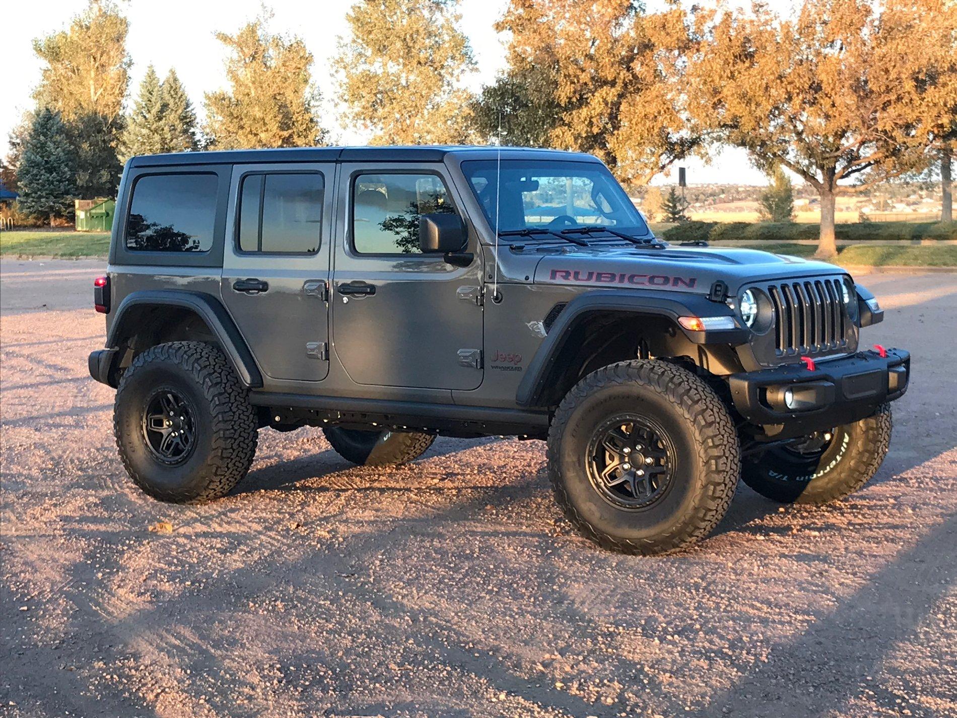

Lift is great. Ride is a touch stiffer than stock but still rides smooth. Can’t get the procal to work though. Very happy with the AEV Borah wheels. Needed tires that preform in snow and ice so went with 37” KO2, which measure about 35.5”. Very little loss of power with the larger tires. No complaints.
That looks great! What color are those Borahs? Onyx, satin or galaxy black?

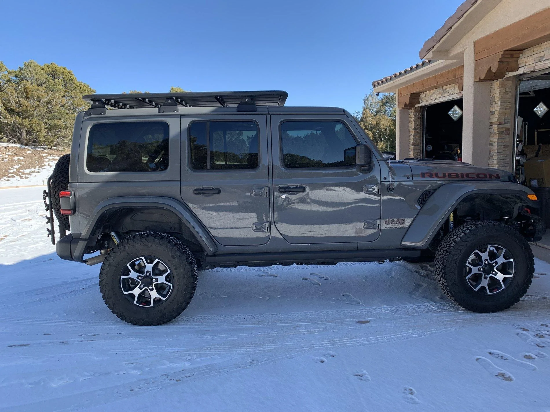

Thanks all. I haven't swapped tires yet, still running the stock wheels and BFGs. I'll post a response once aligned just to give other folks the heads up. Here are the before and after pictures btw. I'm measuring 4.25" lift in the rear and 3" in the front. Wondering if it will settle (hoping).
Jeep Wrangler JL AEV 2.5" IMG-0507
Jeep Wrangler JL AEV 2.5" IMG-0740
The alignment should fix it. This is a pretty common problem if you do the lift yourself and don't know to adjust the drag link (at least until final alignment can be done). Just note that once the alignment is complete, you will have to drive around for a little bit until all of the errors clear.
That's a lot of extra lift. Looks like it's time for a winch, tire carrier, heavier tiers, and HD step sliders to weigh it all down. LOL. ;)
I actually have a 12000lb winch on it and am guessing that’s why I’m getting only 3” in the front.
Wow. Then that's a lot of lift. Fingers crossed that it settles a bit for you. Looks good though. Have fun!

Update: Alignment fixed both lights as folks here stated. I let the pros at Firestone do the honors, plus they were running a lifetime alignment special on new years day for 50% off. Thanks for the help with this. So far, loving the lift.
