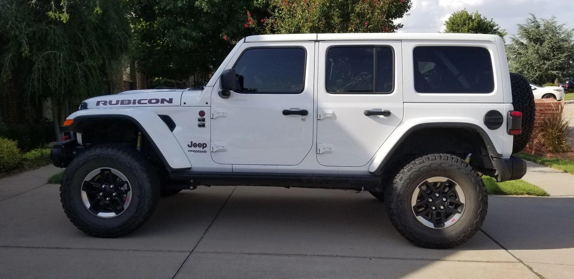

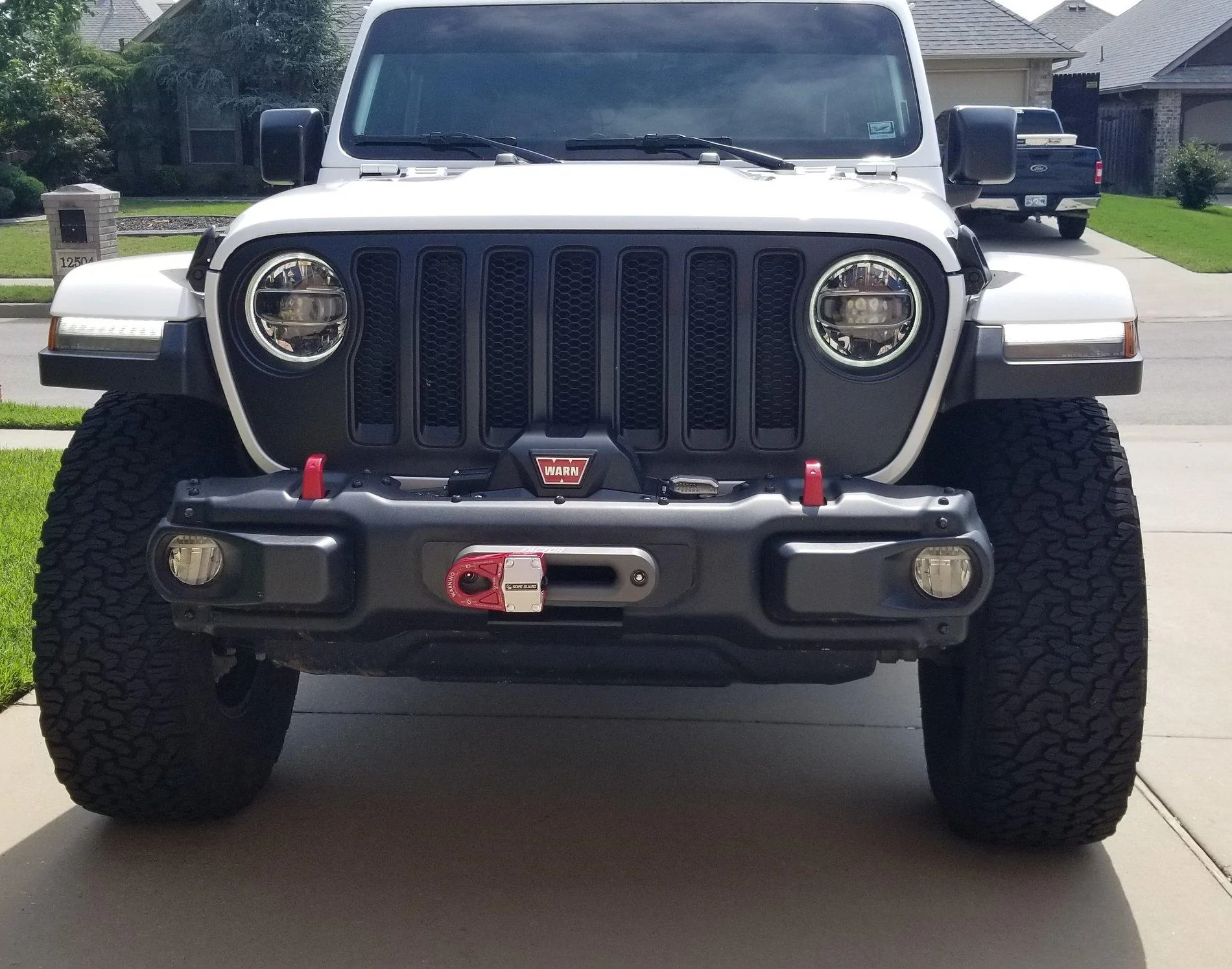

AEV 2.5 inch lift kit is installed on my 2018 JLU Rubicon with 315 BFG KO2. Reason for lift was with 315s I was getting some rubbing at full articulation.
On the front I went from ~39 3/4 inches to the bottom of the fender to ~42 3/4 inches. On the back I went from ~38 3/4 inches to ~42 3/4 inches. So plus 3 in the front and 4 in the back. Hopefully that will settle a little, but kind of what I expected since no vendor appears to be able to accurately estimate actual lift sizes anymore.
After a 15 minute test drive seems to handle/feel fairly close to before, but definitely leans on the more stiff side and feeling more of the bumps.
I will say that adding a new adjustable teraflex trackbar does make the steering feel a lot tighter (slop of no response on either side of center is definitely reduced from stock).

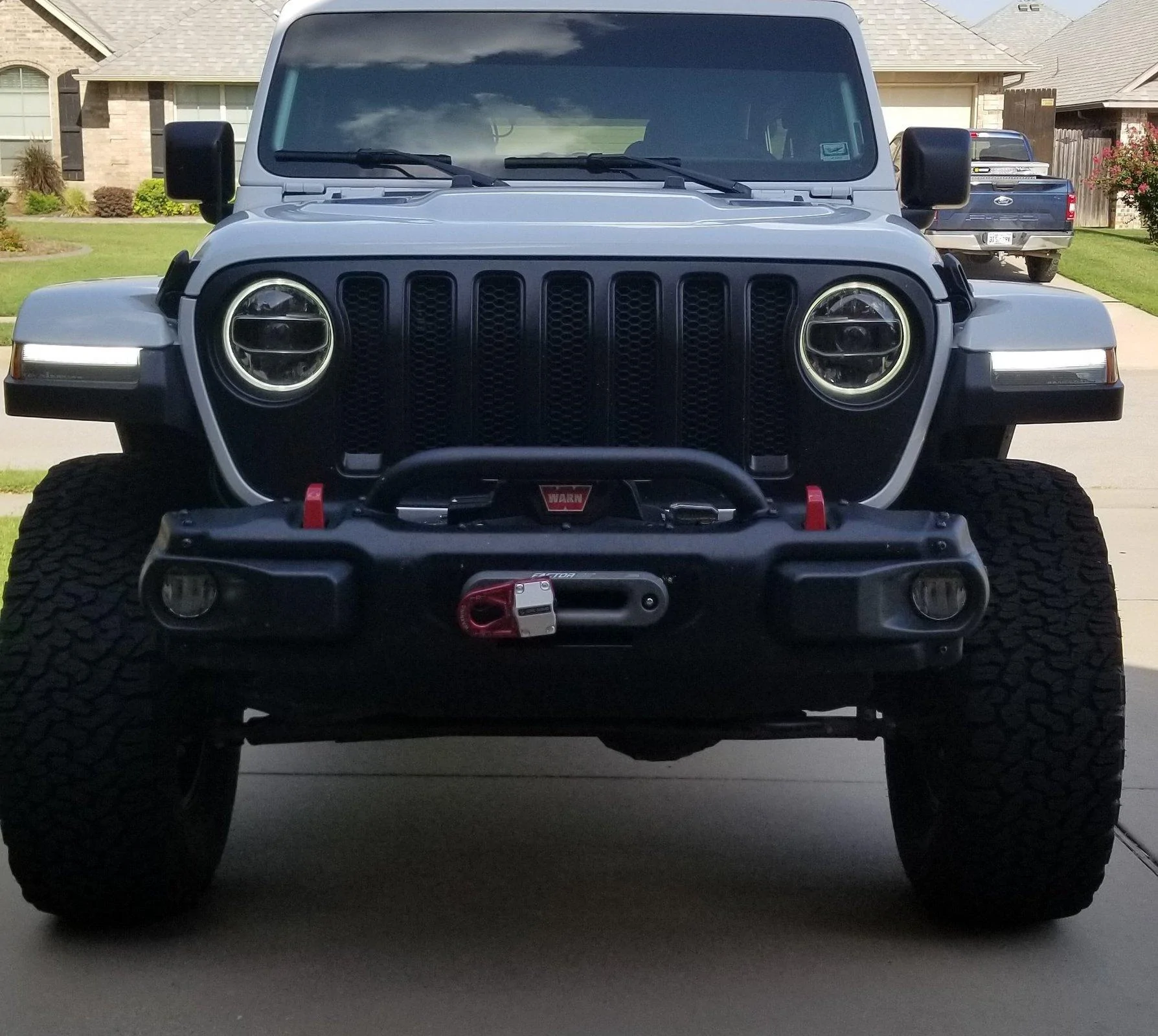

Curious. Are you saying that your front end was one inch higher than the rear from the factory?
Vermillion
Jun 28, 2018
38
40
Oklahoma City, OK
2018 JLU Rubicon
I can't say for sure that it came from the factory that way, all I can say that was the measurements before I added the lift (pictures to prove it). Are the fender heights in front and rear the same on a stock rubicon? I've had the jeep for about a year and a half, had it off road several times, but the only thing I've done that would have affected ride height to this point was when I went up to 315s. Hell, the jeep even had more weight in the front from stock as it has a Zeon 10s winch. So you got me on why it was taller in the front.
On an unrelated note, after my first drive I was afraid I made a mistake with the lift. But the more I drive it and play with the PSI, the more I like it. I'm pretty happy with it at this point.
