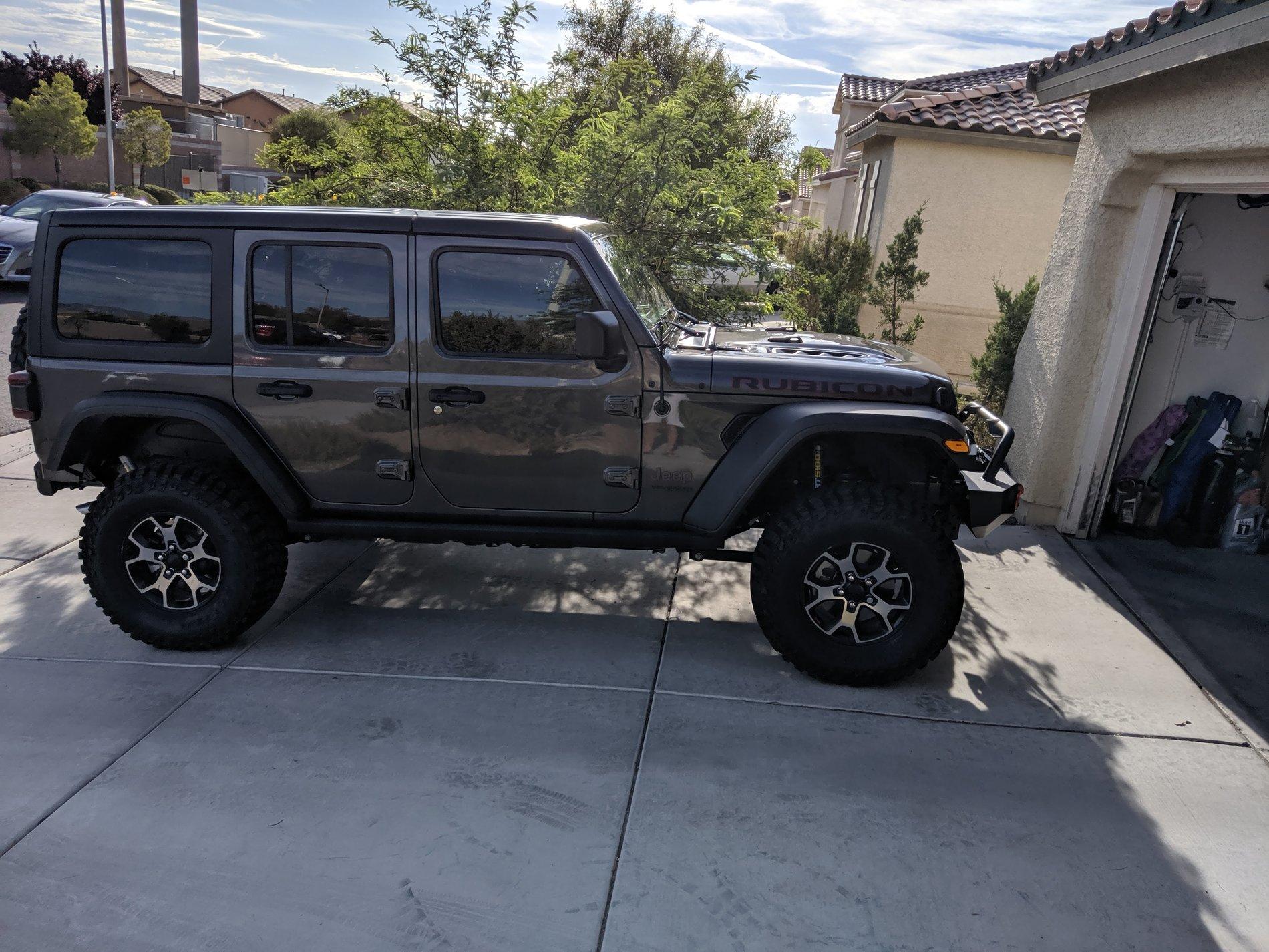

I looked around for awhile before finally deciding on this lift kit for my 2019 JL Rubicon.
The reasonable reviews, decent price and interesting options included were compelling,
but I think it was the Bilstein shocks that did it.
I always wanted to try Bilstein shocks on my dirt bike as a kid but I never got to...
*Installation*
With a bit of help from my 11 yr old son and much unsolicited help from my 3 yr old daughter, I took a weekend in the insane Las Vegas heat, and installed everything.
It went OK.
Most of the(wasted)time was spent tool juggling with the stock metric and the provided SAE hardware, and of course my little helper. (She loves the creeper).
The provided front sway bar end links were not going to fit. I had to use the longer stock rear end links, and even those were straining.
There is no included track bar or relocation system for the front, and this kit lifted my Jeep 3.5 inches exactly, measured from the ground to the frame.
*Result*
The 3.5" lift gave me a front axle offset of 1 full inch. I clearly needed an adjustable front track bar. The rear relocation bracket did not center my rear axle either, and it still has a 3\8" driver side bias.
The control arm relocation brackets seem to correct caster, but you lose most of the increased ground clearance right behind the front wheels. The rear bump stops are made out of plastic, and the instructions caution against over torquing.
That's fine except that the rear sway bar spacer blocks are made out of the same plastic, and it deforms at the recommended 50 ft. lbs. of torque. I used some blue loctite and was very careful, but I can't imagine they will hold up. I hope I'm wrong.
I called AEV tech support to see if I had missed something, especially with the axle shift.
I talked to someone named Patric. He said that they are installing these kits without upgrading stock track bars and I should send him some photos, which I promptly did. No response at all. It's been about 3 weeks...
So I ordered a Steersmarts track bar, waited a week for it to get here, installed it, centered my axle, and replaced the end links with the provided ones.
*Testing*
I aligned my front end, centered my steering and drove on the road for a few days.
It's driving well, it has less wander than stock, probably due to the caster and heavy duty track bar (not included).
I re-torqued everything (190 ft.lbs. is no joke, especially from your back, and I'm 6'4" 210 lbs, and very fit..)
and then headed out to the rocks.
It's OK.
The articulation seems reasonable even with the large front bump stops.
The rear is very harsh. An uneven fire-road results in bucking even at 10 mph. I expected (and wanted) stiffer suspension, but the rebound damping seems off.
This may be why AEV says this kit is for loaded vehicles (I have after-market steel front and rear bumpers, a winch, a 35" spare, tools and recovery gear, and usually 4 people so...) and they recommend 28 psi in the tires.
Maybe it will settle in...
I also installed 35" Cooper Discoverer STT Pros, so I was happy to have the ProCal SNAP! to reprogram the tire size.
The installation was a bit fussy, They recommend a dental pick to pop up the tabs on the OBDII connector, and you will need to use one, and possible destroy it, but it wired up fine. I plugged in the proCal SNAP! and nothing, no blinking light, nothing. I proceeded to undue, re-due, and continuity test for about an hour, no luck.
Called tech support. Don't remember who I talked to. He asked me to look at the ProCal SNAP! through the transparent back housing. He asked me if it was all white, I said yep. He put me on hold for a while. He came back and said no one is in the sales dept and they could send me a new one or he could tell me how to fix the one I have. He was doing a lot of sighing and seemed strangely embarrassed. I said OK lets fix it. He tells me to pop the plastic front cover off the transparent back and take the small circuit board and flip it front to back. I sat silently for a few seconds and said "really, wow".
He said "yeah". He mumbled something about a bad batch and I said "so we're good" He said "that should do it", I said OK thanks and went out to try it. It worked as expected. Funley enough, you can't alter the tire pressure warning that you'll get if you go to the recommended 28 psi, but I changed the tire size, and the speedo is accurate.
Recommended?
Even though I don't think that the performance is bad, I have to say no.
They have to know that this is a 3.5" lift.
This, along with the zero response tech support, plastic spacers, having to buy extra parts, and the ProCal SNAP! fiasco, I'm not really a satisfied customer.
I guess the plastic jack base is OK.
I know Rock Krawler has a strong presence here, but the crazy number of options threw me. I think I should have researched more...
Should I correct the rear axle? About 3\8" off. It seems to drive OK. Any thoughts would be appreciated.

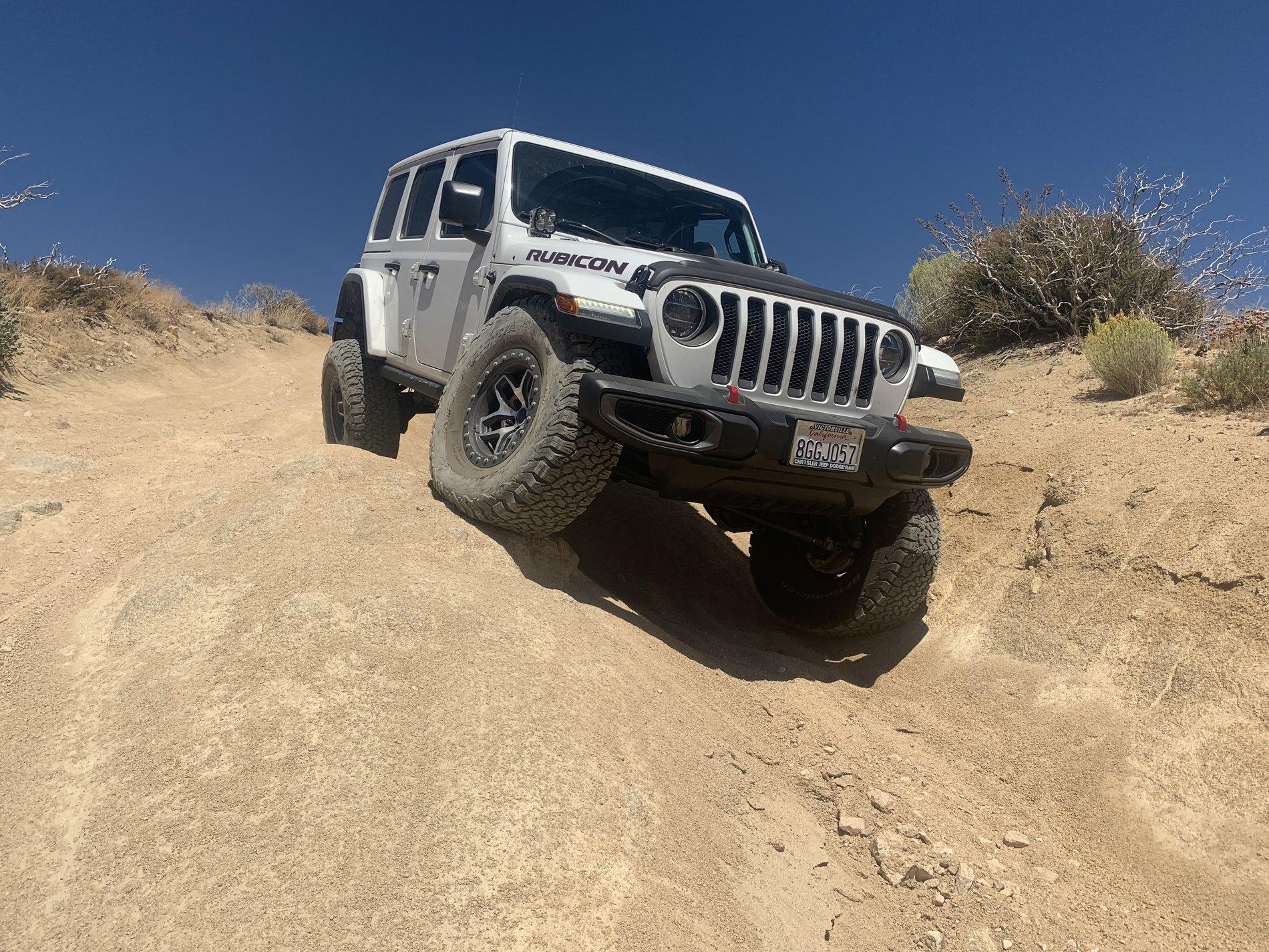

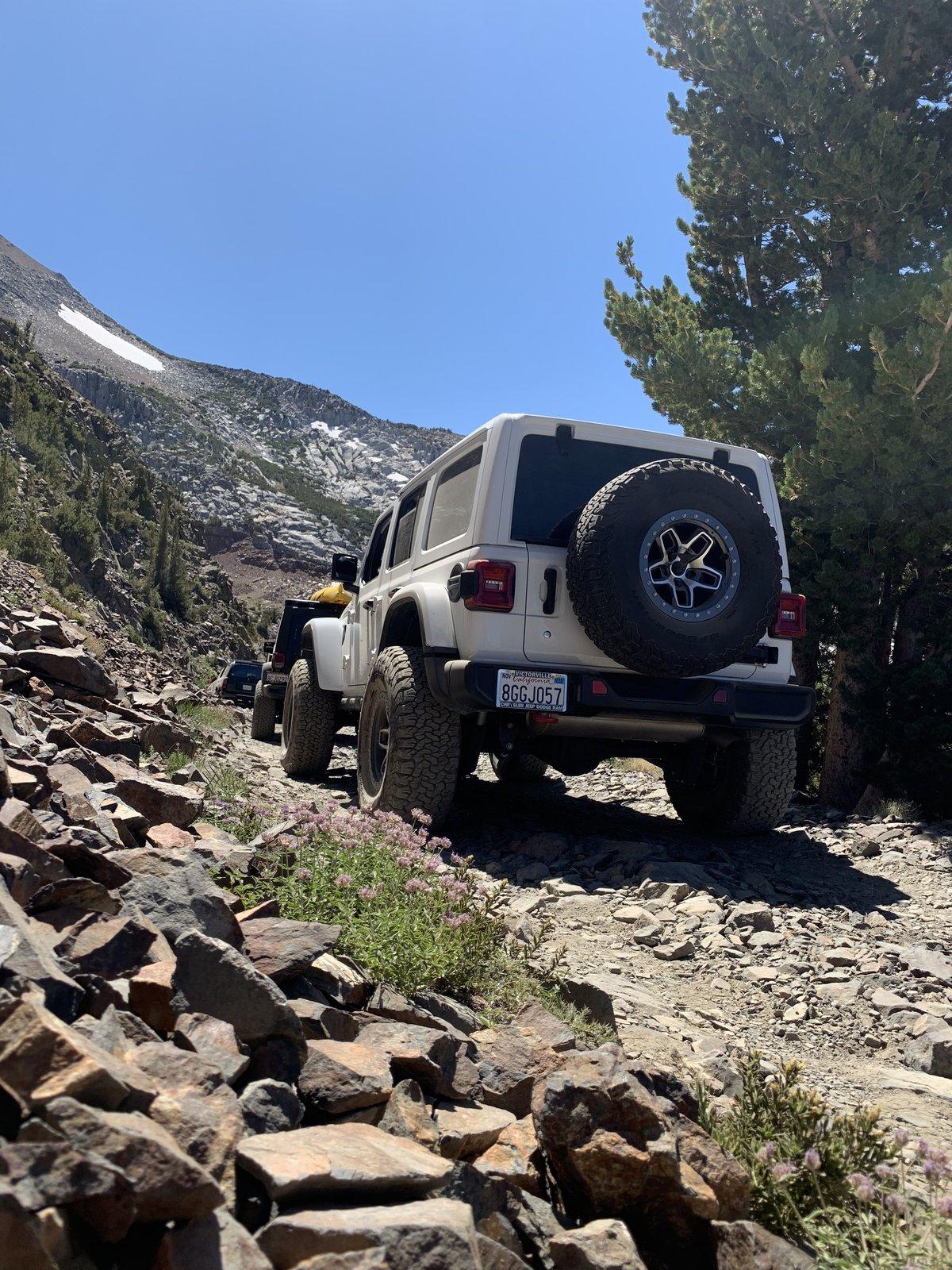

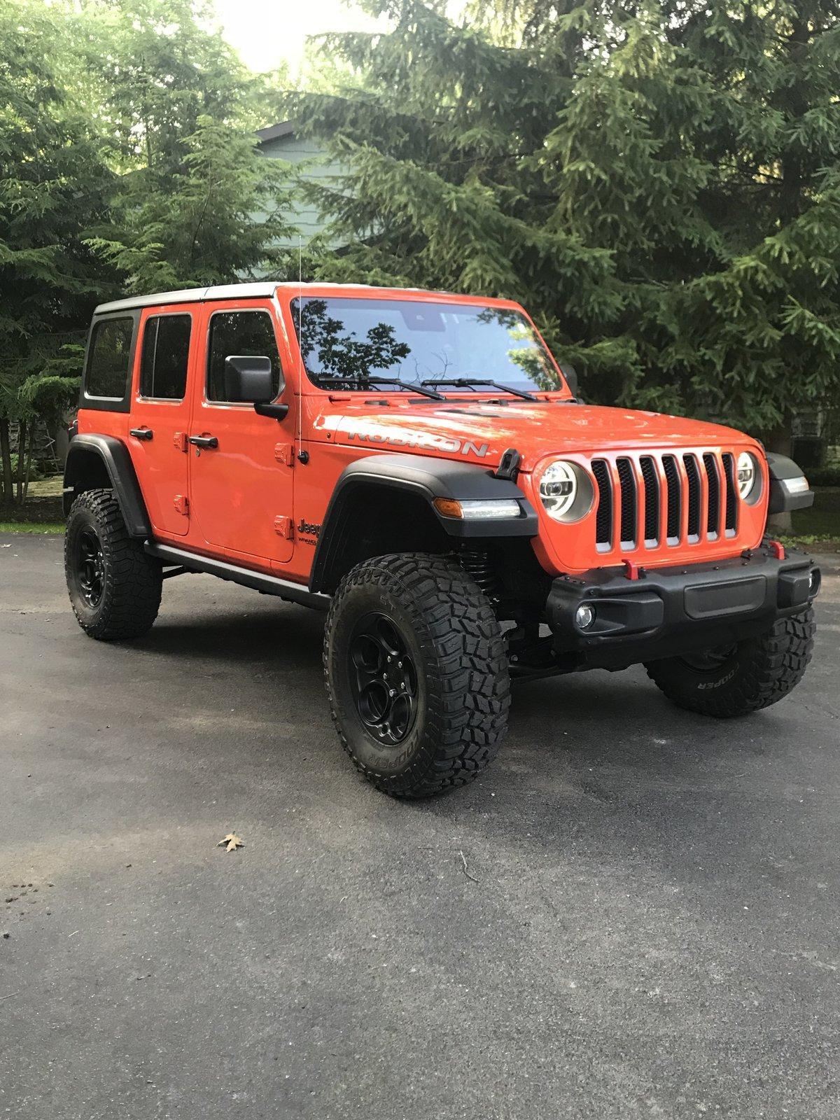

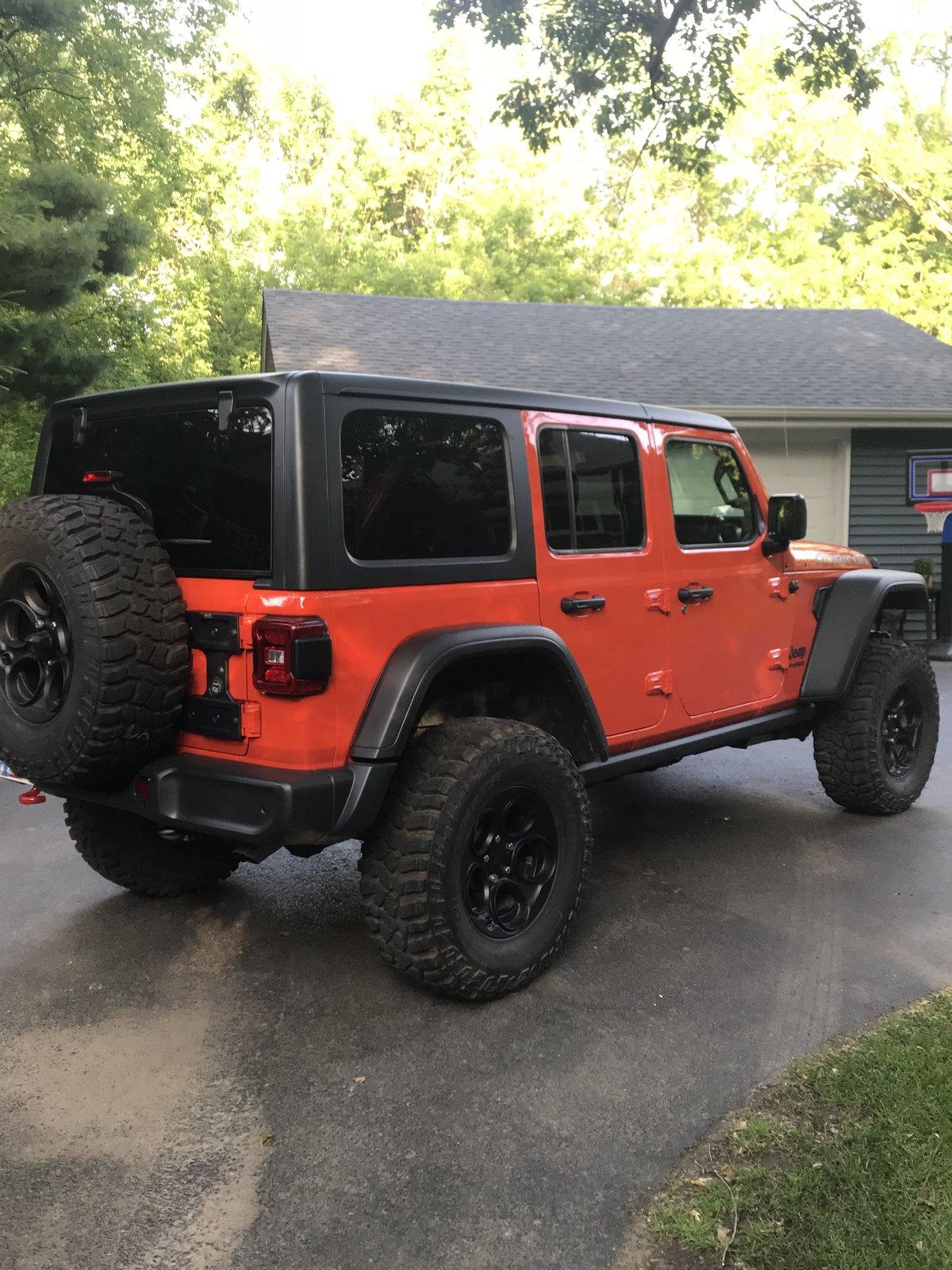

I have no complaints with this lift, I did notice it took some time for the lift to settle but once it did it looks amazing. Paired with jk borah beadlocks the offroad comfort and performance is great. Way better than stock in my opinion

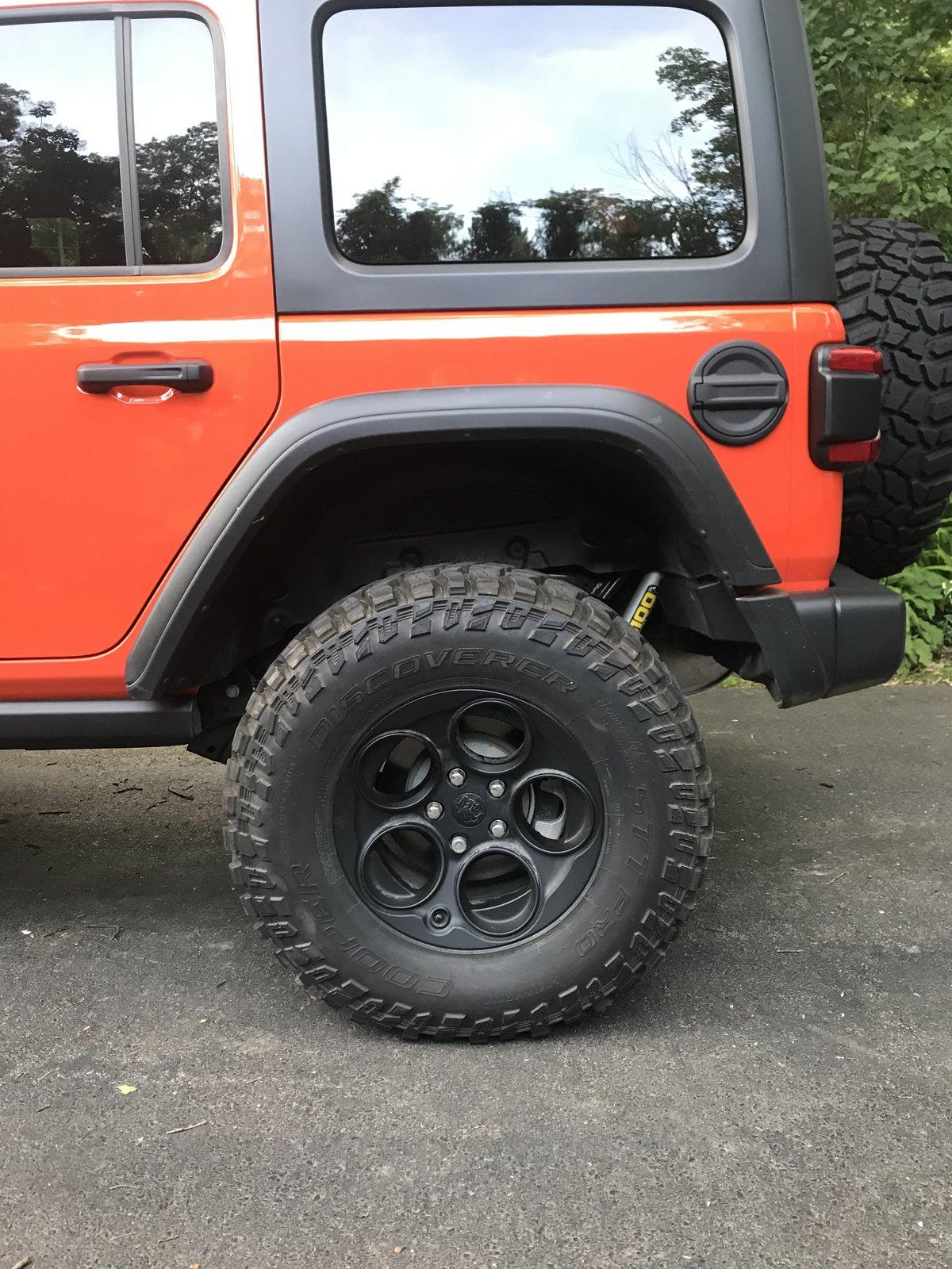

Stt Cooper pro 35” 315s, AEV Savegre wheels, AEV 2.5 lift. Drives great, soaks up bumps better than stock. I was worried about AEV’s description that the lift is made for extra weight. I am light for the time being with plastic rear and steel front bumper. It feels planted, I drive aggressive and I can still drive that way without any worry lol. The 35” tires were first upgrade I did 6mos ago. 37s might be coming soon....

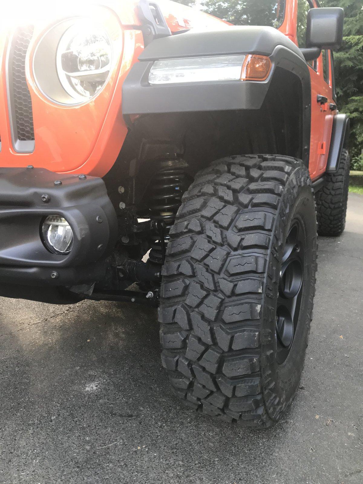

I just recently installed the AEV 2.5” and I’m noticing some steering issues with steering wheel centering and drifting to the right. Is adjusting the drag link the only fix or does anyone have recommendations on what to look for? It’s not to bad just more of an annoyance. Other then that the lift kit is awesome.
