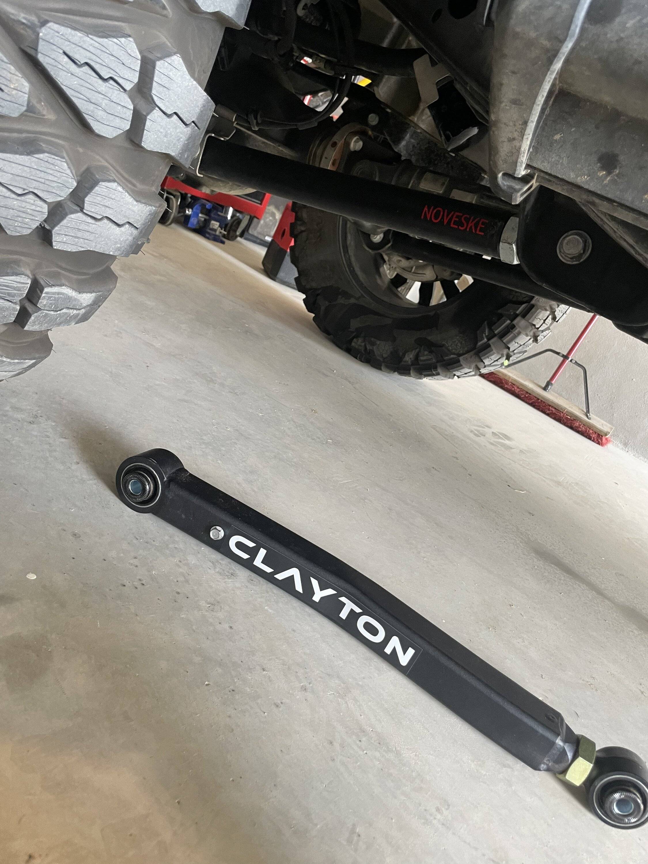

Bushing part, frame side Not the threaded part. The arms only have maybe 8k on them. Crazy. I have Clayton’s on the rear. Maybe it’s time.

I can move it back and fourth by hand. It only moves a tad, but it’s enough for me to hear and feel inside while driving.
I’m really surprised the bushing would fail so fast. The roads around here do suck though. And I just made the 2400 mile trip to Texas. I’m sure the 37s don’t help either.
Now I am concerned about the rough country track bars on her. I don’t have the money to replace the arms right now, so I will have to deal with the periodic clunk. It’s not bad, it’s just a little annoying.

Got them on Saturday. It seems like the road manners improved a bit. Might just be my mind playing tricks on me.
