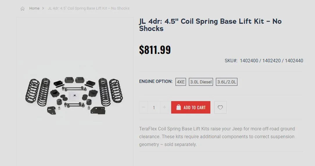

Well, with that much lift you don’t really have a choice. Stock control arms will result in some crazy caster, among other problems. Kinda crazy that TF sells that lift with no control arms.
Teraflex sells a bunch of base kits that don't include shocks or control arms - basically with the intent that you build out the rest of the kit the way you want it, and pretty sure that they note that the kit is incomplete.
Edit: yes, they do
Jeep Wrangler JL Adjustable control arms 1726502667050-jq
Edit: yes, they do
Fair point. I missed that part.
Still, OP, YOU NEED ADJUSTABLE CONTROL ARMS.

Could probably get away with fixed arms or geometry brackets too. Most of the fixed arms and geo brackets for JL work up to a 4.5" lift. Just really, really at the edge of what they'll be good at.
No way I’d just run the brackets with stock control arms. You’ll still have some fucked caster. Note that places like Evo won’t even sell you a 4.5” kit without control arms (brackets optional).
https://evomfg.com/products/evo-man...ension-systems-for-jlu?variant=42156099109102
TBH, Teraflex is asking for problems doing it this way. I get why they do it, but the disclaimer could stand to be more clear. Gonna be awesome when some bush league shop installs this kit and sends the noob on his way.

Eh, there's tons of places that sell builder parts and individual coil springs, etc and have for decades and decades, what Teraflex is doing isn't new at all in the off road suspension game. Can't be so afraid of idiots we hold everybody's hand their whole lives, if someone fucks up that's on them.
Yes and no. I agree, obviously, that builder parts should be available. But I also think the industry could do a better job of saving noobs from themselves.
Teraflex calls this kit
TERAFLEX 4.5IN COIL SPRING BASE LIFT KIT - NO SHOCKS
That implies that what’s missing is “shocks.” I know that there’s a little disclaimer on the bottom. Do you think that worked, given what OP posted above? This sink-or-swim approach to selling lifts to rookies is somewhat shitty IMO. I mean, Chemical Guys has better tutorials about how to wax your car than lift kit sellers have about how to lift your Jeep.
