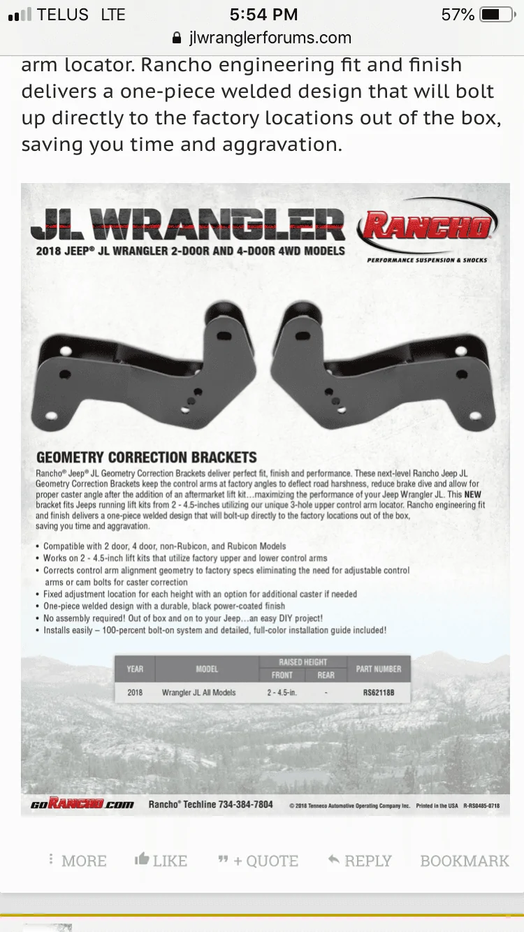

For a mostly Daily driver or even overlander that doesnt need the high clearance of an adjustable, geo brackets are the way to go. They will give to close to spec caster and far better ride
example on how they will give you a better ride, imagine pushing a dolly cart at 45 degrees (lifted on adjustable or fixed length) hit a small step up and you feel the shock load in your arms (frame) as it bouces over. now drop the cart to say 22 degrees (geo brackets) and go over the same bump. Far less shock load comes through your arms

Original post is adjustable vs geo brackets. In most cases the mopar lift arms are too short to obtain proper castor so with the addition of the geo brackets it will put the castor relatively close since most brackets have lift height options

Usually it’s either you would use one or the other but I have seen the overland guys run an adjustable with the geo brackets to ultra fine tune the castor and to simply have the stronger arm there since they do hang roughly 2” lower than stock
Using a fixed length arm with them that was ment for a certain height might end up in to much castor. The use of the mopar lift arms and the brackets may get you close tho since most have said the arms included in their kits were too short still to get proper castor
