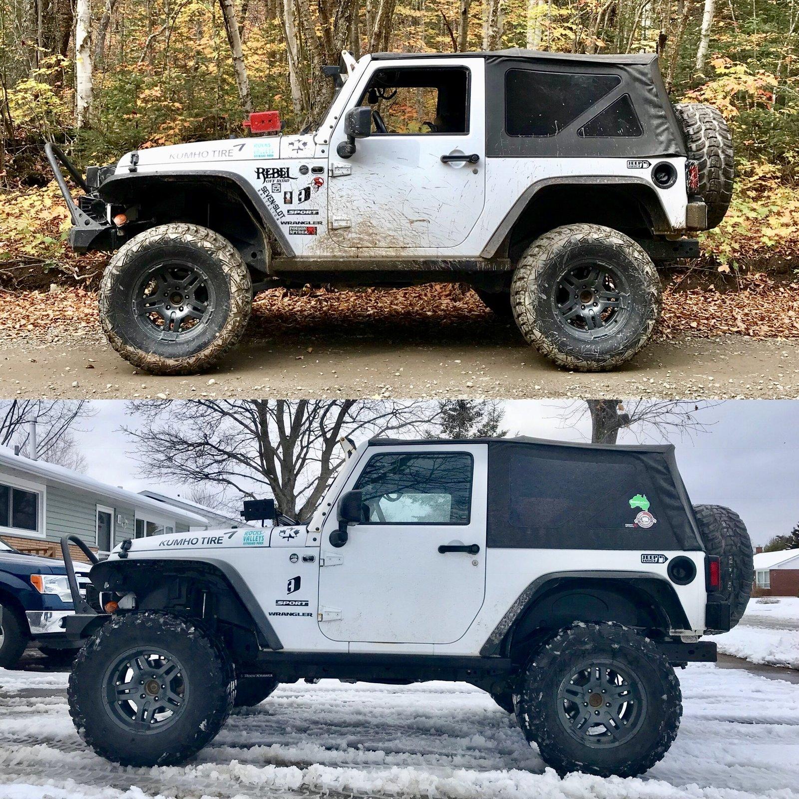

If you do decide to run one or the other, I personally like adjustable over the geo brackets. The brackets will provide a better ride, but you loose about 1.5 of clearance behind the rear wheel
Adjustable will give a slightly better ride as well too since they will re center the axle in the wheel well
It’s a comparison on my JK but you get the idea, before and after arms. Cleaned up a slight wander I had from incorrect castor and smoothed out the ride some from regaining proper wheel base
