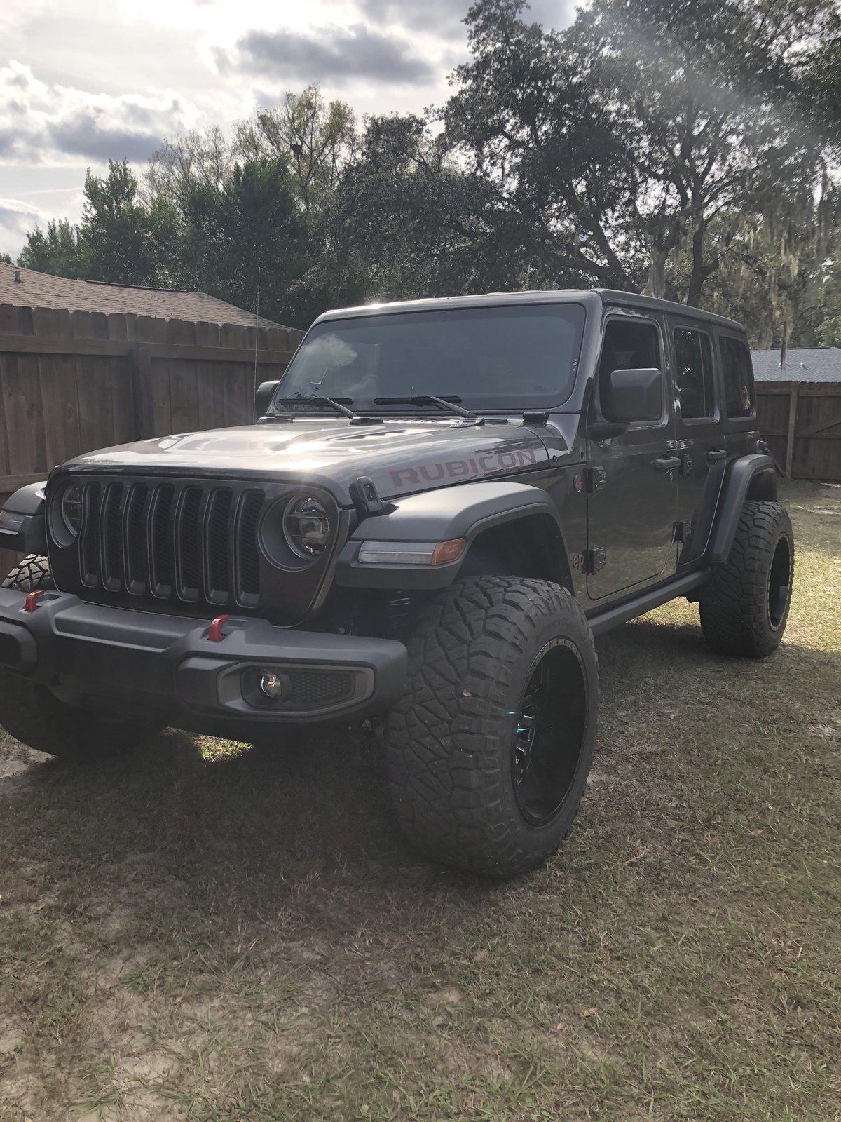

If you’re not going to be doing any crazy wheeling why not just put 35s on without lift. Does your Moab sit like the rubicon? Here’s what mine looked like with 35x12.50 x20s without lift.
No the Moab is based off a Sahara. It doesn't have the high fenders like the Rubicon.
