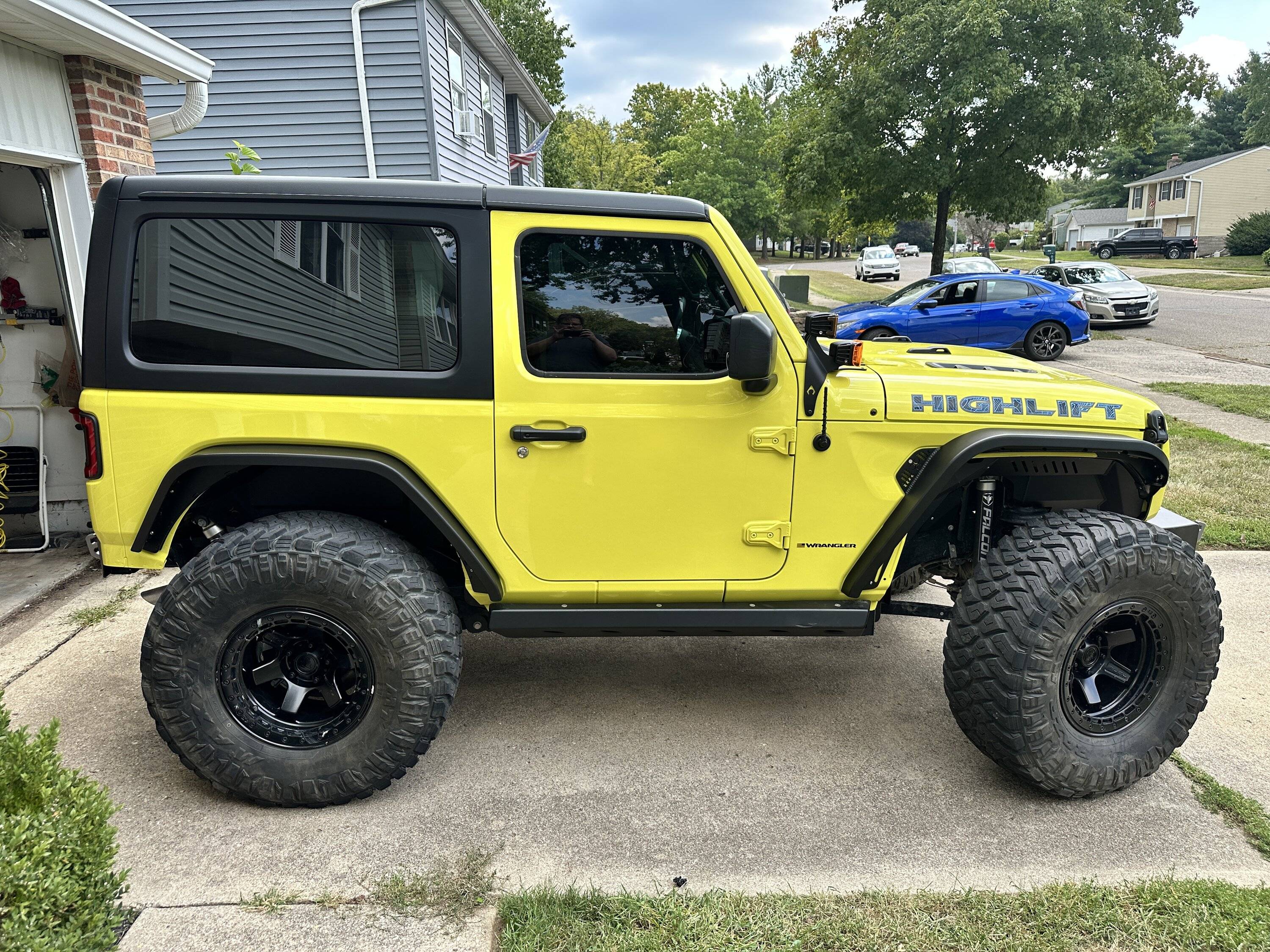

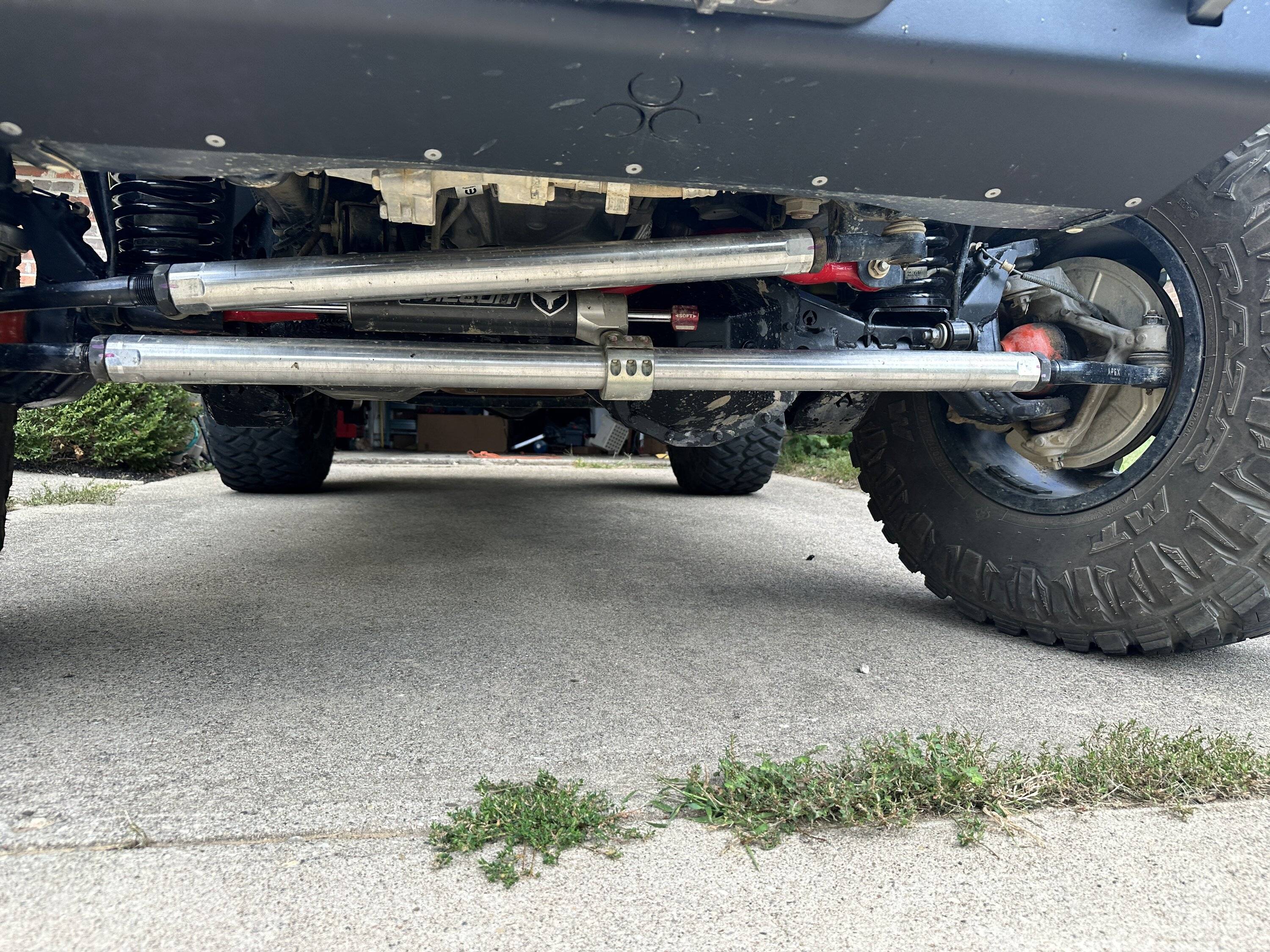

We somehow made it this far sans any control arm changes. Running RPM steering, Falcon 2.1s, Synergy 2 in springs, and Yeti track bars.
Swapping the track bar as it rubs the diff cover a tiny bit, but also really could probably fix by upper front arms.
So I am on the lookout for at least front upper and lower. A specific options you would avoid or go with? Features?
Rear if I did them I know we will replace so not really keen to waste the money, as eventually I am going to figure out how to stretch this one way or another. Unless the rear becomes an issue or I find a deal on all 8.
