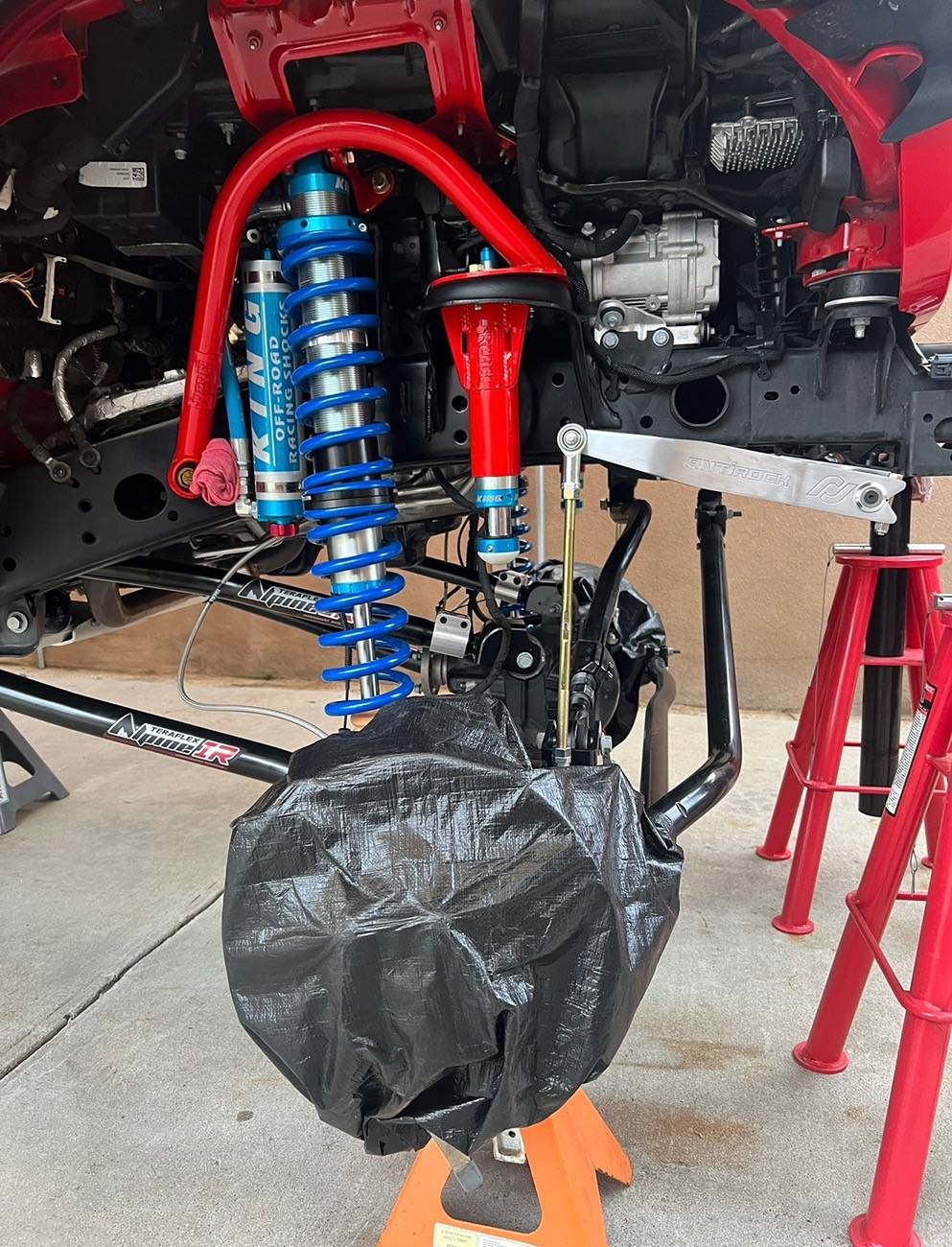

I run TF long arm with custom front and rear axles. Custom 1350 driveshafts. My caster is over 10 degrees. No drivetrain vibrations and tracks much better than stock - on 40's. We drive I90 at 80mph often.
I have been told numerous times - This is the smoothest new Jeep I ever rode in. ......... "better than my daughters' new Jeep Sahara".
