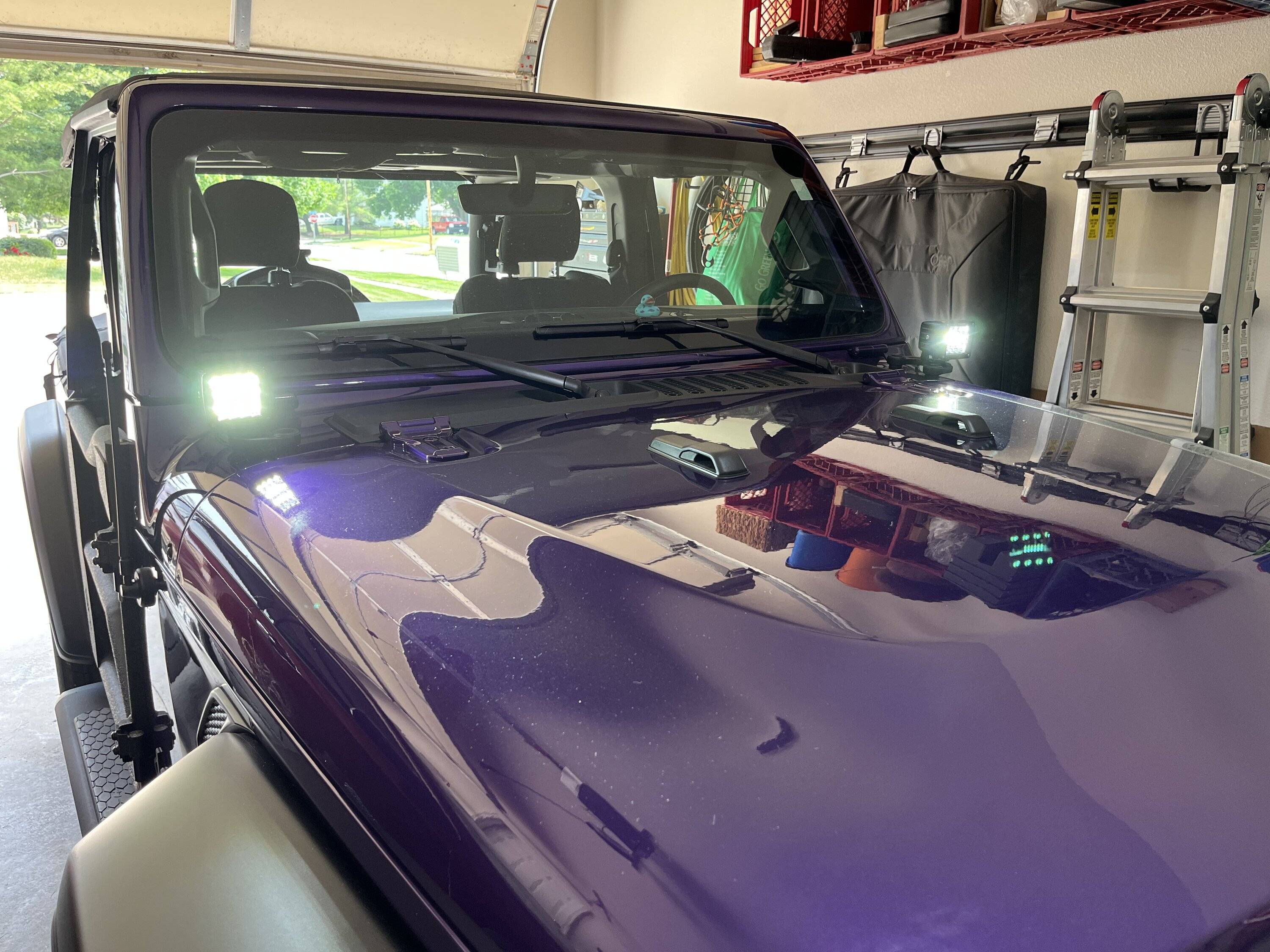

I went the cheap route and attached some Nilight lights I bought from Amazon.
Jeep Wrangler JL A-pillar only lights? IMG_1617 2
all-in (lights, wiring, connectors, etc.) I spent a little under $100.

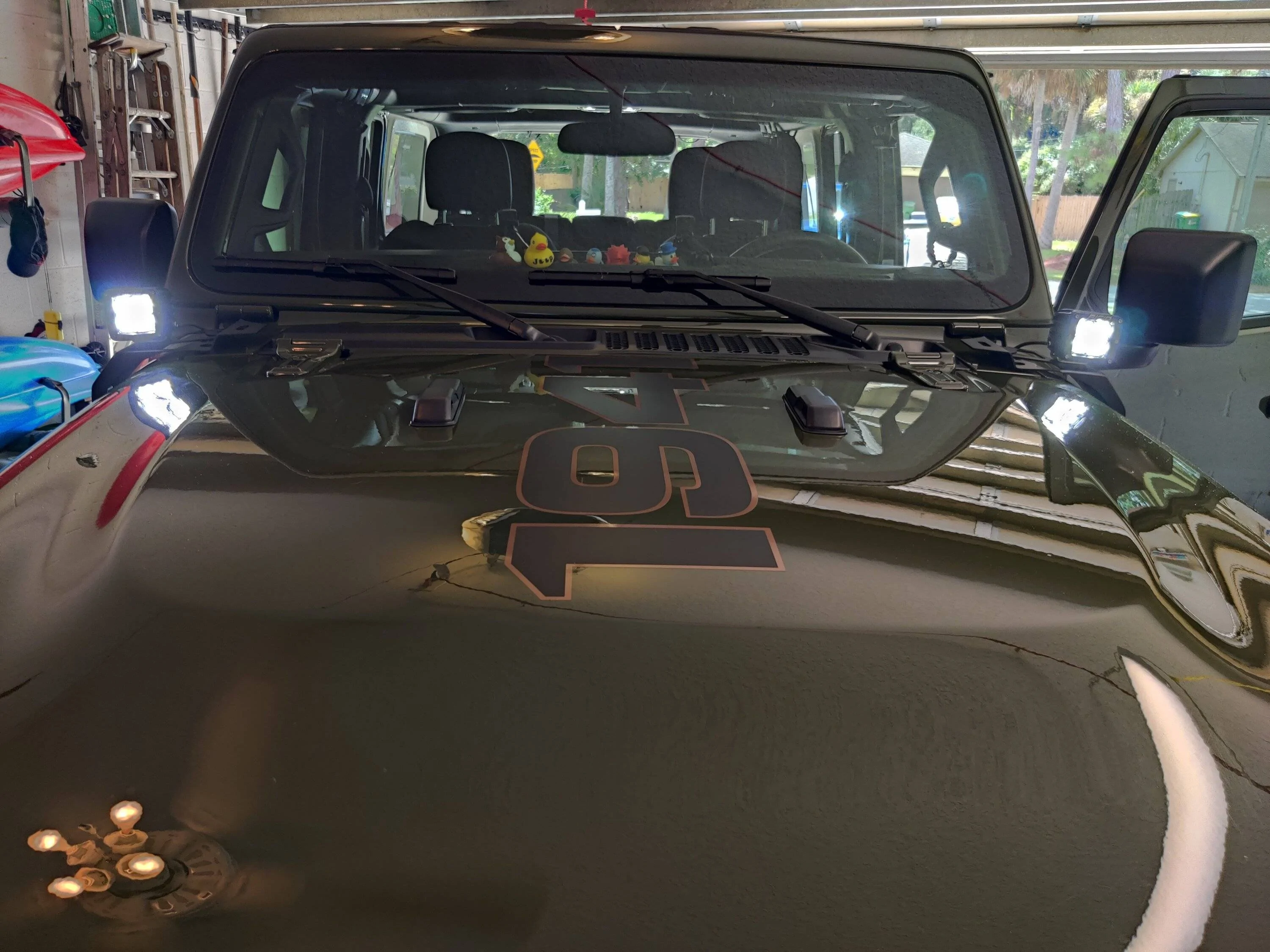

I’m running dynamics SS3 sport in Amber and White. I really like their cowl mount because I can still lay down my windshield if I choose, and I do that sometimes.
The sports have been plenty bright for me. I have the whites aimed just above my low beams and out to the sides for deer and I have my Ambers set just above my highbeams for snow and dust environment. They have been great

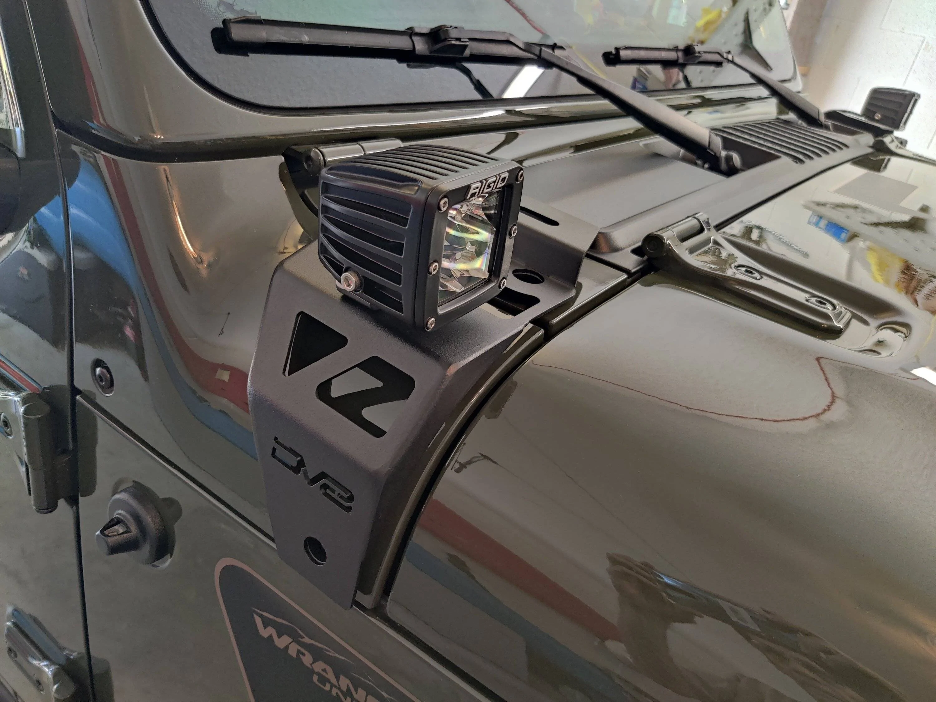

I wanted the ridged. I know they are top quality, pricey but good. I got lucky at the great Smoky mountain jeep invasion and snagged these for $160. Brackets were the hard thing for me. Found the DV8s on sale from ET with free shipping. Really like the DV8 good quality.
They make a crazy amount of light. Have never needed more lighting yet.
Edit: the DV8 brackets will hold 4 lights, just haven't got the other two yet.

Digging those brackets!

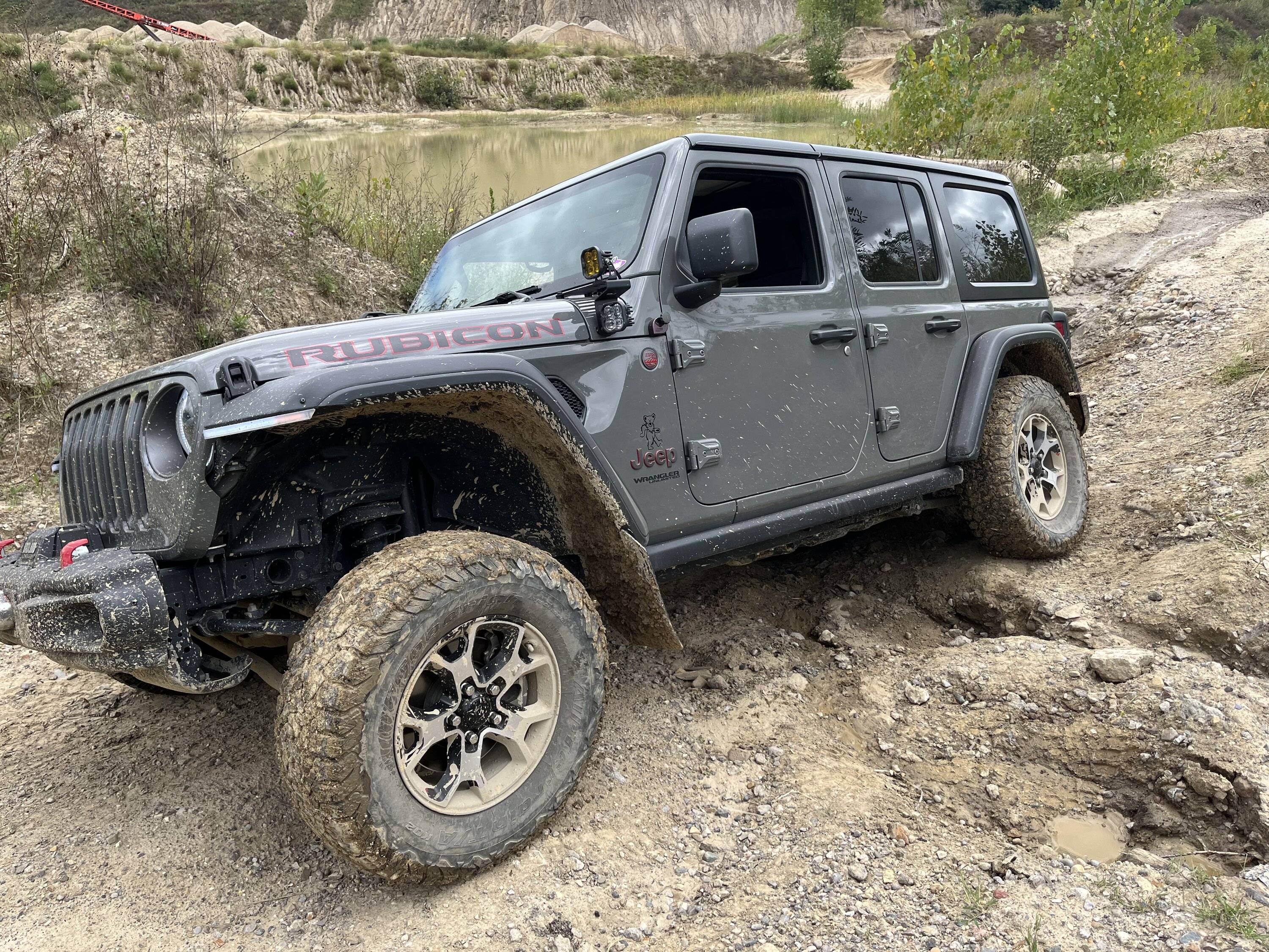

I went with the Mopar solution and am very happy. If I were to do it again I might choose a different mounting bracket (like @longfiredragon's DV8's) - but if I ever mount a snorkel (questionable) I think I'll be glad I went with the Mopar bracket. The lights themselves are insanely bright - and provide plenty of light for my night time escapades, used mostly to avoid deer on the road. I have them wired to the factory AUX switch.

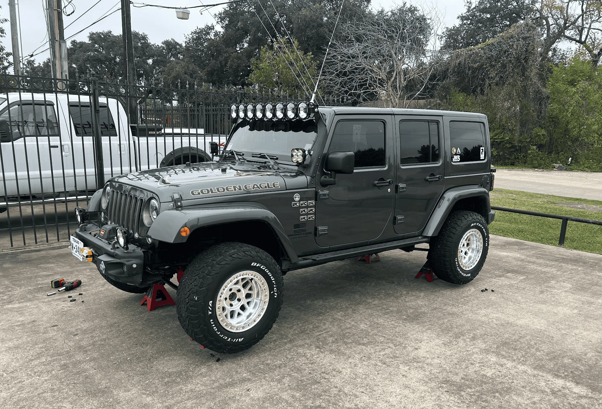

I currently have the KC Flex era 4 and I love them. Yes I have the pro 6 light bar and some bumper stuff but I find myself using these A pillar lights the most on trails with other people. Previously I ran the KC gravity pro 6 in driving beam at the a pillar and they weren't giving the up close super bright light I was looking for. I have both spot and flood beams and with this light the flood beam lens is 100% the better option. I have a buddy that runs the Baja designs LP6 on his front bumper and they definitely have more output than the Flex 4 however they are also huge and I am not sure if they would look good on a jeep A pillar.
Sorry I dont have any great up close photos but these are my Flex 4's

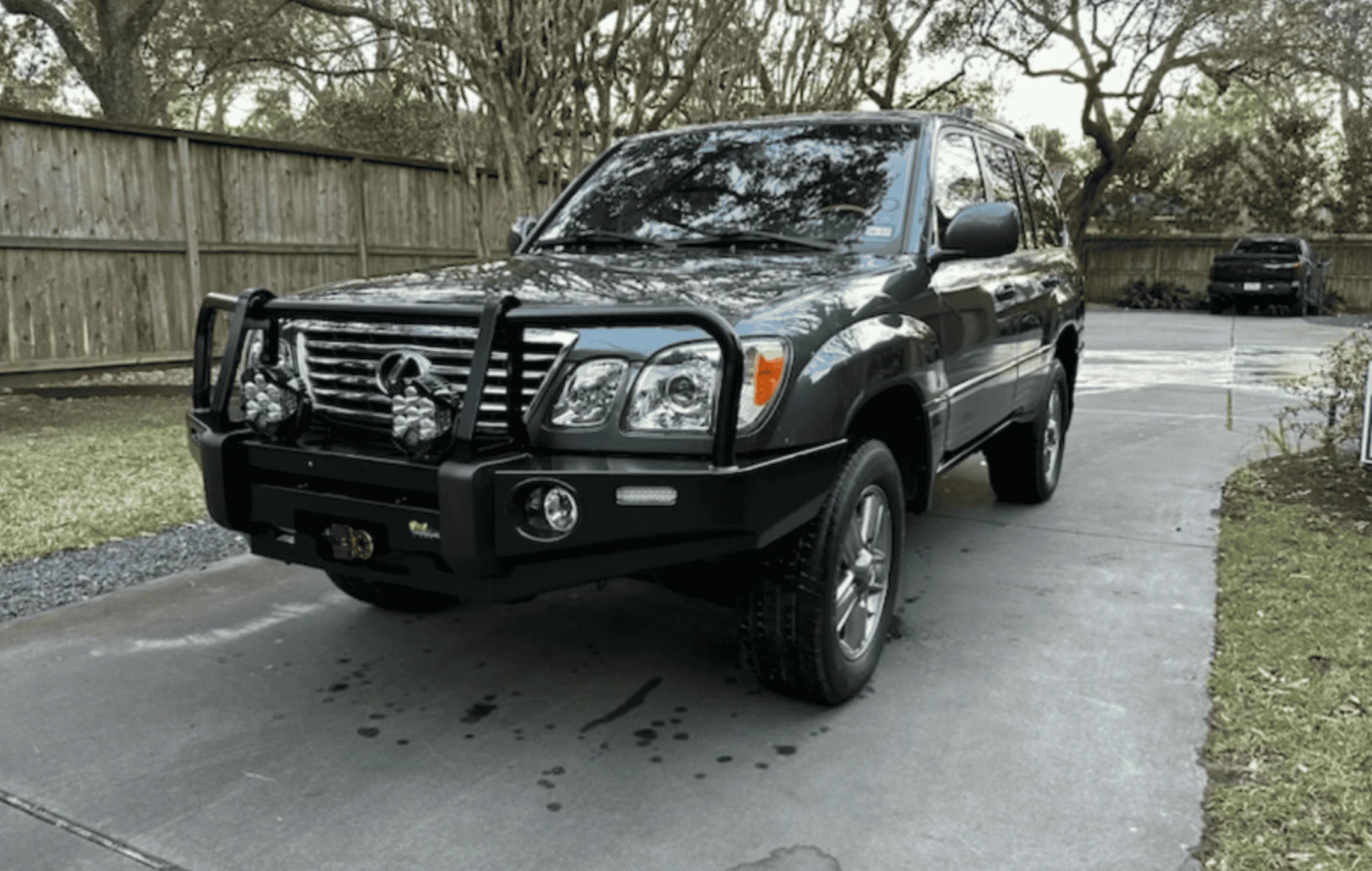

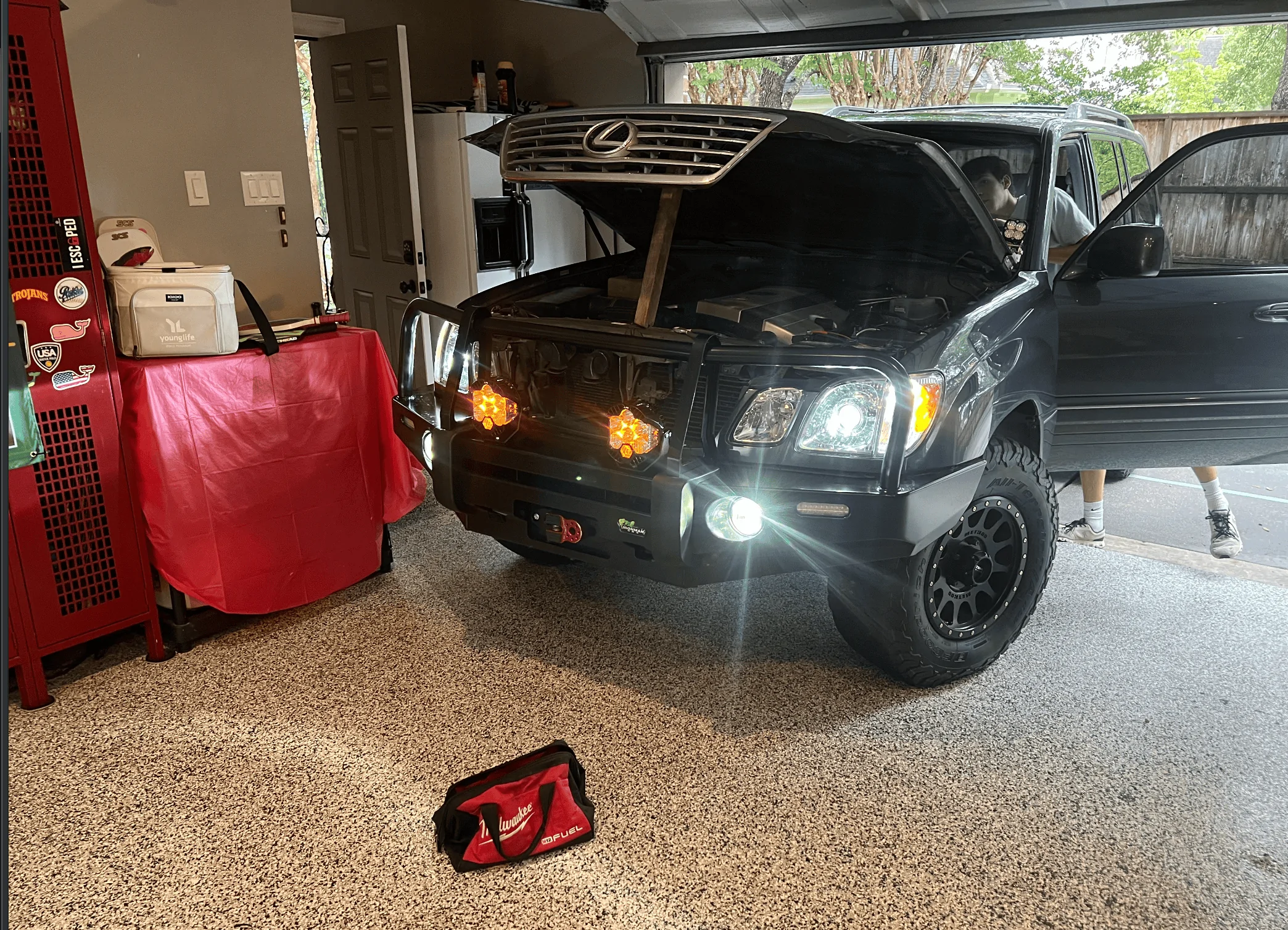

And these are some photos of the LP6 while they are not on the a pillar I think they still preform extremely well at the low level. He also has the BD squadron sports at the a pillar and they are only ok and not something I would buy for how much BD asks for them.

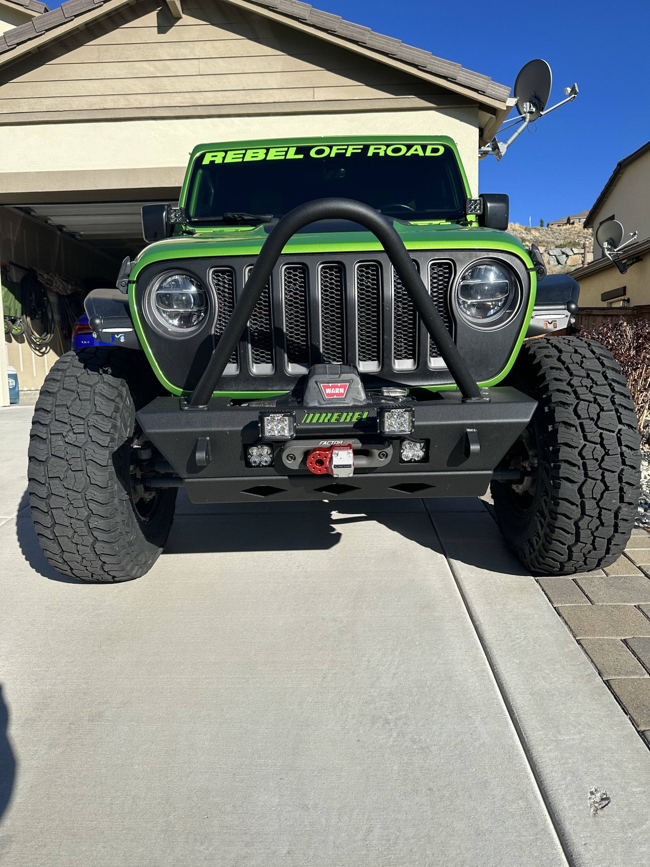

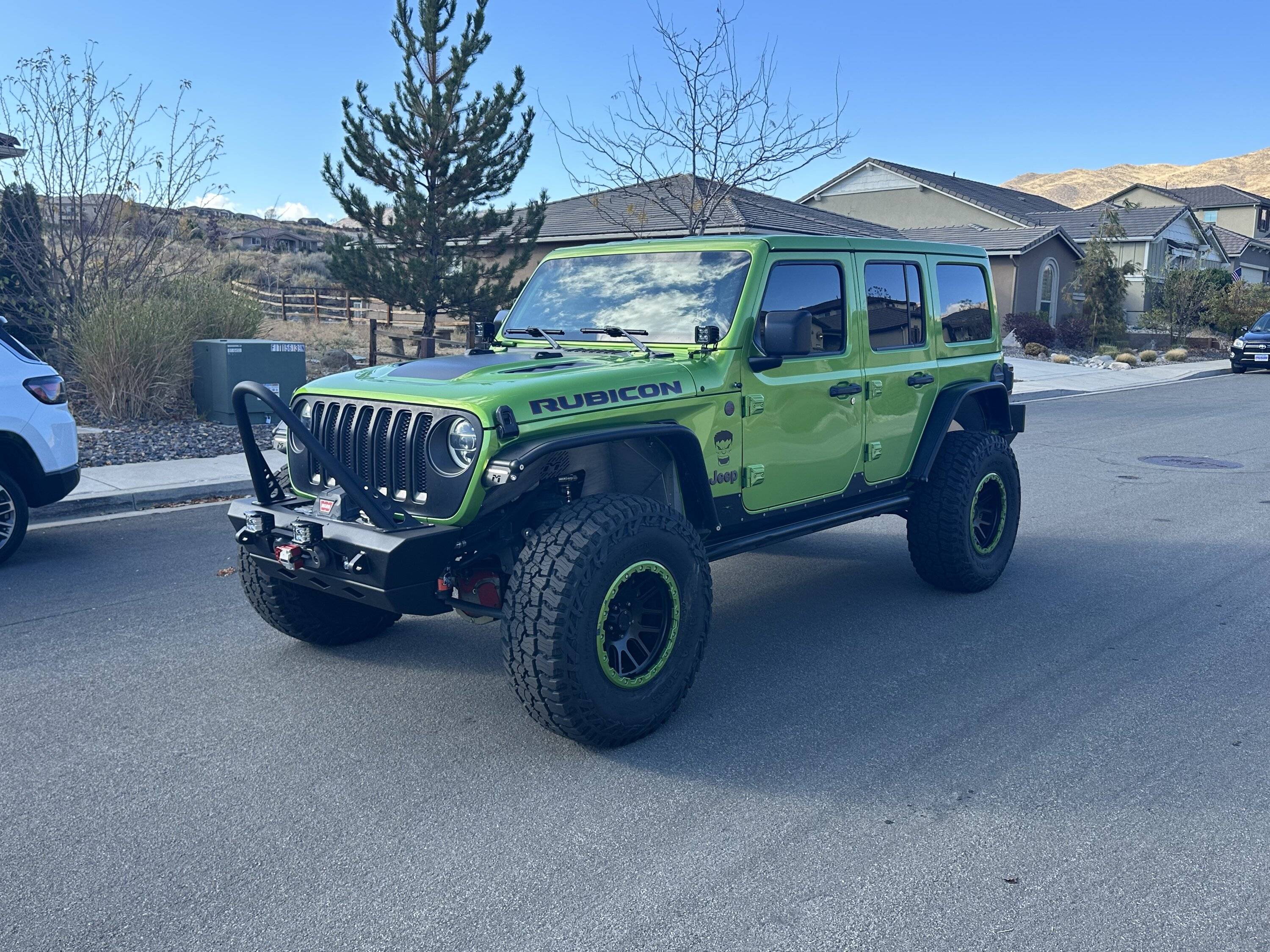

I've got Rigid spot lights on a set of KC mounts, which bolt to the hood hinge and cowl. For me, I prefer spot pattern lights up high (such as the A pillar). Mounting floods or even driving lights on the A pillar causes a lot of light to reflect off of the hood and into your eyes and not on the road/trail where it should be. This is due to the more diffused light pattern, whereas the spot beams are more concentrated. I have driving lights and fog lights mounted on my bumper, where the diffused light patterns are best utilized and won't blind me.
I have the spots and driving lights wired to separate Aux switches, while the BD floods are connected to the factory fog light switch.
