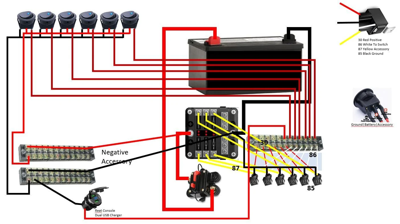

I drew up a diagram to get an idea of how to set it up.
I switched out the blue wire for red just like in the YouTube video for the relay.

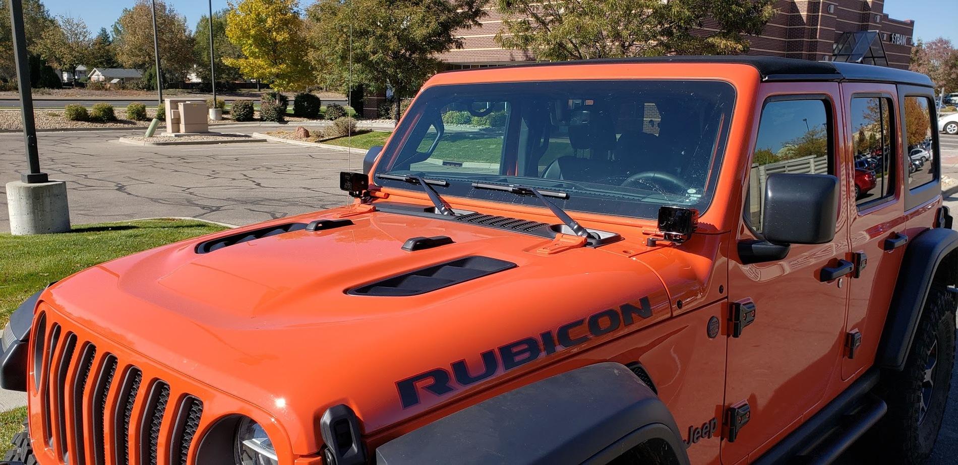

Can any of you guys speak to any hood glare with A pillar mounted lights?
skrubi12
May 30, 2018
266
119
New Market, MD
@Mike630 i had a little bit with mine (rigid cowl mount mounts them close to the top of the hood and sides) but nothing that blinded me or made feel like it bothered my vision. I think sun glare is much worse. Not sure if color matters but I feel like it’s probably amplified by white (I have a white JLUR)

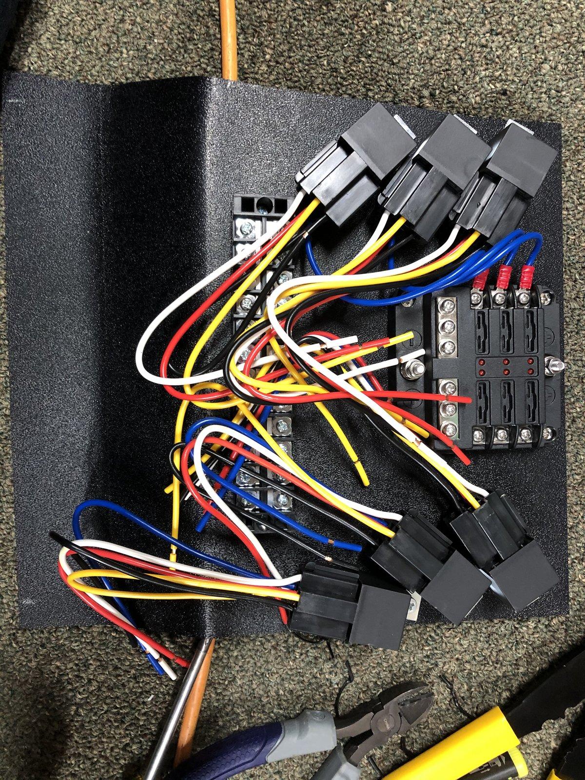

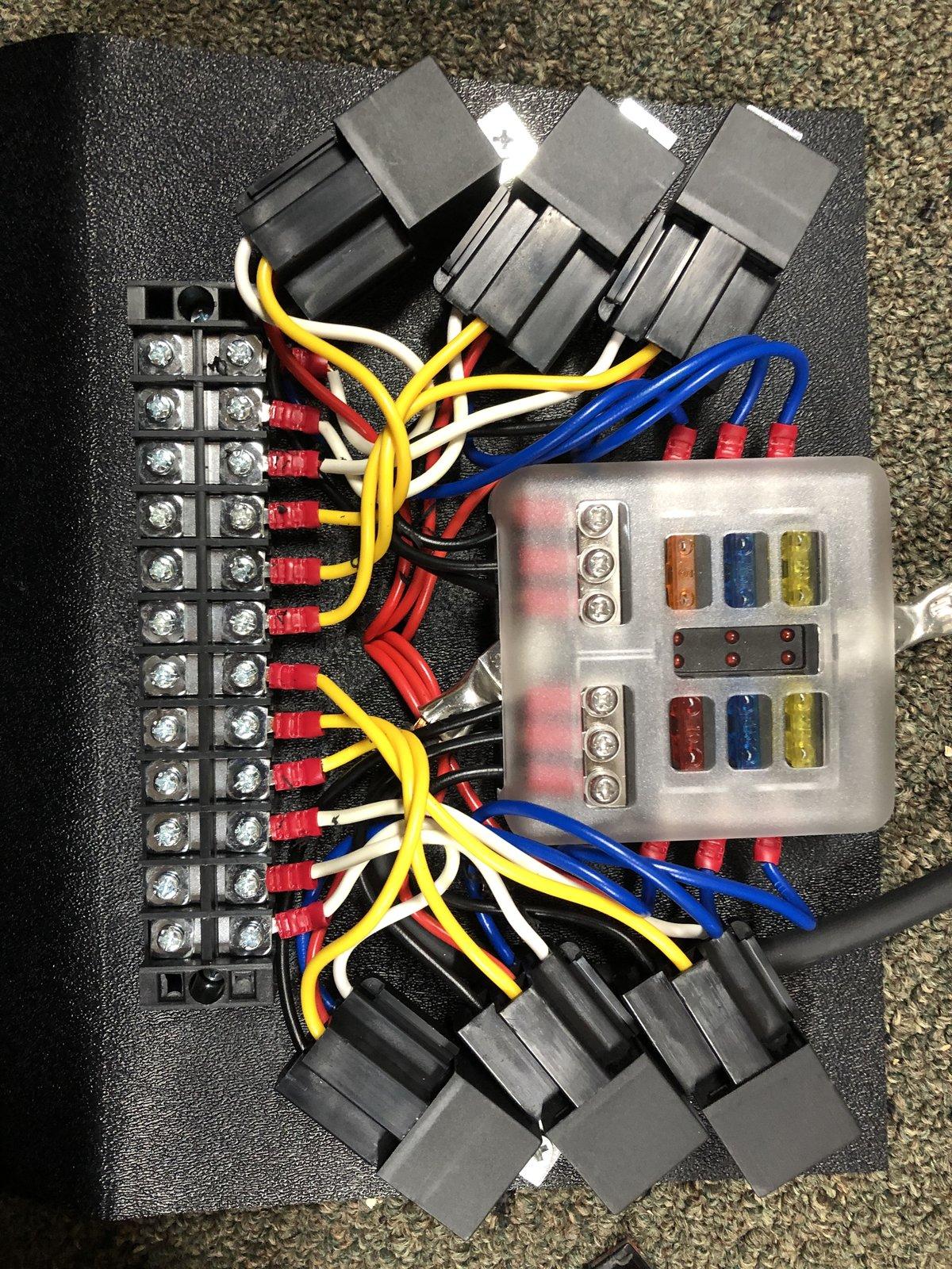

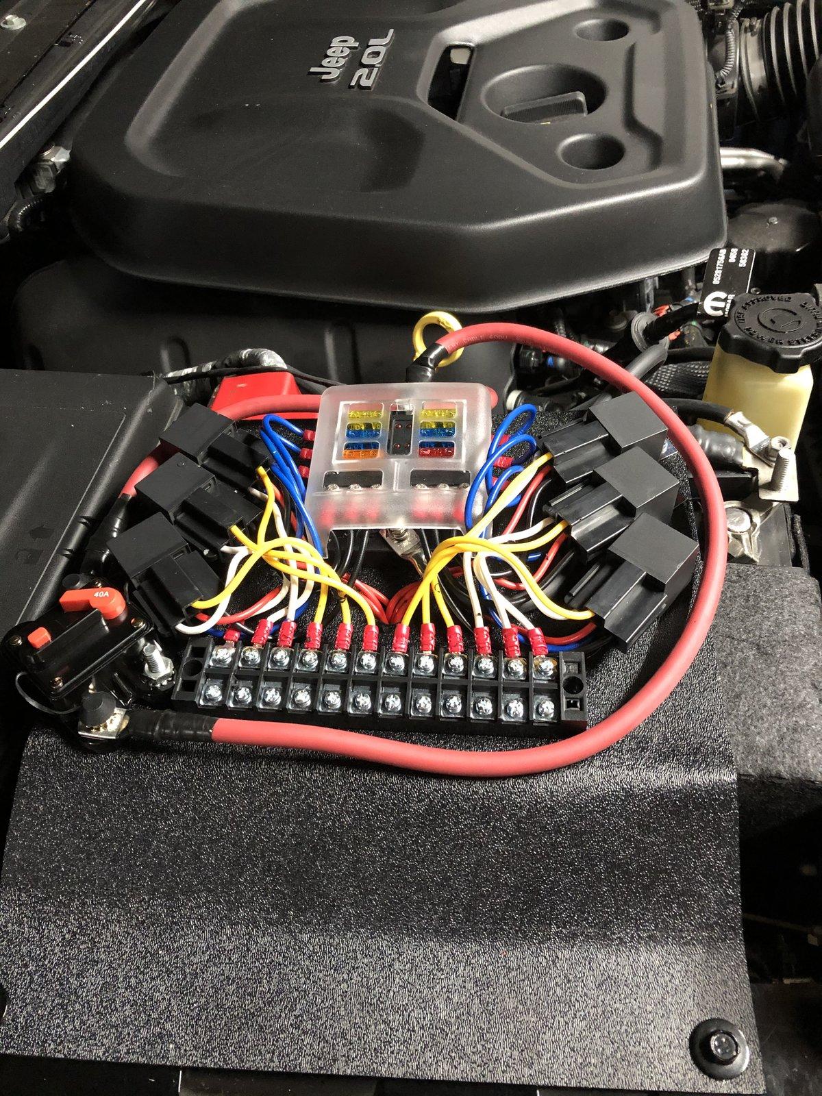

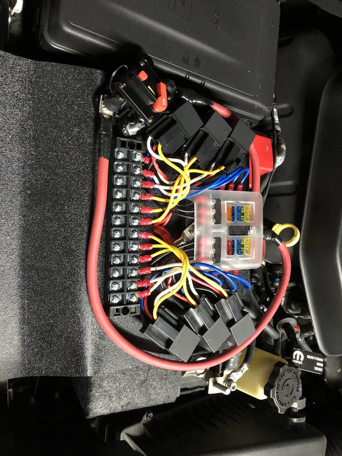

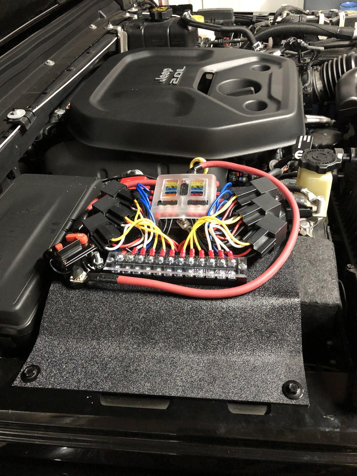

Got mine wired up and installed, just have to install the switches and wire them up, but it’s all live and ready to go otherwise...
Jeep Wrangler JL A pillar lights 6911C5C3-080C-4B35-8D5C-6ECA0507C4BD
Jeep Wrangler JL A pillar lights 61D5EA30-3925-4B57-9DFE-2020B80EA086
Jeep Wrangler JL A pillar lights D65DE615-3D5C-48FC-9E71-4FEE07EAF837
Jeep Wrangler JL A pillar lights 233767C3-CBFD-4D39-842F-99A6A34D6780
Jeep Wrangler JL A pillar lights FD2DCE7C-BBF3-46CC-9B8A-FFC9A2BD0BB9

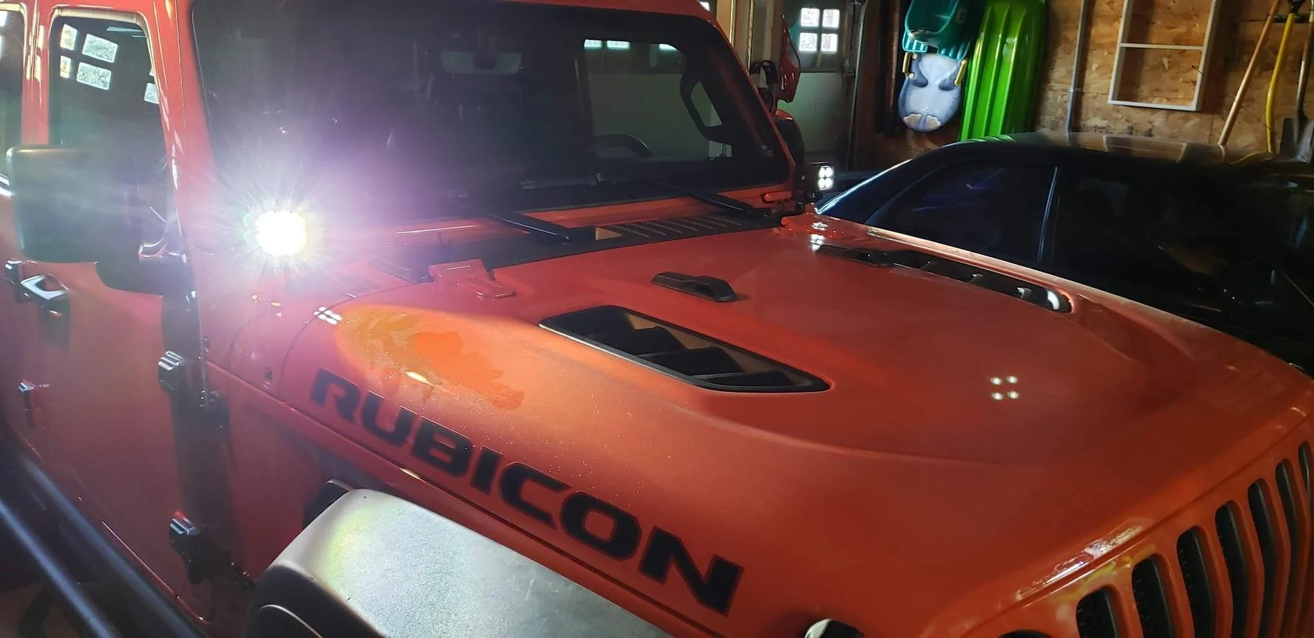

On a serious note though, can some of you post up what your view looks like at night from the drivers seat? I'm curious to see how much reflection y'all get.

I’ll try to get out tonight to get a picture.
