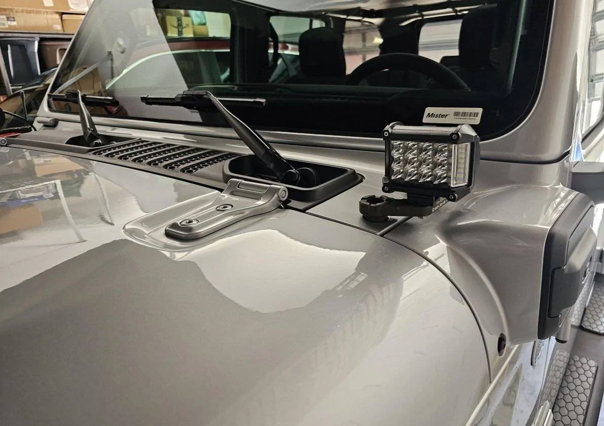

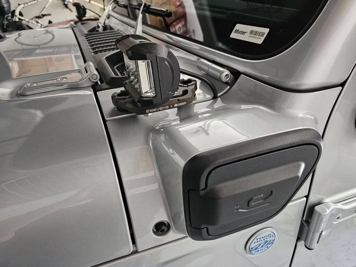

Auxbean Side Shooters and Seven Sparta mount. These have plenty of front and side coverage.
