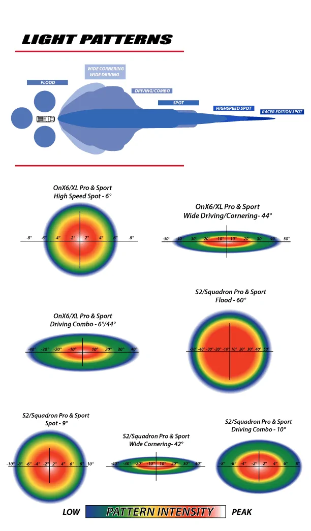

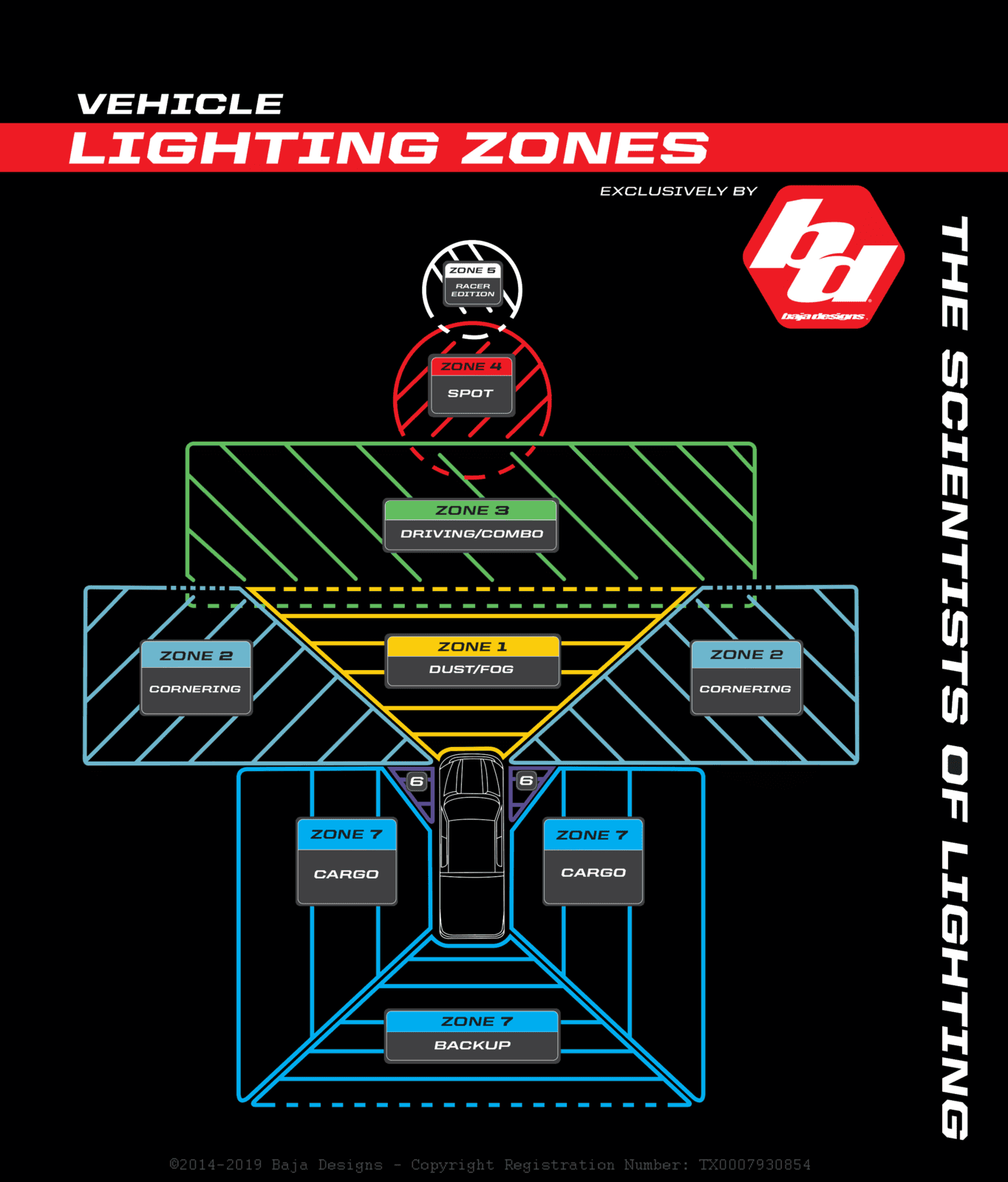

But if you're looking for off-road lighting, we have the three remaining units. Here's a description of each lens pattern we offer and a few diagrams that illustrate it. Our LED products feature uService that allows the customer to swap out the lens so you can change your lighting pattern in minutes. For a pair of Squadrons, it's $30 for new lenses. https://www.bajadesigns.com/science-of-lighting/uservice.asp For an A-pillar light, I would recommend a spot lens to have minimal glare on the hood.
Driving Combo: Maximum trail coverage in a single light. The Driving/Combo pattern is equipped with both wide cornering (42°) and Spot (9°) optics to provide you with a smooth blend of light for both near field applications and distance (Lighting Zone 3)
Wide Cornering: BD was the first to develop a pattern specifically for cornering, dust and/or fog conditions. The Wide Cornering pattern offers a 42° flattened horizontal beam for the ultimate in comfort lighting. (Lighting Zones 1 & 2)
Spot: A longer and narrower 9° beam focus for illumination further down the trail or road. The Spot pattern is designed to be used in conjunction with additional Wide Driving and/or Driving/Combo beam lights. (Lighting Zone 4 & 5)
Flood: Excellent work light or “scene light” with an extremely smooth 60° circle that projects about 60 ft). This pattern is not suitable for driving. (Lighting Zone 7)

Wow thank you for all that info. I really appreciate it. I’ll have to do some research and find out what I truly need. I’ll reach out if I have anymore questions. Thanks again.
