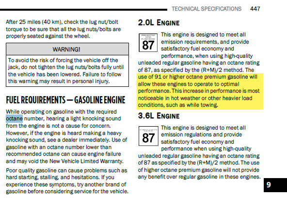

Either way works. If you notice the fuel economy or performance, and it's worth it to you, go for it. If not, that's just as fine too. Everyone's a special pony. Everyone's a winner unless they're spoiling for that unique fight where the world is wrong yet they know better.
And now the obligatory cut-and-paste from the manual:
Funny how most questions are answered in that little book!!
