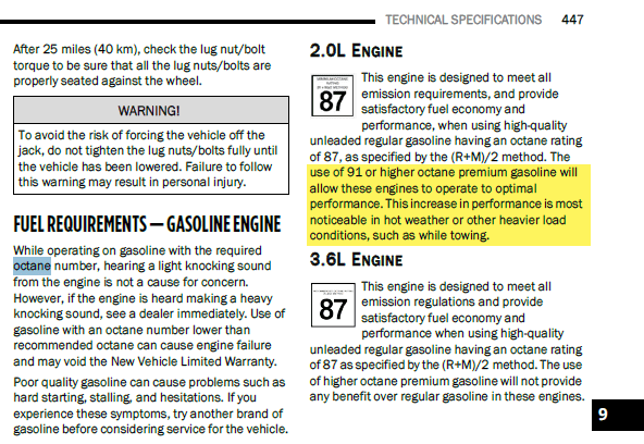

Reading comprehension is hard, for "optimal performance" run 91 octane or higher period. It's in the highlighted section you quoted in plan English. The engine will run fine on 87, but suboptimaally.
