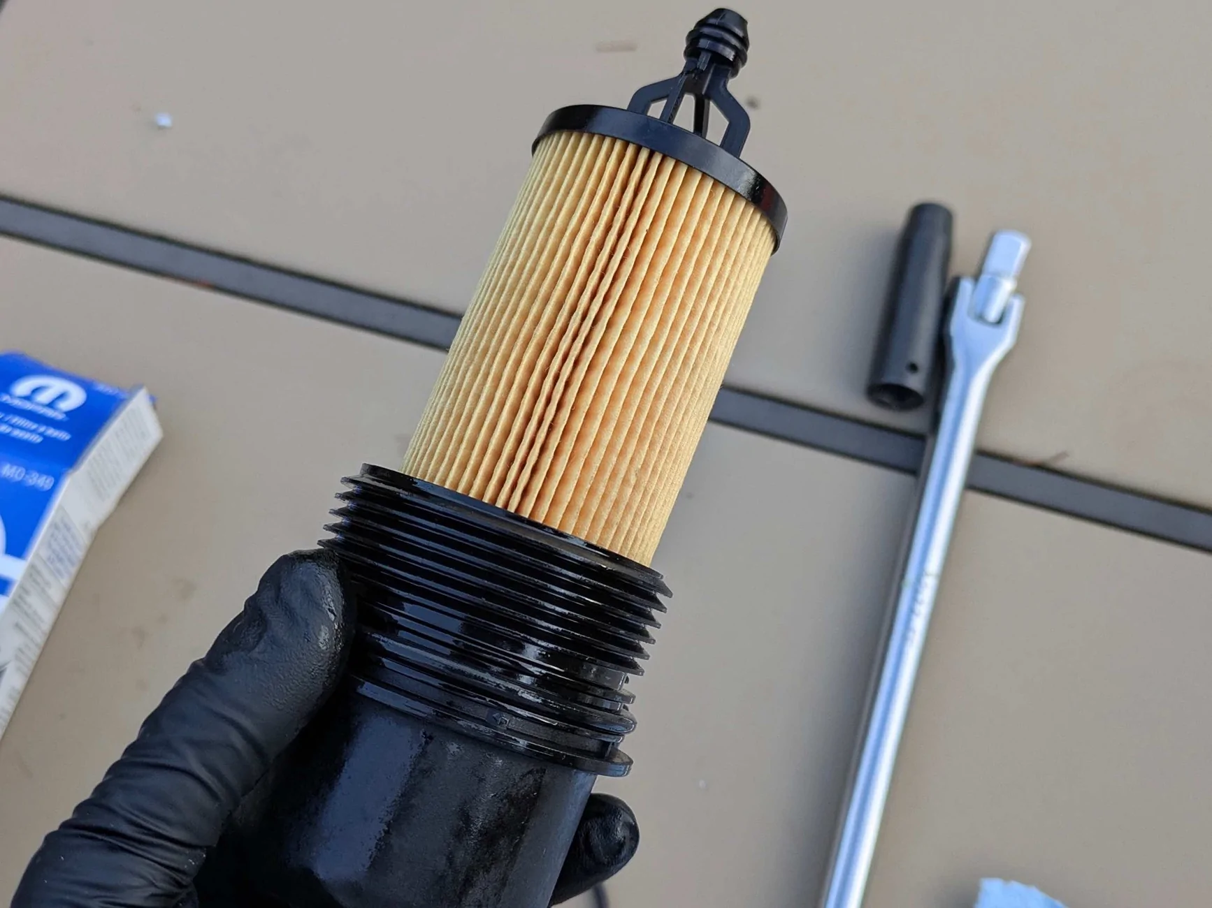

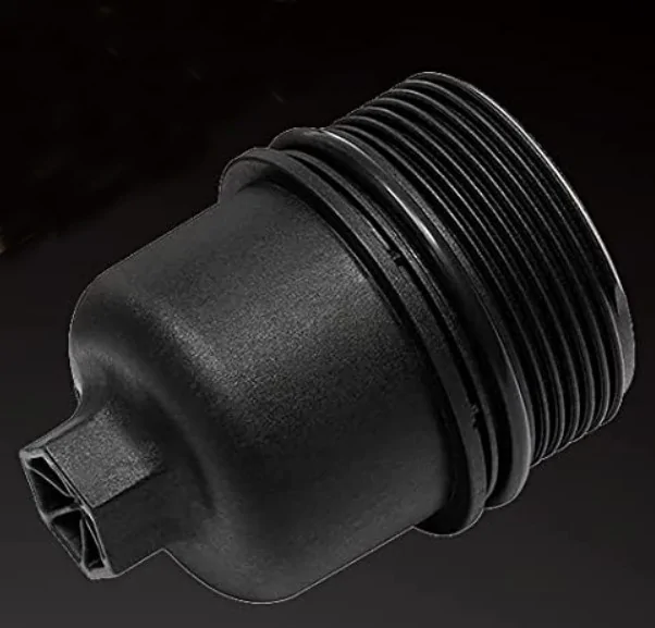

Oh ... forgot to mention.... Very good pic you posted of the proper o-ring placement on the Oil filter housing cap, OEM Part# 68191350AA.
Jeep Wrangler JL 6 Quarts engine oil! 1036808-89c2a62accd6c007f27dfe76dac2dc3d
I'll add your pic to my data base........ along with these two..
Jeep Wrangler JL 6 Quarts engine oil! Mopar Oil Filter Housing Cap - 68191350AA
Jeep Wrangler JL 6 Quarts engine oil! filter housing

Yeah always lube that new O-ring that comes with the filter in the box. Also the filter plastic tip has another smaller O-ring that needs lube. As important - do not overtighten when re-installing the plastic cartridge as it can snap the housing.

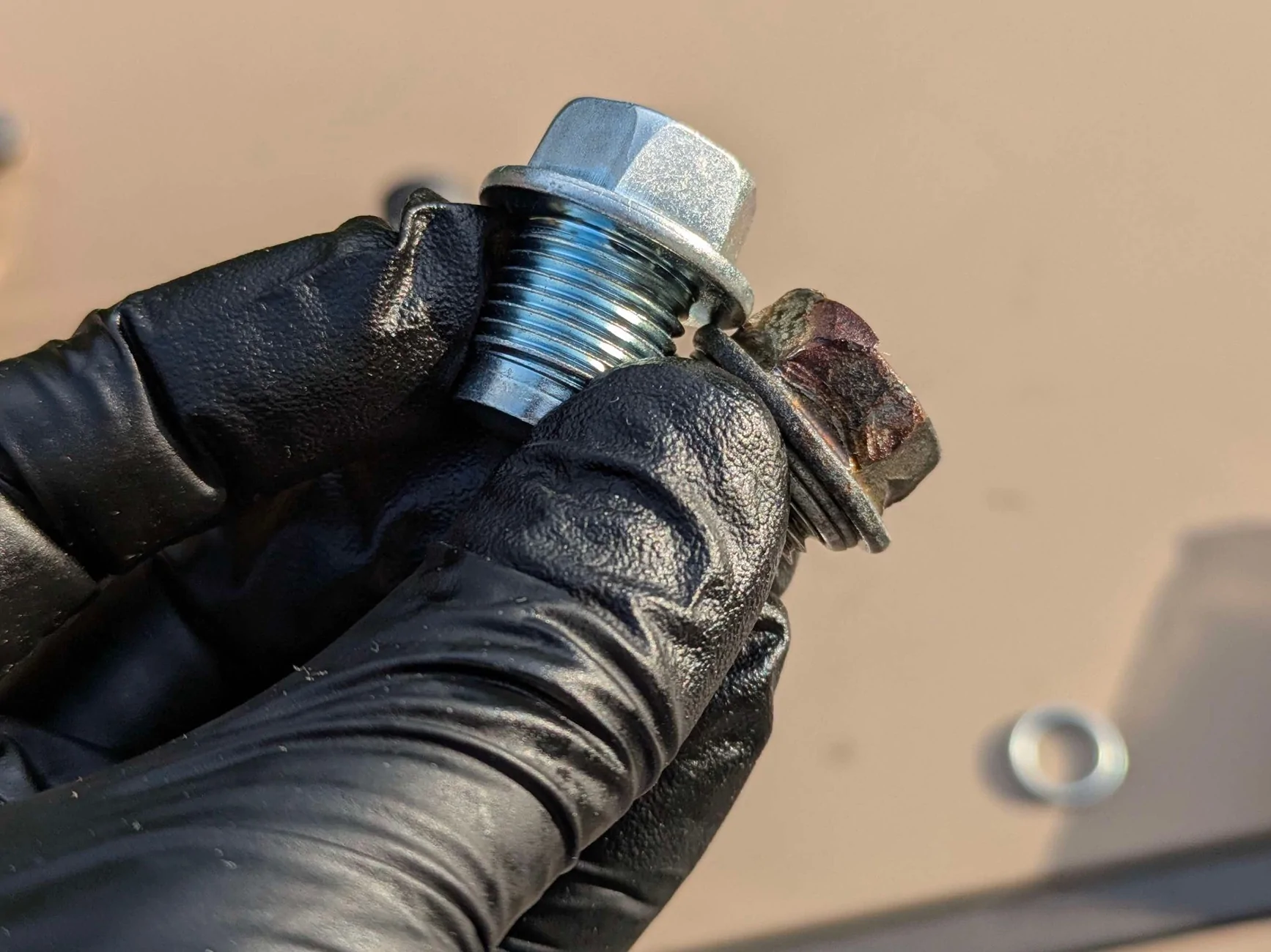

Same with the drain nut. Do not over tighten that bolt. Just torque to spec. Spec is plenty tight.
The pic below is from a lady friend’s car. The previous techs must have slammed using an impact wrench and rounded the corners out. Complete incompetence! Always do yourself if you are able!

A little reminder for all and IMPORTANT INFO, for the guy/gal doing their 1st oil change using one of these cartridge filters..
When you remove the old cartridge filter ... DO pull it straight down away from the oil filler cap.
Do not bend it sideways when you remove it!
IF you remove it incorrectly and bend and pull, you can actually break the valve inside the oil filler cap.
