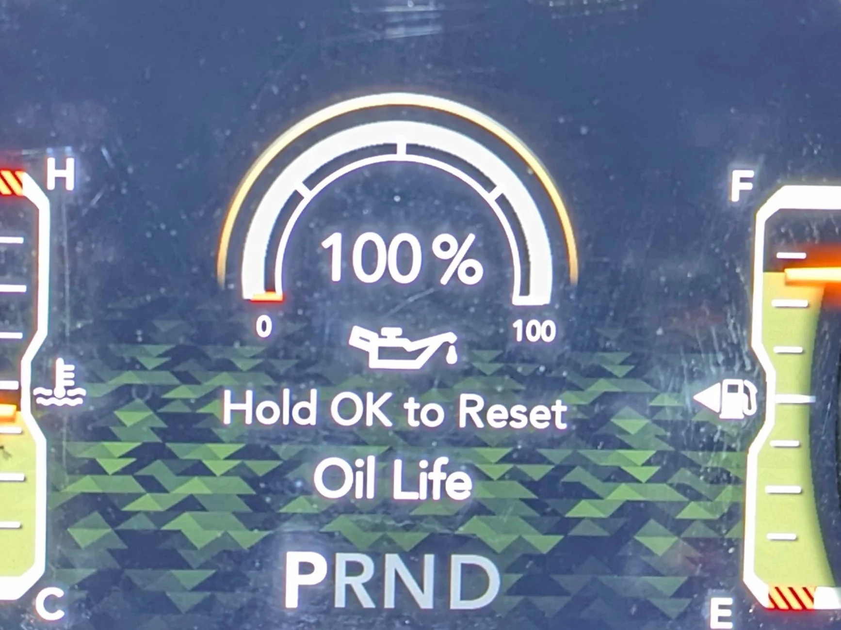

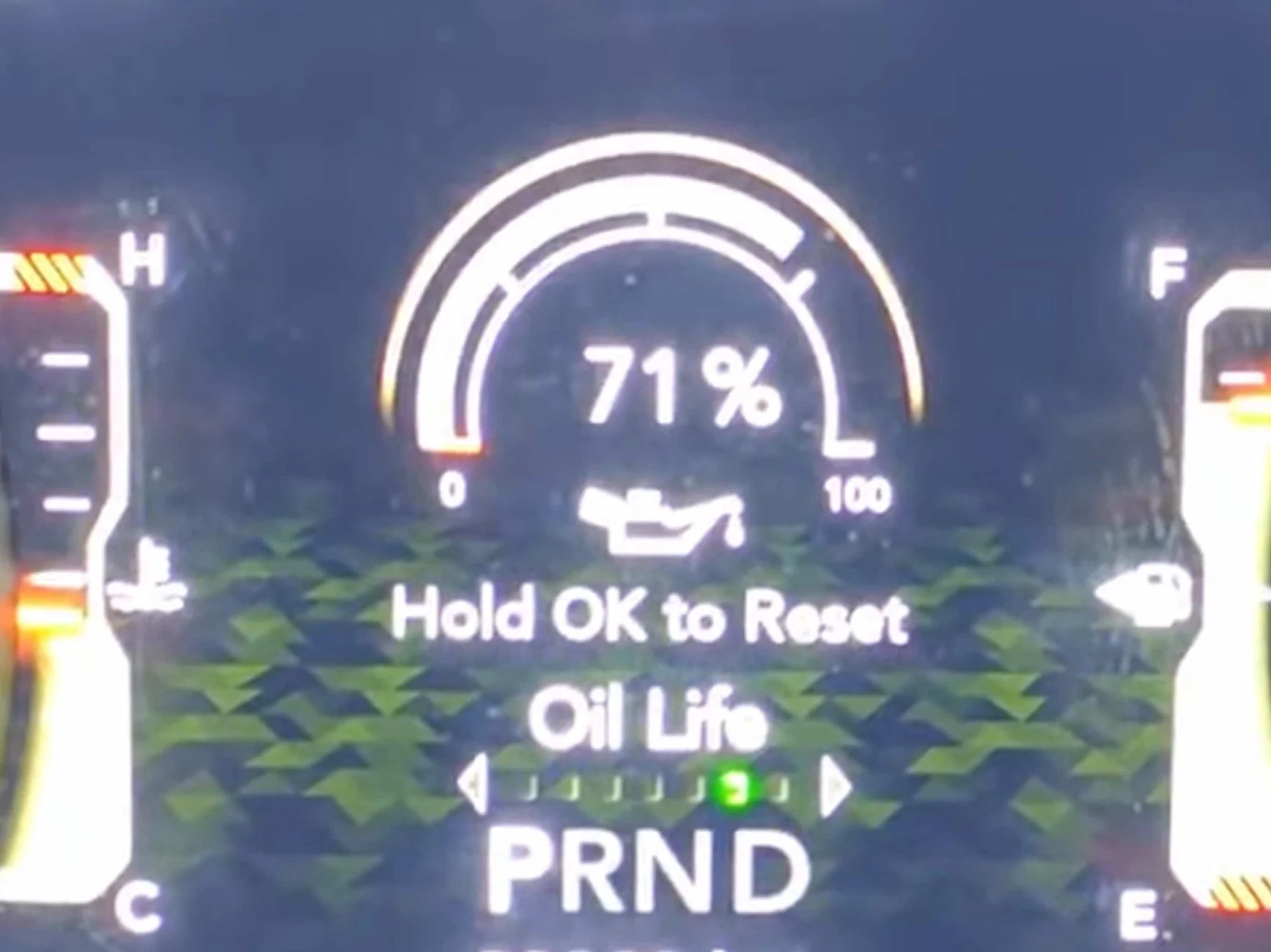

Nice. Here was my oil life remaining before dumping it out. Oil still had a lot of life but was getting aged. Did the run mode and tapped over to the right display. We always do our own schedule so do not really follow what is shown. Haha! We are rebels.
As an aside on our Porsche it mandates you must run the engine for a silly amount of time while it reads the digital oil level. No dipstick. But can understand as the engine is right behind your back and down super low to the ground. Flat 6 NA.
Here are pics so we never have to remember what was what. Haha!
Tips are good for everyone. Free is free!
Jeep Wrangler JL 6 Quarts engine oil! IMG_1951
Jeep Wrangler JL 6 Quarts engine oil! IMG_1952

Oil Life Reset:
1. Without pushing the brake pedal, push and release the
ENGINE START/STOP button and place the ignition to
the ON/RUN position (do not start the engine).
2. Navigate to Oil Life submenu in Vehicle Info in the
instrument cluster display.
3. Push and hold the OK button until the gauge resets to
100%.
Secondary Method For Oil Change Reset Procedure
2. Fully press the accelerator pedal, slowly, three times
within ten seconds.
3. Without pushing the brake pedal, push and release the
ENGINE START/STOP button once to return the ignition
to the OFF/LOCK position.
NOTE: If the indicator message illuminates when you
start the vehicle, the oil change indicator system did not
reset. If necessary, repeat this procedure.
