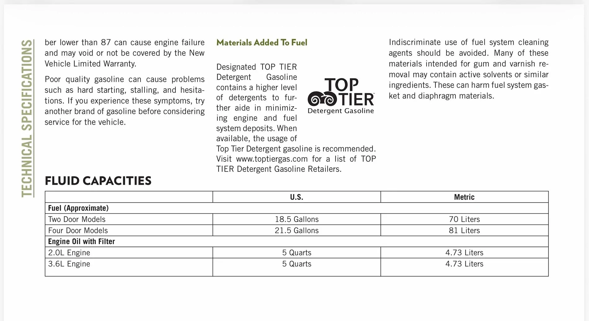

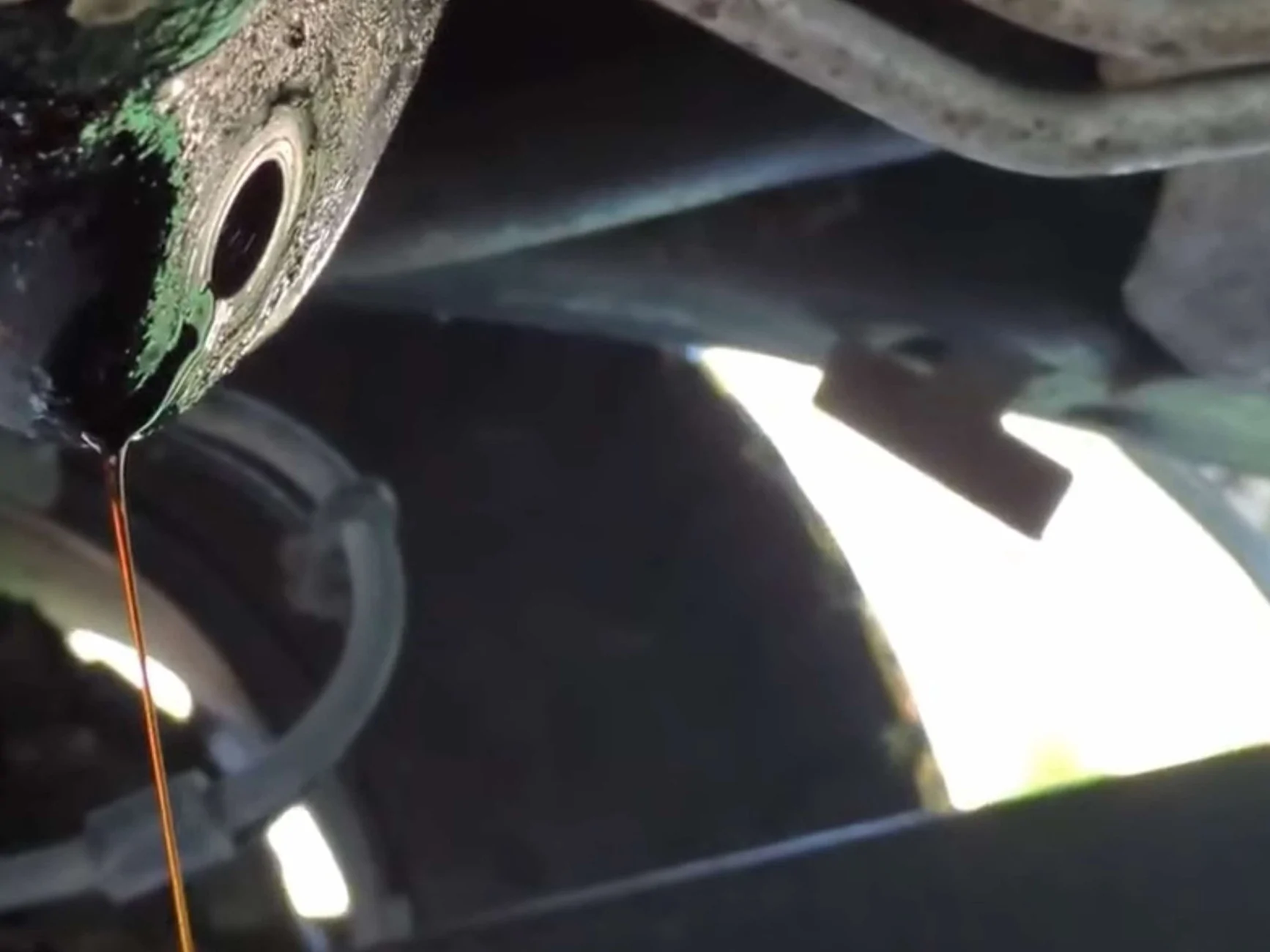

I did my first two free oil changes with the dealer on my ‘25 Rubicon X. Today I changed it myself for the first time and 6 damn quarts came out! The manual clearly states 5 quarts so I called the dealer and the service advisor said “they put what it needs and the VIN lookup says 6 quarts”. She said every VIN is different. I called BS on it and she transferred me to the parts guy as a second validation. He looked up my VIN and said “nope, it definitely takes 5 quarts”. P.S. the oil pan bolt required me using an impact wrench to loosen! Had to be 80-100 ft/lbs! I’ll never take it in for something I can do myself. Unbelievable.
I quit using the "free" oil changes back in 2020 because of this. One time, they had to change it two times after the first and second over fill in the same day!
Exactly 5qts, no more, no less, every time.

JL/JT takes 5 qts. of oil !
From FCA press release when they first introduced the 2nd Gen Pentastar...
"Windage-tray weight was slashed by 19 percent and front-cover weight was cut by 5 percent. *The oil pan was redesigned from a two-piece to a single-piece pan and the sump was reduced from a 6-quart fill to a 5-quart fill *– resulting in an overall 5-pound weight savings compared with the previous generation Pentastar V-6 engine."

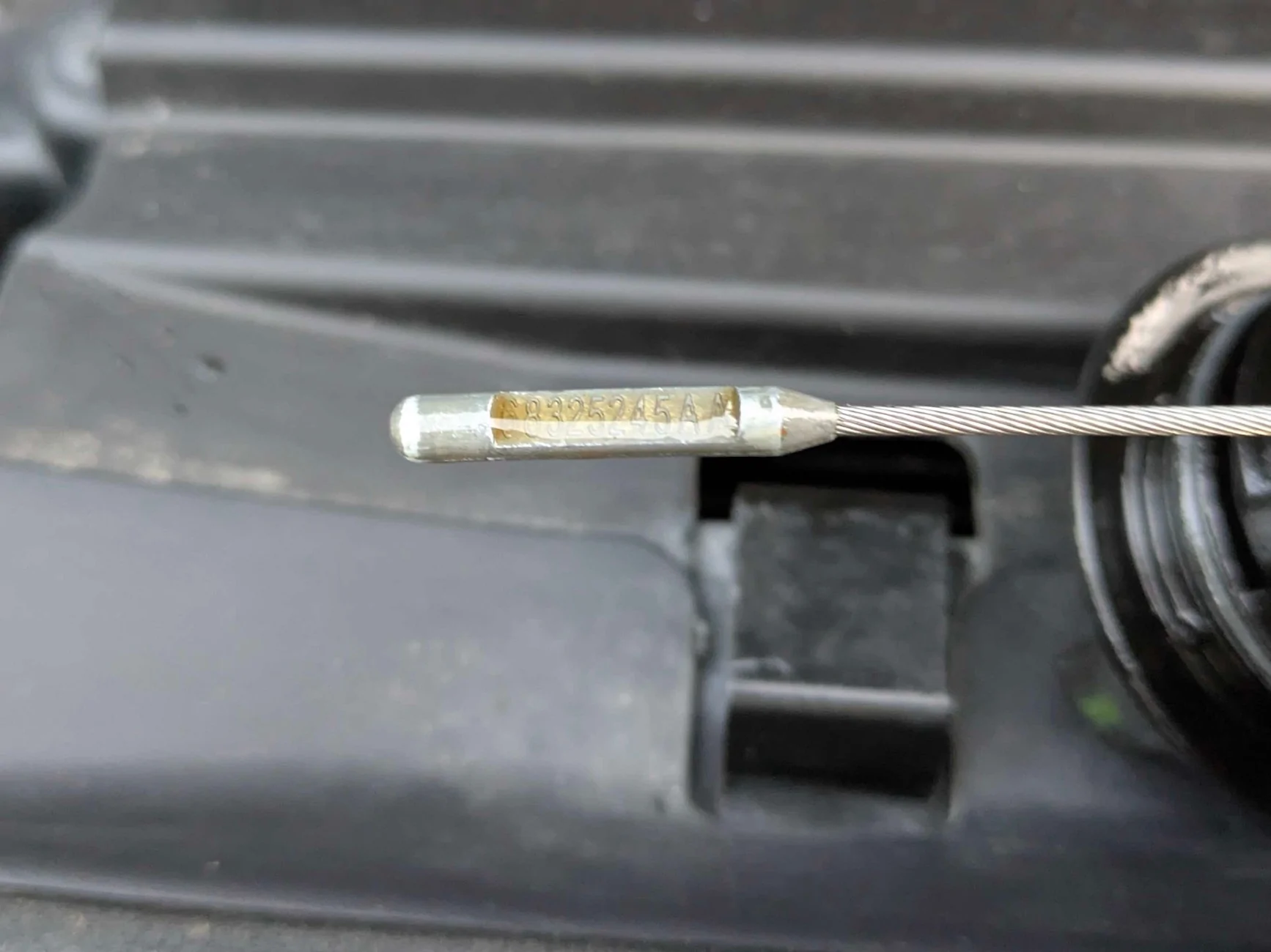

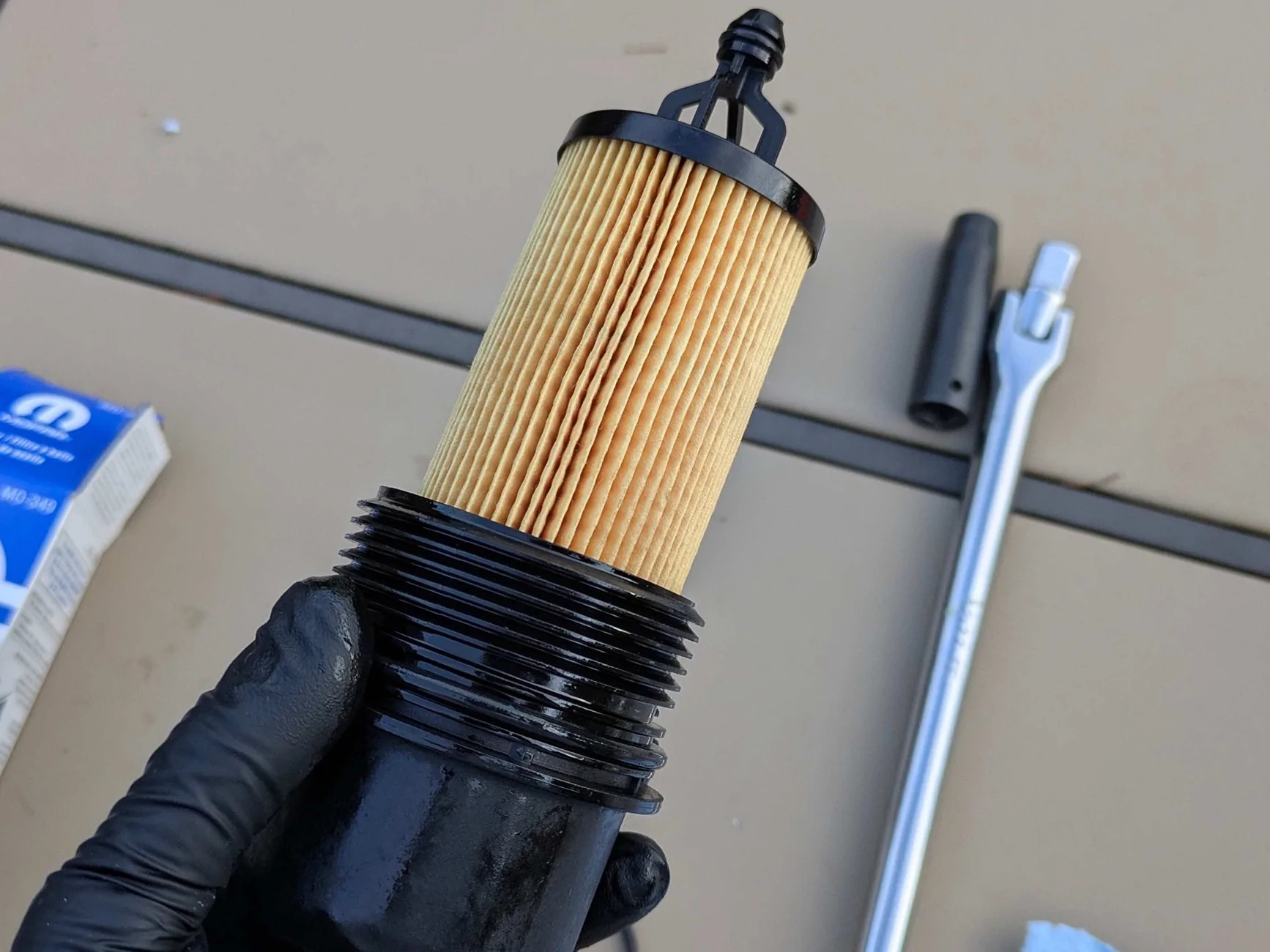

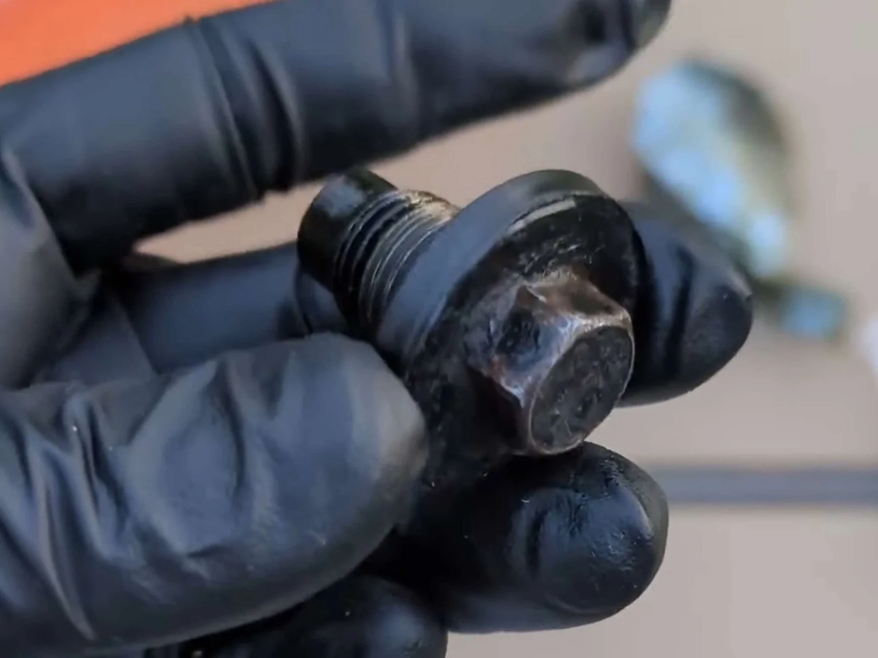

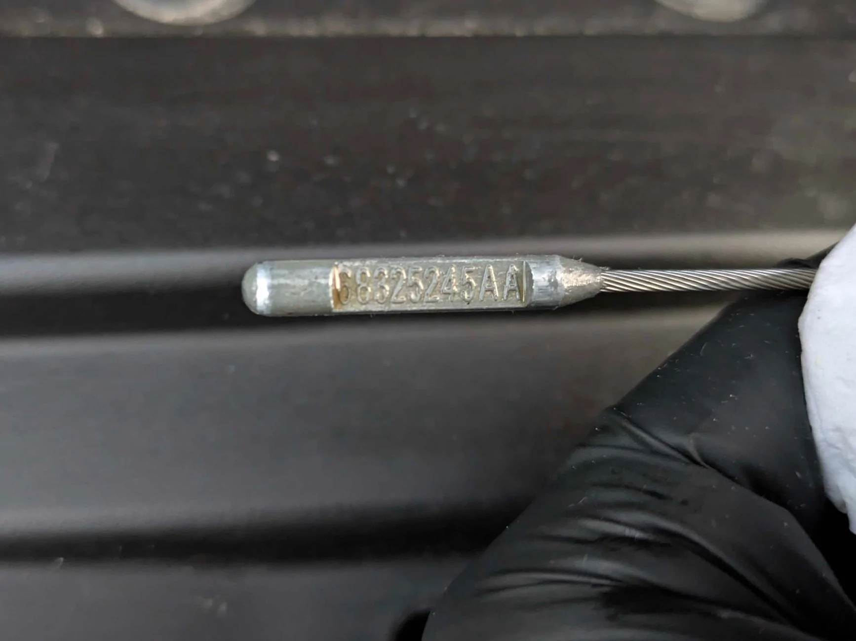

Whenever we re-fill after any oil drain we put in 4qt then check the dipstick reads ok - then another 1/2qt then the remaining 1/2 qt to the max fill line. Any oil over 5qt is definitely not needed. The pics below were from an oil change we just did a couple days ago on our JLUR 3.6L. Am actually surprised how clean this oil was. Granted was driven only over the last winter. Haha!

What I usually tell / relay to new JL/JT owner's is when they do their own oil change the first time that they should add 5 quarts exactly and then let the vehicle sit for say 10 minutes.
I tell them to then, remove the dipstick, wipe it off and then re-insert it.
Then remove the dipstick and with an etching tool, scratch a mark on the dipstick where the oil level is.
Now, whenever they want to see if their oil level is low, they can in the morning before using the JL/
JT, pull the dipstick and see if the oil level is at the etch mark.
I have found this approach is better then trying to read the JL/JT dipstick which is a really difficult one to read for most...

He had already changed the oil and put in a new filter. Drained it again in front of me when I asked about the 6 qts. And then refllled with 5 exactly. When we looked at the dipstick after it had settled a few minutes, it came up a bit short. So when the 5 qts went back in, the filter was the one he had installed with the initial oil change that said six quarts on the invoice. So, it's a new filter.
