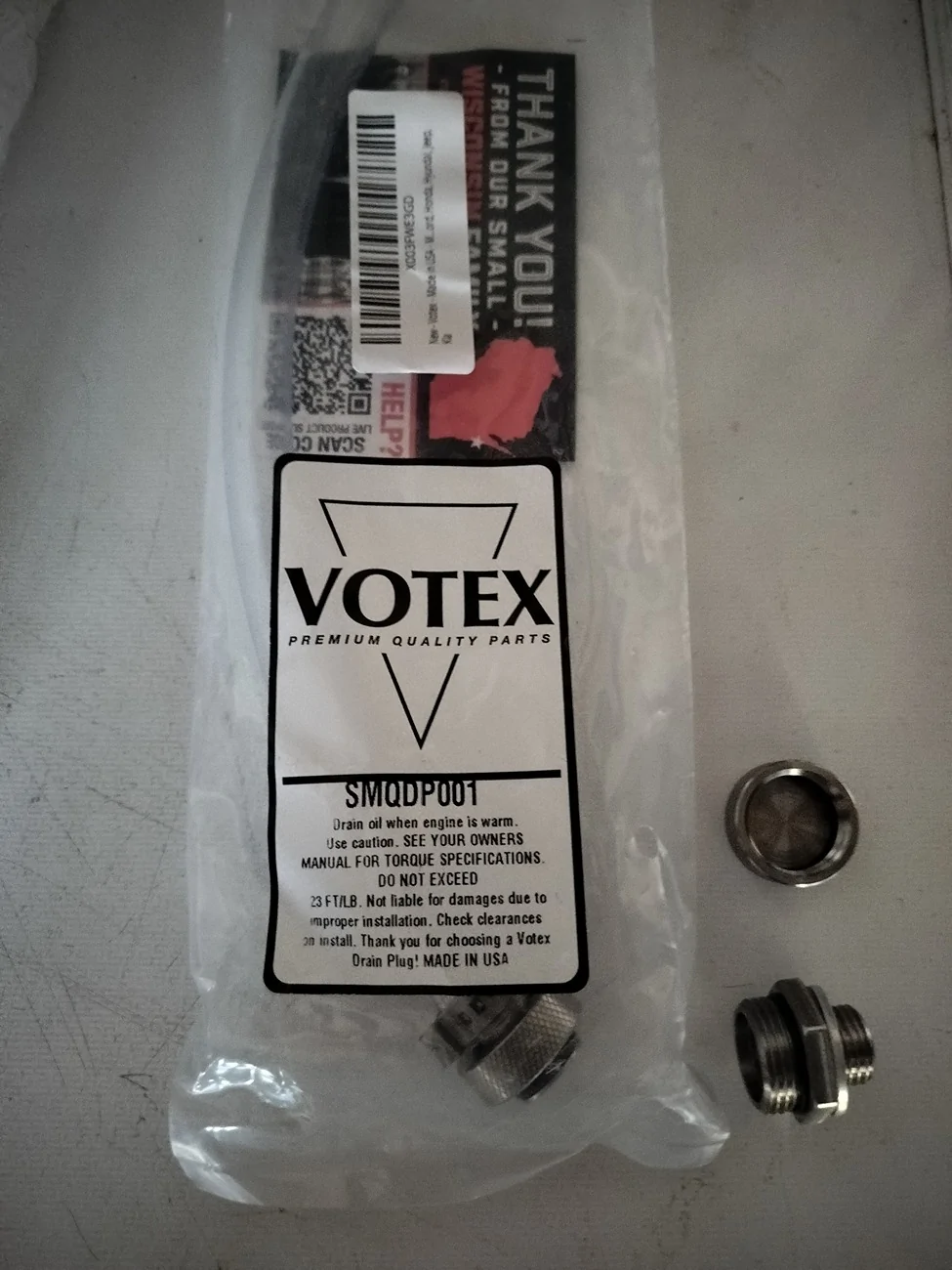

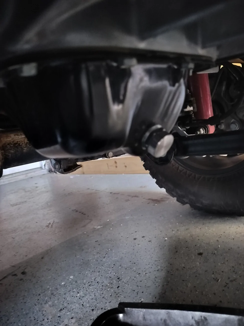

I prefer the Votex. It's American made and I think the smaller size would be less likely to get messed up off road.
