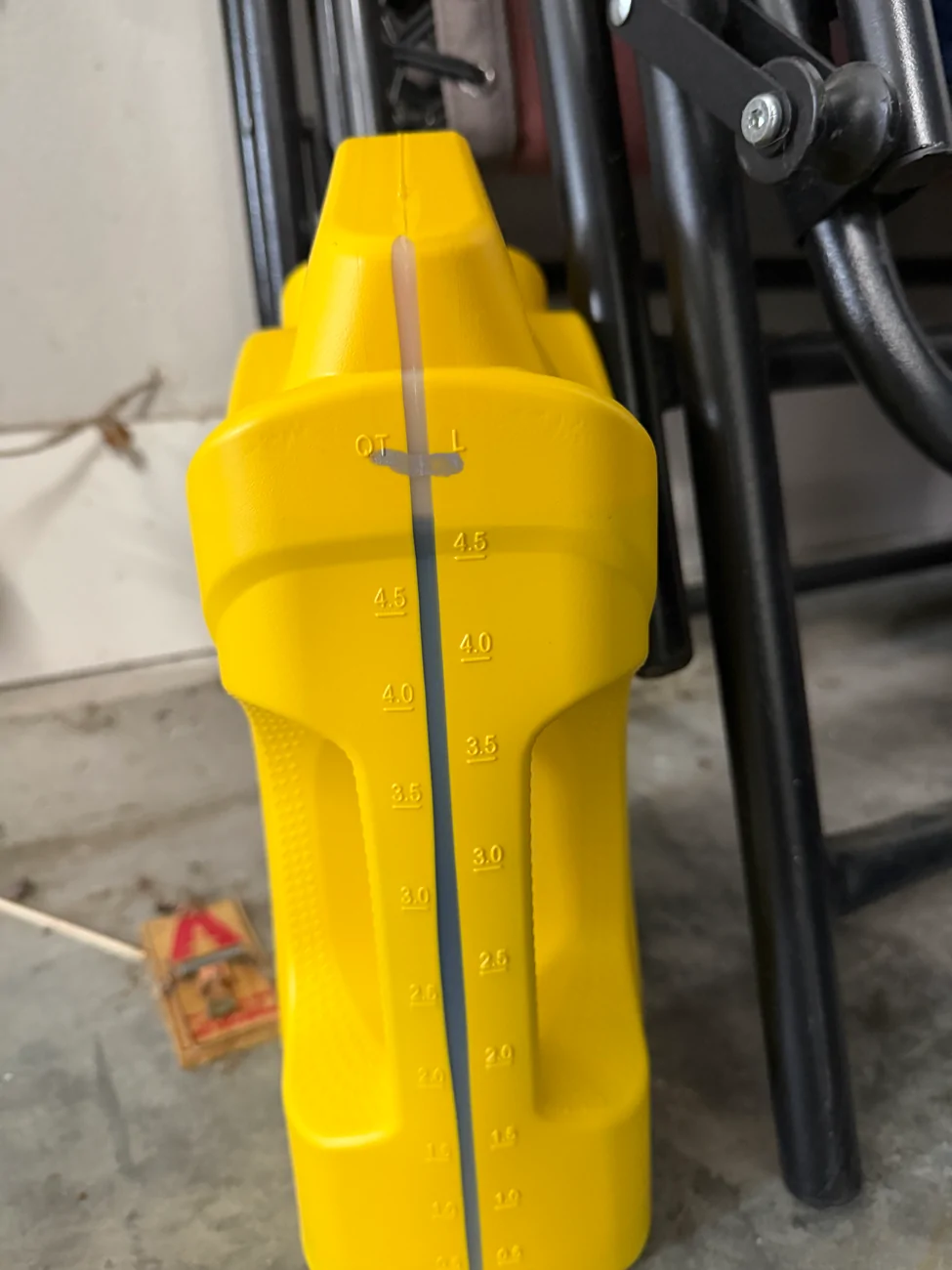

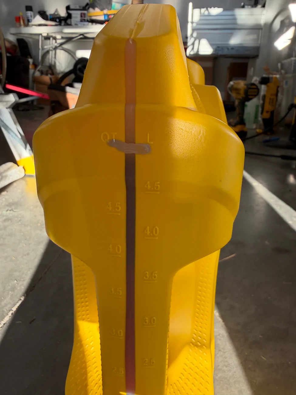

oil in and oil out..I mark every jug before I change so know exactly what comes out...the few ounces in the filter and the residue in the oil drain pan not being accounted for would be pretty much out=in..
